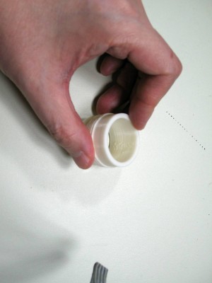

Ok here's the pictures. I think you guys may be right. It's over extruding on the threads.
So this is a print from the same printer. No changes except to the slicer settings. The inside is just as clean as the outside. A little acetone vapor and it would look like it was injection molded.

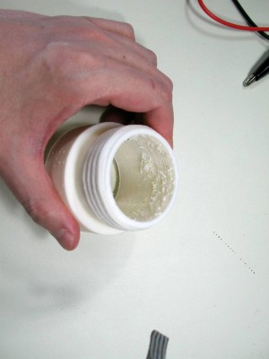

Here's the frustrating parts.
It's gets all blobby on the inside and the threads are blobby. Not only that the printer is doing some sort of circular fill in the wall. It does these little circles inside the walls of the cylinder. I've never seen it do that before. So it makes the wall layers uneven layer wise.

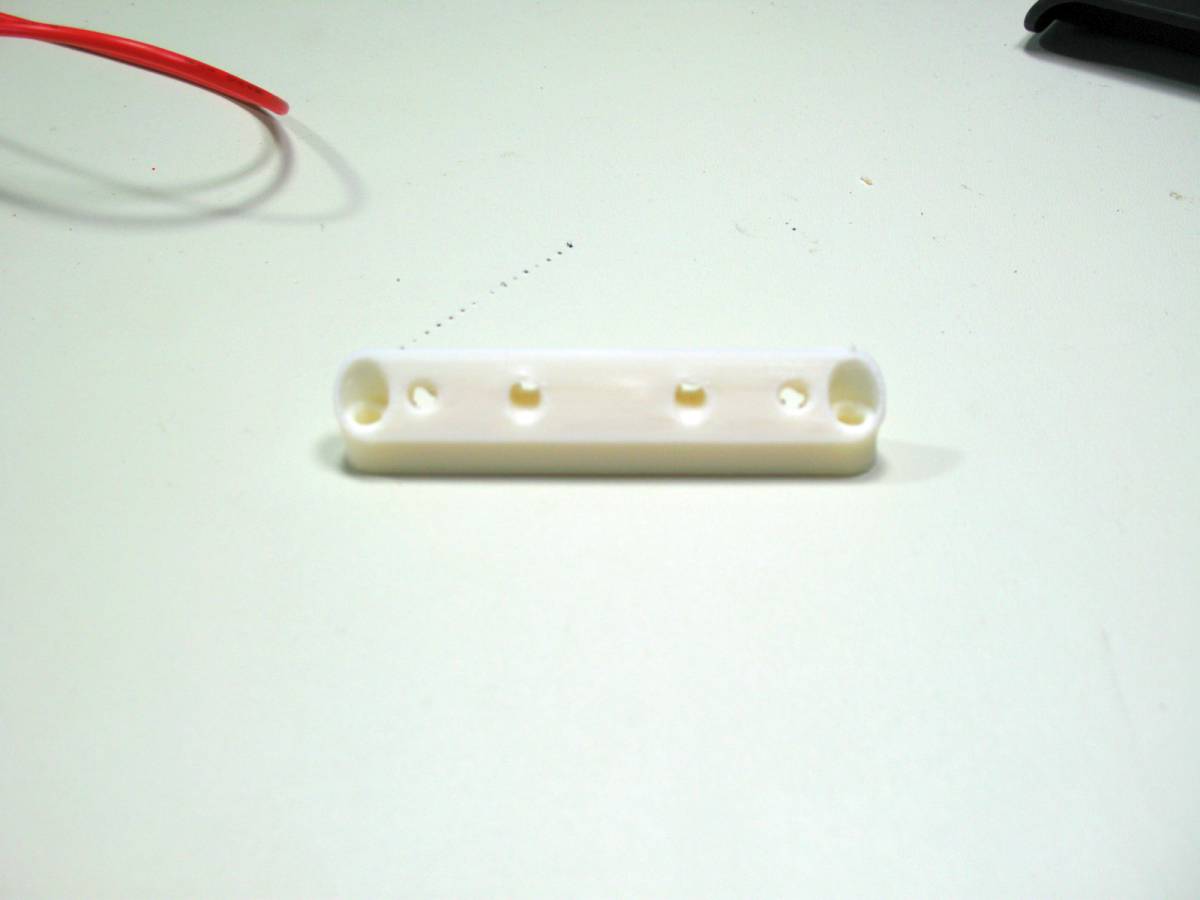

Here are some prints of the Xnaron mag arm parts for comparison. Again no changes to the printer extrusion settings, just the slicer loops, skin width, etc.

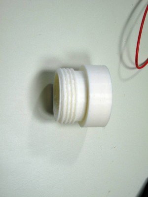

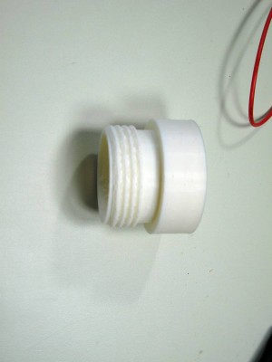

Here are more thread type prints. You can see the size in comparison with my hand. These are a little bigger than the one above so theoretically it should be better or easier. I went from 4 loops to 8 loops to 10 loops and it doesn't seem to help.
Smaller threads just to see what happens and it the threads still come out blobby. These are normal threads.
This is the inside of the previous pic. Just a seam but otherwise no blobbing like the big thread ones.
You would think bigger is less blobbing but no.
So I can't seem to figure out the settings. I will check the extrusion and the size of the filament but it has been very even. The only trouble I have had is with the threads. Everything else comes out great.
