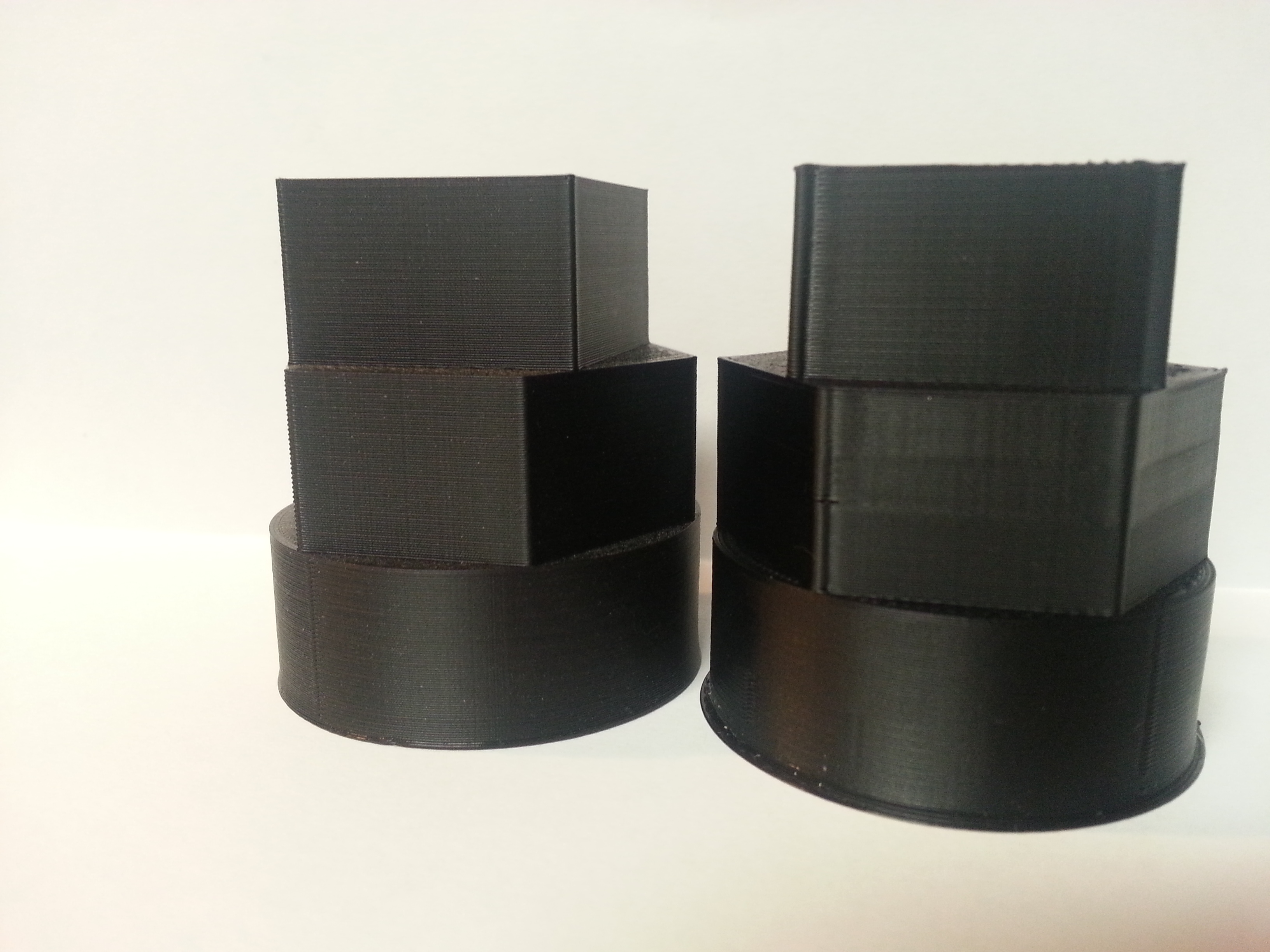

By increasing the resolution, I absolutely have an increase in the visual quality of the printed part.

Makes sense to me.KAS wrote:By increasing the resolution, I absolutely have an increase in the visual quality of the printed part.

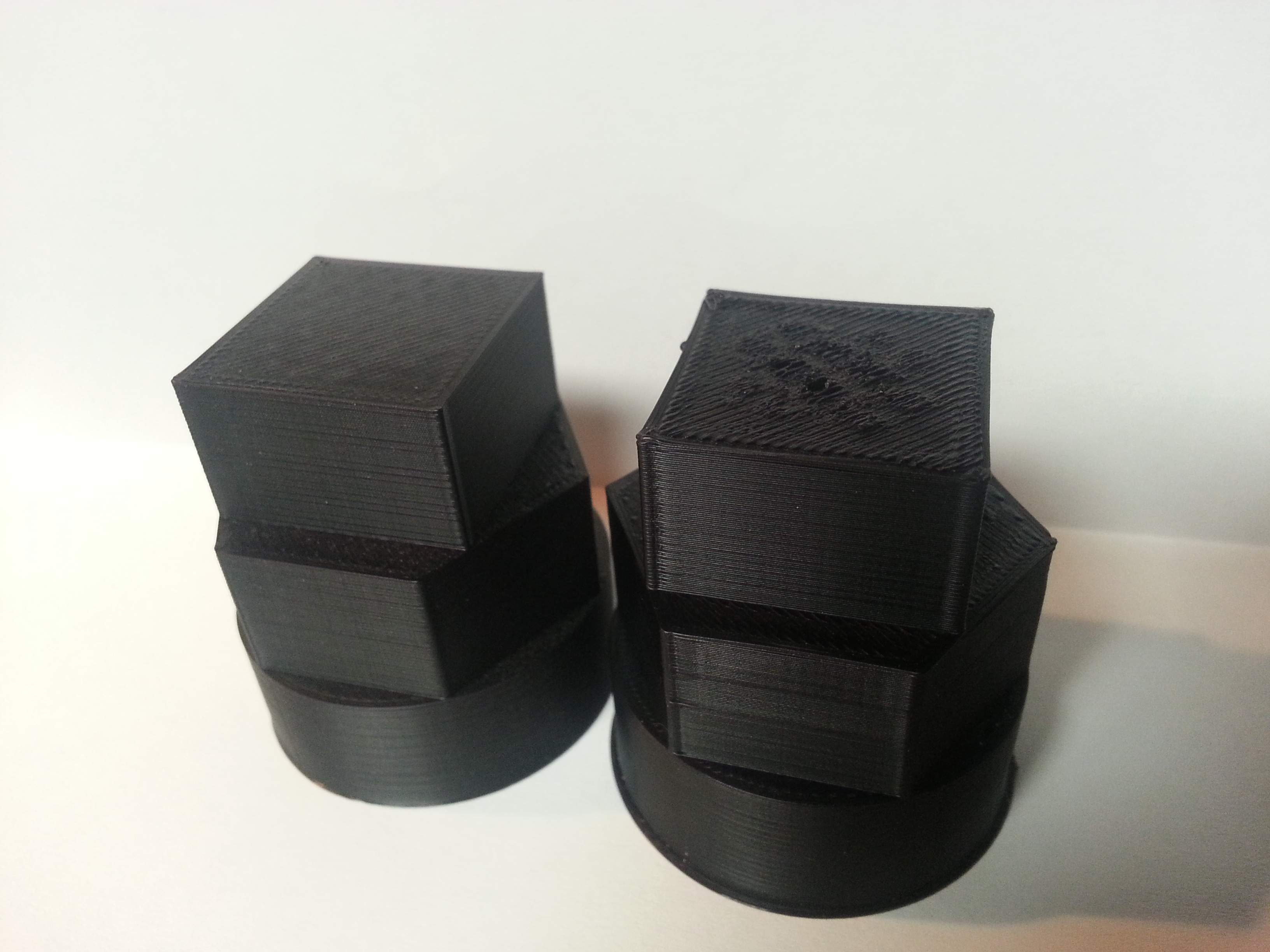

I printed with both the Rambo and Smoothieboard with no noticeable difference. Had concern/mention of possible loss of steps when printing high speeds towards the edge on the Rambo but I didn't observe anything out of the ordinary.
I know this is a broken record:
Before, stock setup: http://forum.seemecnc.com/viewtopic.php ... 150#p67435
After, .9 16t: http://forum.seemecnc.com/viewtopic.php ... 150#p69575
And with a geared extruder running JFettig's adapter plate for the ezstruder: http://forum.seemecnc.com/viewtopic.php ... 001#p76133

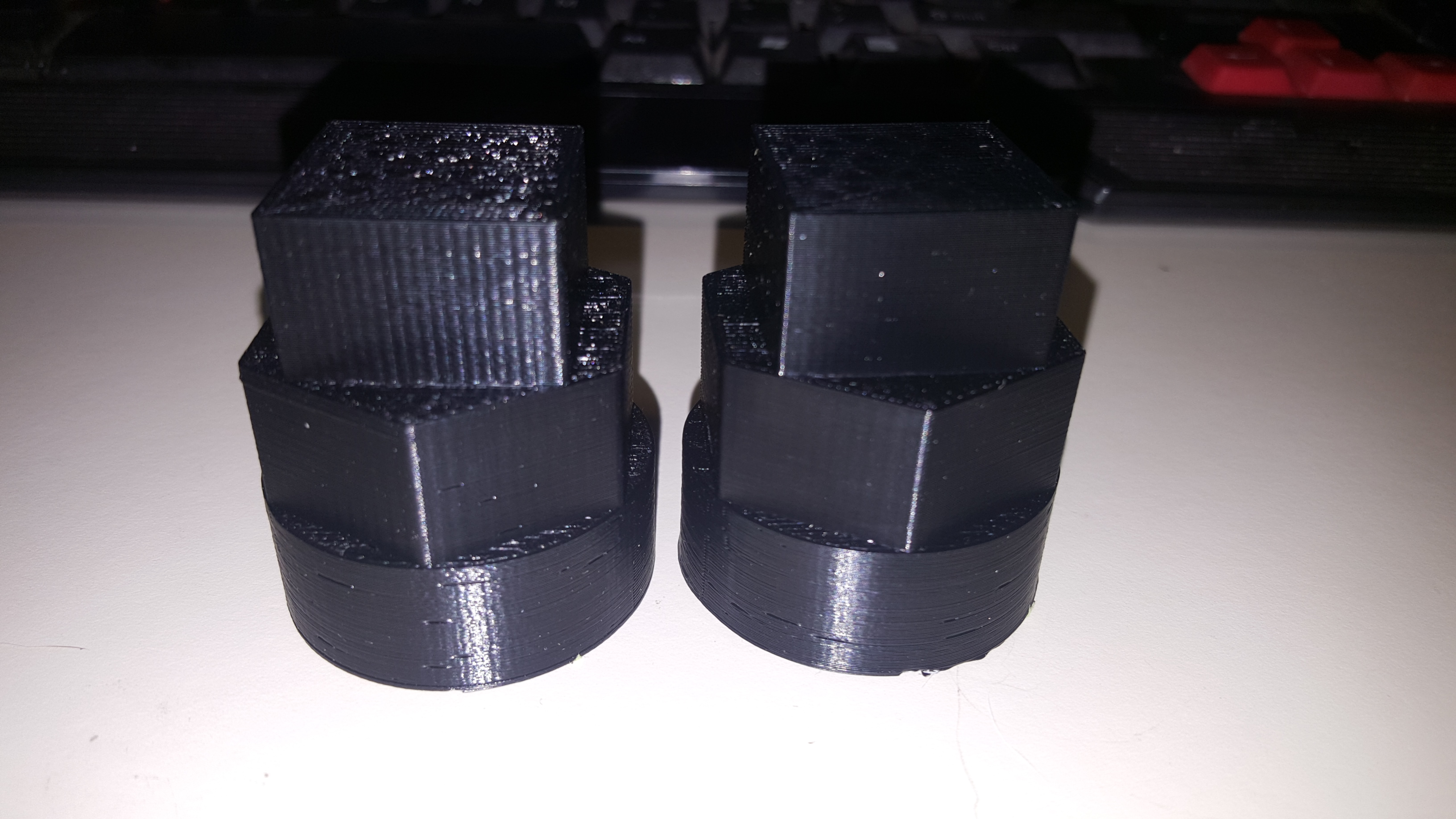

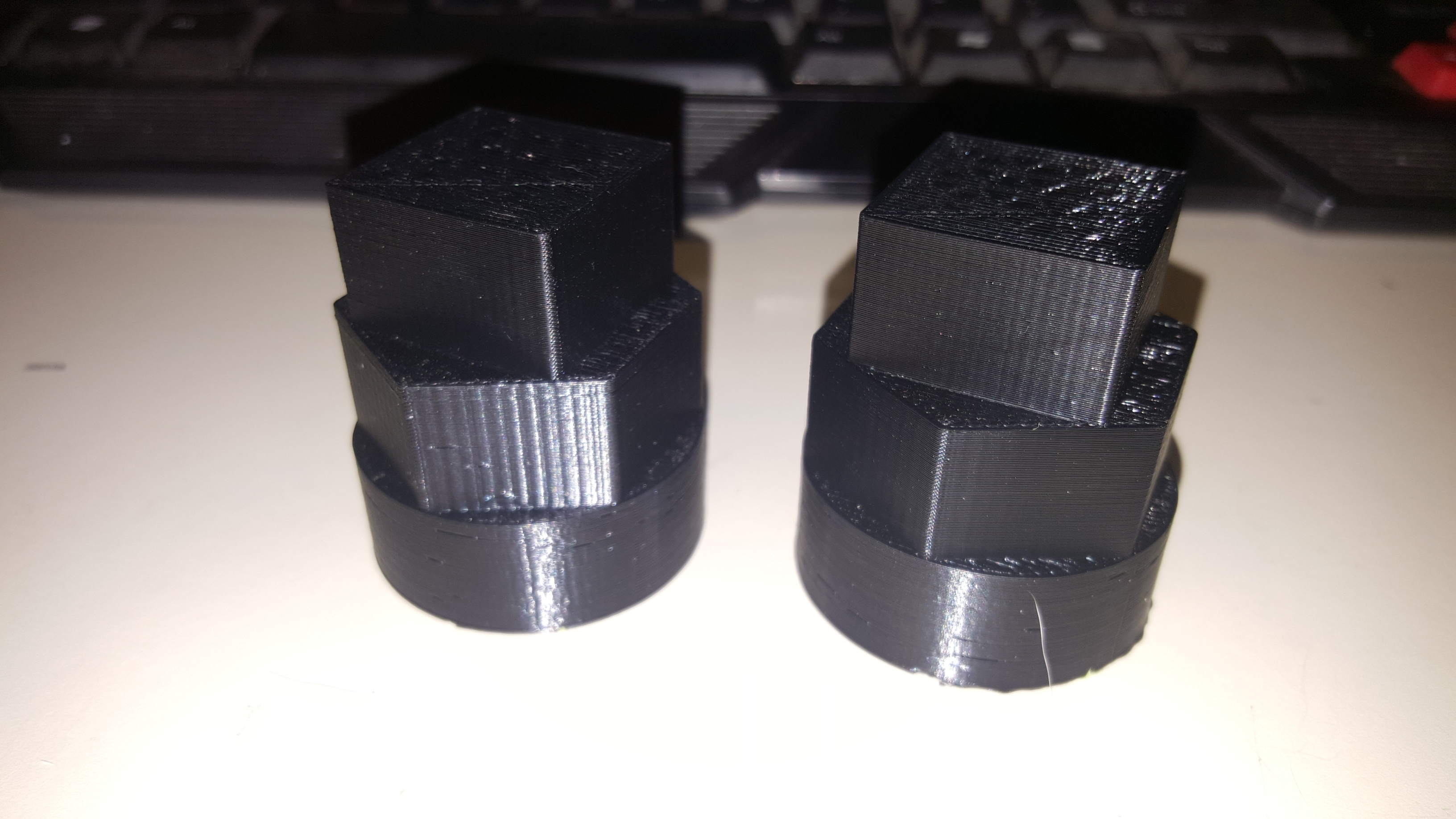

After playing with my Flashforge Creator Pro for the past month or so and being in complete awe of how smooth the outside faces are compared to my Rostock Max (stock stepper/pulley/extruder setup), I had been planning an upgrade to 16T pulleys and a smoothieboard. Now seeing your results with 16T pulleys and 0.9-deg steppers only, I'm rethinking that.KAS wrote:I know this is a broken record:
Looks like I could change to 16T pulleys, 0.9-deg steppers, and finally setup my geared dual extruder setup for less than the Smoothieboard alone. I'll likely also ditch my Astrosyn dampers for cork or no dampers at all to remove as much potential compliance in the system as possible.
