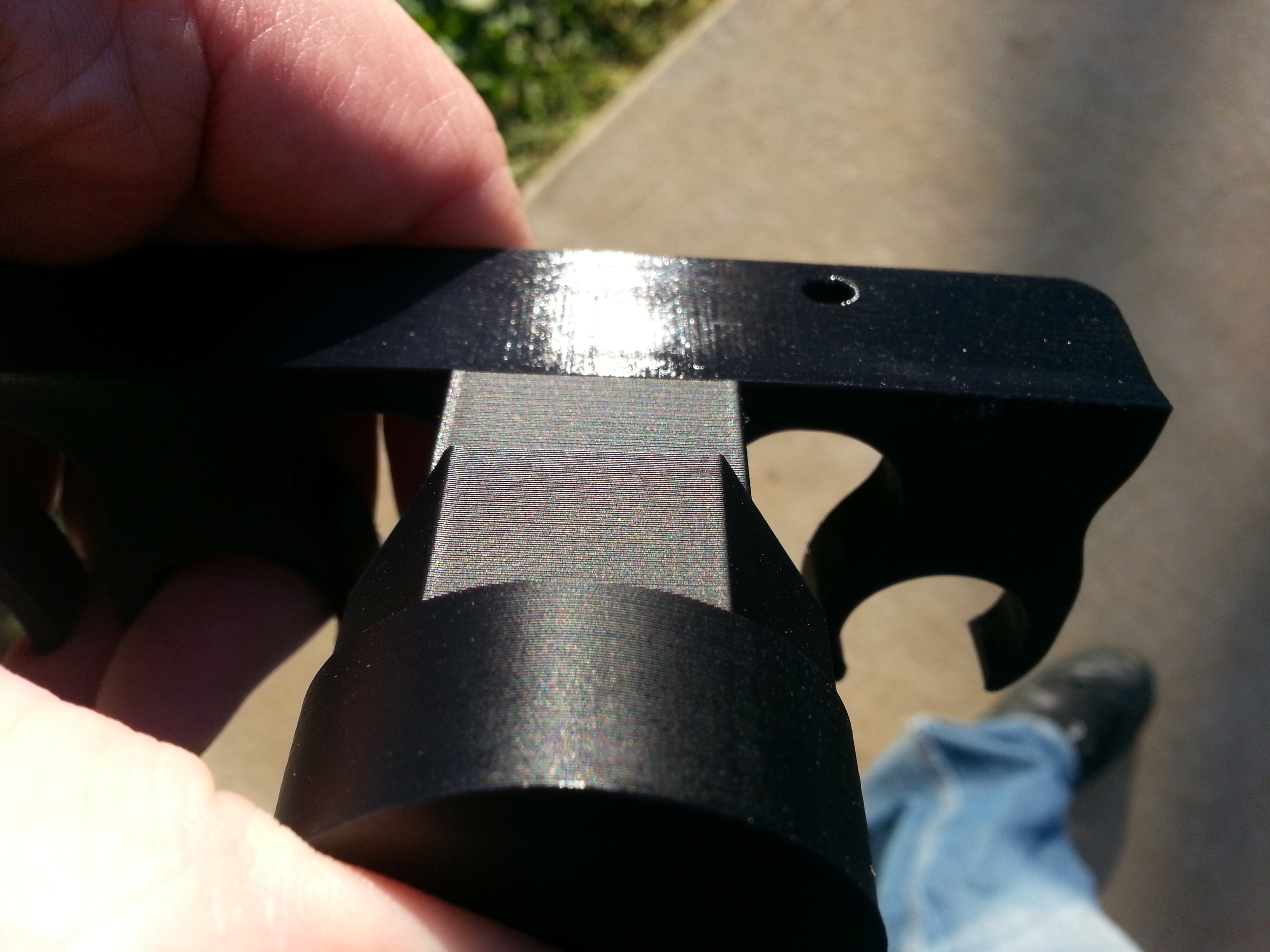

Something I've been messing with ever since installing JFettig's geared stepper adapter. I'm able to print much cooler temps with that matte look. (using a geared stepper)
I'm not sure if other filaments will act the same as this black PLA. This is it's the exact same filament printed at way different temperatures.
http://www.amazon.com/AUGUSTO-1-75mm-3D ... B00TWW16F0
Had to take it outside to get some light..

Yes, PLA will take on a different sheen printed at different temps but I'm talking about a real honest to gosh matte black like the CF filaments look when printed.
