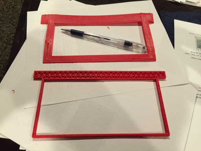

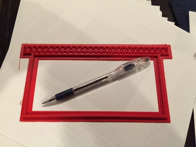

Here's the print:
The first is the print, the second is after I took off the raft/skirt. The machine performed flawlessly up until it was completely shut down!

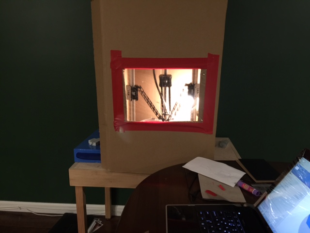

Anyone think maybe this was because I had it completely enclosed in a box?

Power supply shut off, likely due to heat. I had that problem when printing large ABS prints. Can you mod the heat box to attach at the top of the base, or add some panels to isolate the lower part of the box? Get airflow around the base and try removing one or both wooden side plates to see if it makes a difference. I ended up making new side plates with grilles and a fan on one of them.

Ah... good idea. I remember seeing a post about a year ago that showed off some guy's new box for his V2...the bottom of it was at the height of the "top" of the base "station".
I'll do that. I suspected it was a heat thing, straight away.
