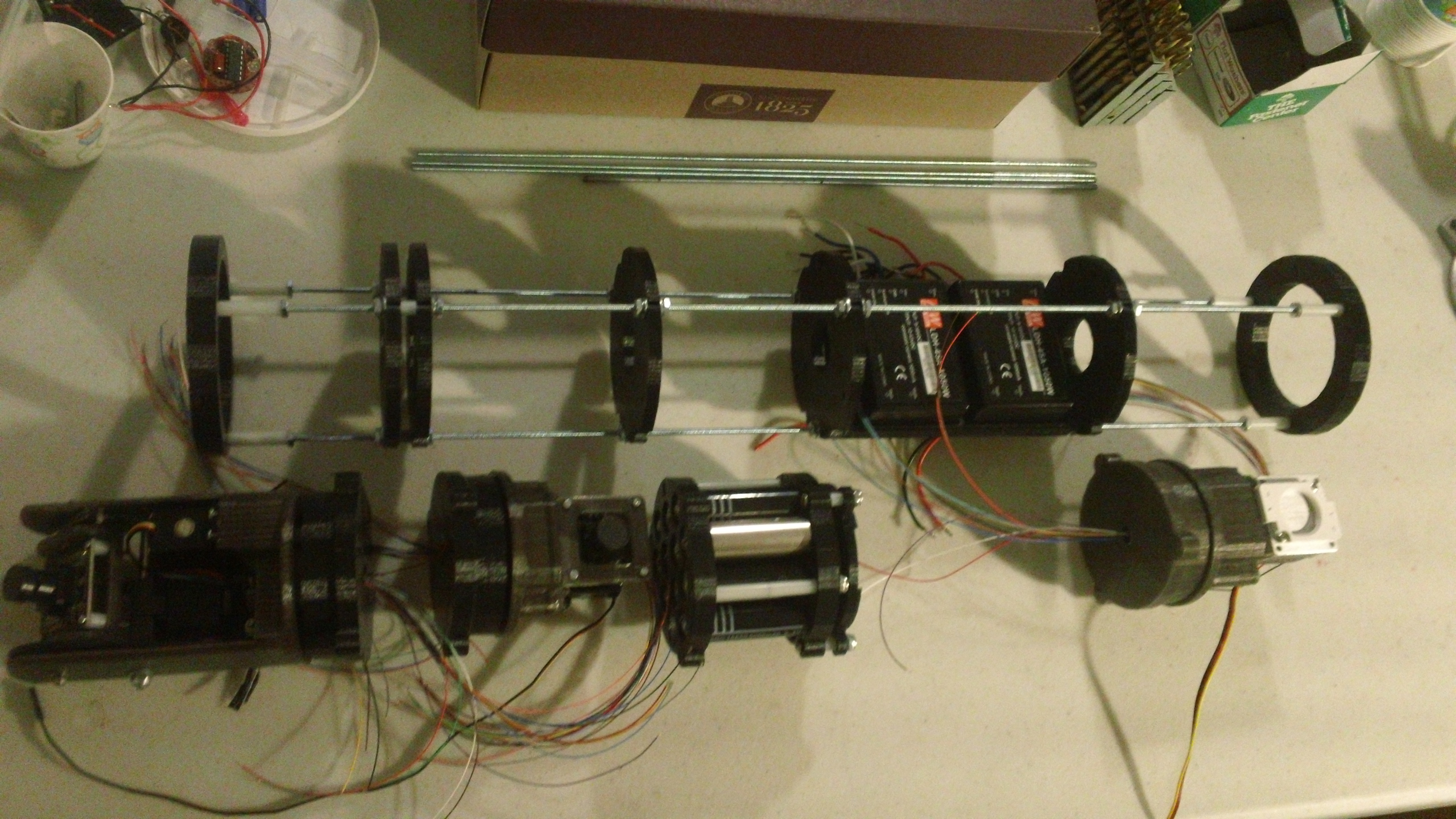

Pan and Tilt camera platform update
Posted: Sun Oct 25, 2015 3:31 pm
by Tinker12
got to love these 3d printers!
printed two more servo pan units for LED light and a video camera placed in acrylic housing also decided to make a rotor vane type water current meter, worked out great, printed at 70 % infill will with black t-glase
will use a coating to water seal. http://www.smooth-on.com/index.php?cPat ... baj3pter00.
Current sensor uses magnetic bearing for very low friction, just used ring magnets similar poles facing each other on top and bottom with a pin thru center.
Have lengthed housing tube from picture to accomodate all stuff it is now 24 inches long 4.5 inches diameter.
orion printer works like a champ. Had slight problem with center pin for servo units not being perfectly true along the center axis, a little tilt, i.e. tilted as it is printed upwards from base, does anybody know what causes this?

the drop camera has two ntsc video cameras at this point. one is mounted on a pan tilt platfom facing downward with fixed lighting, the other camera is facing out of the tube housing horizontally and pans only, the led light is mounted on a similar pan platfom about 12 to 14 inches above the pan camera, it pans in sync with the video camera. both led light and camera have continuous pan capabilty with an position feedback sensor on both so they can sync movement. the led light is a cree model and can output up to approx 3600 lumens. I want to minimize backscatter into the camera thus the reason for placeing the camera an light as far apart as possible.

here is updated dropcam design with recently 3d printed parts. have be using t-glase and recently esun petg for material with very good results.
have printed parts with upto 90% infill (top and bottom rings on rail mount) for very strong parts. Things i would use to make out of HDPE sheet
now i just print, much easier to let the printer do the work!
