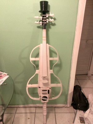

Just felt like I should put my 2 cents in about what can be achieved with the accuracy and size of our particular delta machines.briankb wrote:I know I'm gonna get beat for this -- but I do not see using a delta configuration for high tolerance work.
I just finished my 2nd iteration of my cello today. This one is electric, includes a small class D amplifier and a speaker with a pre-amped, piezo-electric pickup.
Sounds pretty good in my opinion! I'll probably make a more comprehensive post about it in the "What are YOU making?" forum later.

That is amazing! Obviously, I just haven't found my groove with a delta yet.

Beautiful work.
And you demonstrate an important point: how accurate is accurate? How precise is precise?
A peg in a hole for an instrument string needs to be accurate to within about 0.2mm if tapered, maybe 0.1mm if it's straight through. The plastic deforms a little to take up the slack and so on. Inserting a sliding fit metal piston or dowel in a metal block needs something closer to 0.02mm to be right.
Horses for courses, and for an awful lot of courses (just like cast metal in my earlier analogy) the 3d printer horse is just fine.
But I agree with Generic Default - I don't think the additive manufacturing techniques we use now are ever going to be refined to the point where they are as accurate as good quality subtractive equipment.
