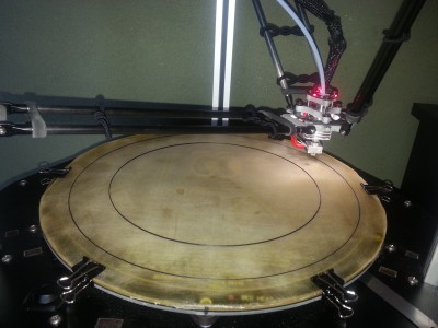

KAS,
Everything fails. I cannot get anything to consistently repeat or work at all. I am really tempted to sledgehammer this entire thing. At this point, it has been the worst investment I have ever made. I have had this thing for ~38 days now, in which I have spent about 20 days of actively working on it.
Initially, I had all kinds of issues with the bowden tube and failed prints, due to the fact that the tube continued to come out of the hot-end. It would occur at random times and destroy a print without warning. After multiple discussions with various people, I spent another $80 with Eric @ DTA and he sent me a new collet that holds the bowden tube in place. Come to find out, I had a faulty part out of the box.
After replacing that part, I felt like I was back at ground zero. Yet, deja vu is kicking in again. I am having complete random failures. This time though, I don't have an obvious fault (like a tube popping out) to point the problem at. Lets see if this summarizes it:
- I can print a cube perfectly.
- I cannot print a cube at all, as the base layer won't stick.
- I can print a cube, and it has warped corners on the rear (Z axis).
- I can print a cube, and it has no warped Z corner, but a warped X corner.
- I can print a cube, have it fail 1/2 way through and throw spaghetti everywhere (imagine the nozzle not touching anything, just spewing out filament).
- I can print a cube, in the middle of the print, the cube pops off MID-LAYER.
- I can print a cube, in the middle of the print, the cube pops off at the bed adhesion.
- I can print a cube, after the print, I cannot remove the part unless I put the glass in the freezer
Each of these things above can occur if I were to attempt to print 10 times, without changing a single setting in Matter Control. No exaggeration.
On a personal note, I am getting emotionally vested here. I am ill. Very ill (terminal). I take a lot of meds and I am losing the ability to have patience here. I have a lot of money invested in this (not just the 3D printer, but a lot of things after this as well that I have wanted to do from a bucket list perspective; I wanted to do some lost-pla casting and metal pouring.); I have purchased a kiln, vacuum pump and equipment, home foundry, etc. etc. etc. I am just at the point of being ready to give up, which is the worst thing I can possibly do.
I am just at a complete loss.
Hell.. I just tried to print another cube, and it failed out of the gate this time:
[img]https://farm6.staticflickr.com/5777/217 ... a30c_b.jpg[/img]
I have never seen it do that. I did make two changes though: lowered the bed temperature (to 62c), and lowered the nozzle temperature (to 190c). I did this because I was so far outside of the boundaries in the previous settings, causing other issues (previously I have had the bed temp at 73c, and 210c nozzle). The issues I had there were cobwebs like none other (stringing), ruining a part that FINALLY printed (lower jaw of the TREX - got to the teeth and with all of the cobwebs, it basically became a solid between all of the teeth and inbetween the left/right of the jaw!).

Re: Anyone with a Prometheus head please check in!
Just looking at the failed cube print, I can tell that the problem isn't the hot end, your z zero point is too high!
Print some PLA at about 190C with a 55C bed. Print at 30mm/sec. Use glue stick on the bed.
Reset your z zero point first.
I did the Z calibration height again. To your point, it dropped another .06mm from the last time I did it. Now, at 00.00, there is a VERY SMALL motor hum sound where there is pressure being pushed against the paper contently. The thing I don't understand, is I did the exact same process last time (motor hum, scratches in the paper, etc.) - and it still dropped further when I did it this next time.
[img]https://farm1.staticflickr.com/697/2134 ... 3f7c_b.jpg[/img]
Almost looks like nothing is coming out. I'm wonder if the double nut after the block is cooling it off.
Can you extrude filament in the air?
Yes - I can.KAS wrote:Almost looks like nothing is coming out. I'm wonder if the double nut after the block is cooling it off.
I just tried again, and it failed again with that same issue.
[youtube]http://www.youtube.com/watch?v=EghYZ2heUMs[/youtube]
In comparison to manually feeding it:
[youtube]http://www.youtube.com/watch?v=a3VxiiUZIZY[/youtube]
hmm, crank that heat another 20c. See if that does anything different.
When it's printing does the nozzle temp drop at all?
Also, by chance is that SeeMeCNC midnight black PLA? I've had nothing but trouble with it. Just curious.
no bueno!
Temp was up to 205c now.
[img]https://farm6.staticflickr.com/5781/217 ... c55b_b.jpg[/img]
[youtube]http://www.youtube.com/watch?v=sK-0WTcX1x0[/youtube]
Blah!
Blah!
Surgery is done...
I didn't snap a pic of it not-installed, but it looks identical to the one KAS has on his thread. Here it is installed:
Notice the 2.00 mm Gap:
[img]https://farm1.staticflickr.com/771/2178 ... 3098_b.jpg[/img]
And the 3rd nut:
[img]https://farm1.staticflickr.com/702/2197 ... 2573_b.jpg[/img]
Ok.. it is warming up. I also set the retractions to 3.5mm. I am trying the same PLA.. I have another spool that I will try if this fails. I need to do a quick Z-Cal height, then off I go.
And the 3rd nut:
Ok...
Fixed now. Both legs have been officially broke and repaired!
Record time of reinstalling everything.
Just did a new Z-Height calibration and doing a new PID Autotune.
Next comes the moment of truth..
(BTW: This is one of the reasons for my grumpiness - not an excuse - just contributes):
[img]https://farm1.staticflickr.com/595/2178 ... 80e8_b.jpg[/img]
Hopefully things will be on the getting better mode now..
Nope.
[img]https://farm6.staticflickr.com/5767/217 ... 6d71_b.jpg[/img]
[youtube]http://www.youtube.com/watch?v=Ozy899vhPNc[/youtube]
Ok..
Now I am changing filament from the SeeMeCNC to the local Microcenter brand stuff, and going to give that a try.
Thanks,
Mike
Ok..
Thanks,
Mike
