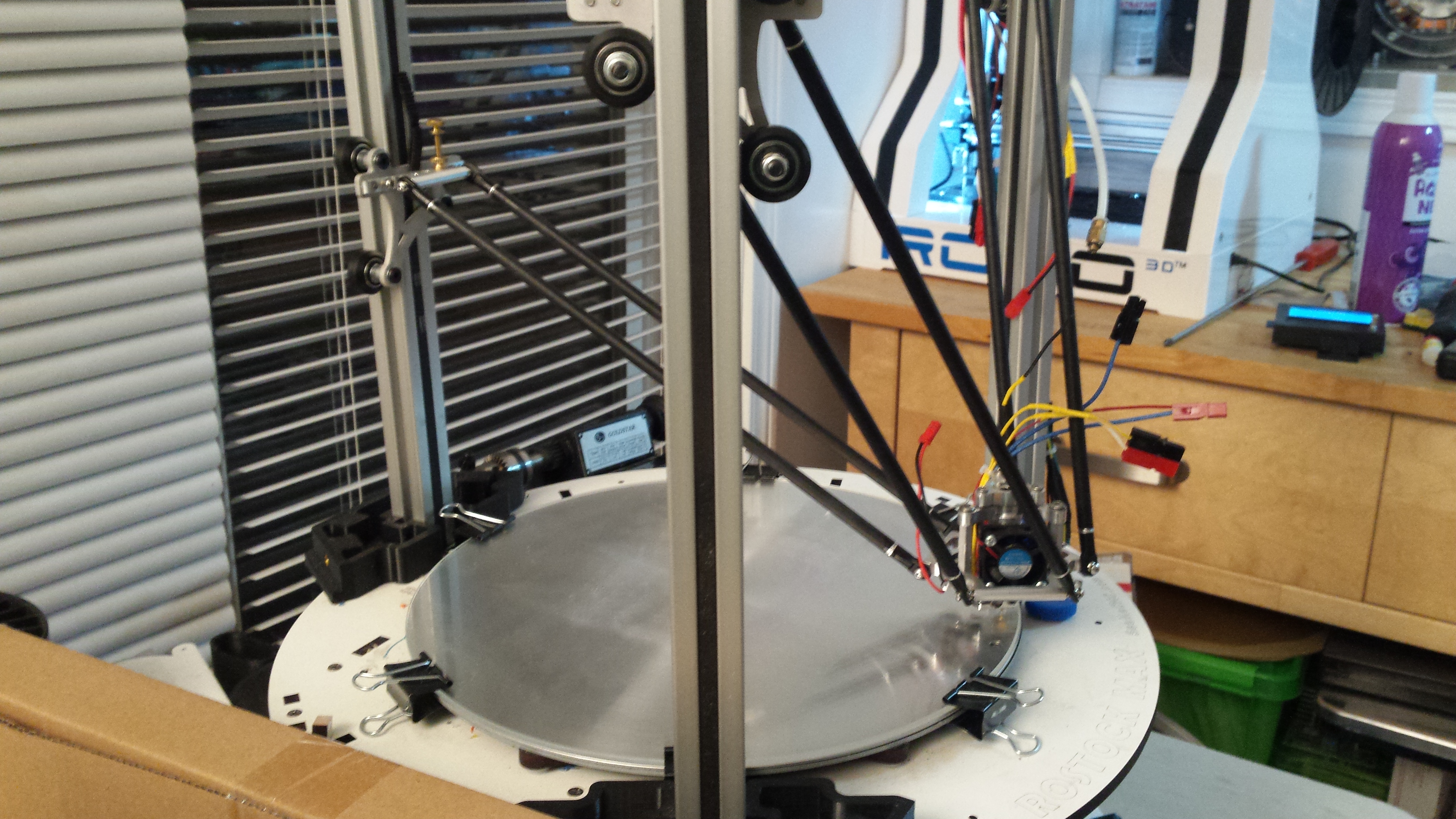

stonewater
- Posts: 345
Re: longer CF arms
here is what 325 mm arms look like on the rostock

stonewater wrote:here is what 325 mm arms look like on the rostock
What are you using to mount the arms to the trick trucks? They don't look like the stock mounts. Nice work btw

stonewater
- Posts: 345
Re: longer CF arms
@TFmike,
the metal effector came with mount for the trick trucks. so they are from Brian.
@eaglezsoar
I was reading thru a few threads, particularly the one where we were discussing longer arms. JFettig had mentioned he would take 300 or 325 mm arms , the longer the better. as I understood his reasoning, the lower one of the towers carriage gets to horizontal the slower it has to move, and the less precise as the effector moves thru the spot directly opposite the tower, with the arms horizontal, there is a point where it cannot draw an arc. I wanted to be able to use the full diameter of the bed without having to slow the print down. I can print a full diameter perimeter circle .6mm wide at speeds above 50.... I could not do the full diameter OR anything close at speeds above 25... I don't make things very tall, I am more concerned with build diameter.
Tom C
