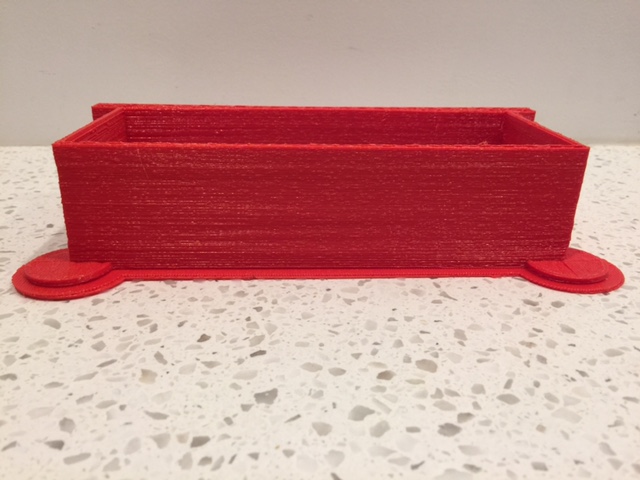

Mouse Ears worked great! Big print--my best results so far
Happy with results.
The walls and edges are a bit wobbly--is that because I had the "refinement" (Fusion 360) set on "medium"?

0.5mm layer height is really high unless you have a large diameter nozzle. What size is your nozzle?
If you are using the stock 0.5mm nozzle, I would suggest a layer thickness between 0.2mm and 0.35mm. The general rule of thumb is max layer height = 0.8 * nozzle diameter.
Lower layer height will increase the "squish" between layers which should improve layer to layer bonding.

Yes, stock .5mm nozzle.
Is that 80% of the nozzle diameter?

PS- I'm not concerned (too much) with aesthetics. The wobbly walls aren't too big a deal--I'm more concerned with design, functionality, etc., of what the end use will be. Of course, along the way I'd like to dial in the finer aspects of 3D printing, so I DO thank you for suggestions and time spent writing out your opinions!

Yes, 80% of nozzle diameter is the community standard for max layer height.
It isn't all about cosmetics either. It makes a stronger and more dimensionally accurate part.

0.3mm first layer
0.5mm Nozzle Settings.
-0.3mm for layers for a course setting
-0.20-0.25mm for standard settings
-0.15-0.17mm for fine
-0.11-0.14 for very fine
-0.09-0.10mm - Good Luck.

Also, you can go thinner with the mouse ears. Diameter is fine, but the thickness looks about 2x thicker than it needs to be.
						Re: Mouse Ears worked great! Big print--my best results so f
Okay.
They're 3mm.
I suspect I don't need the raft, as well...
							They're 3mm.

Not for what you are printing.
