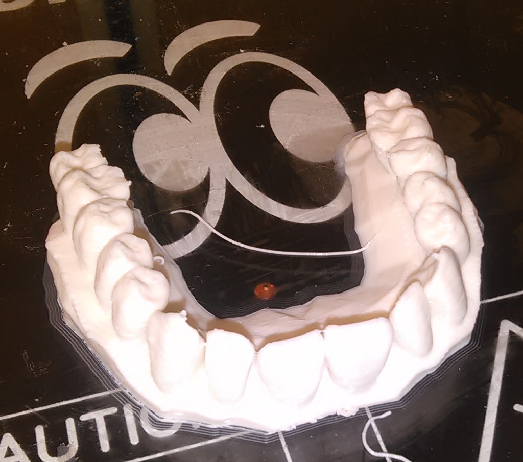

Full size upper set of human teeth with Polymax, 50% infill, 0.2mm layer, print time less than 1 hour.

From the title i thought this was going to be a post about replacing the top belt idler with something like 30 tooth gears, was very surprised to see teeth, they came out nice btw xD

Makes me wonder if a full set of dentures can be 3d printed and carved to fit the human mouth, interesting!

They already use sinter based printers to make molds and models for permanent replacements. I don't think you can use an extrusion based printer to make food safe products. Crap is going to grow in the voids.

Not to mention strength issues - there are some incredible forces generated on the teeth which I suspect would destroy any kind of filament we print with in days or less.

3D systems and Stratsys have a line of dental 3D printers. They are mainly for making molds from dental scans. The pipeline is still being worked out but the dental labs are going to shrink. The print was mainly a test of PolyMax, not intended for final use although it would be just fine for costume teeth. It was inspired after reading about this Chinese FFM SLA viscous material printer being able to 3D print porcelain, very fast, hundreds of times faster than FDM.

Did you intentionally place the teeth under the eyes, or is that a coincidence?
