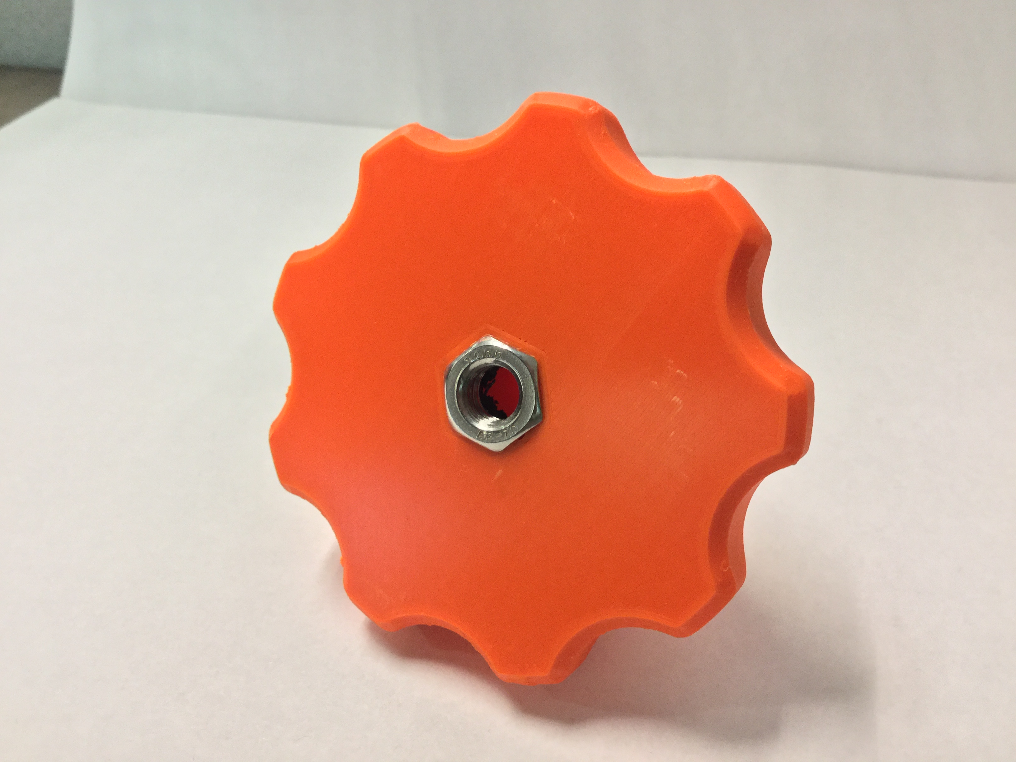

So if you haven't seen this Spool Holder design, take a look. Rick did an awesome job!
http://www.thingiverse.com/thing:1060029
http://repables.com/r/623/
So far I've only printed the knob. This is by far the smoothest finished part I've printed. It came out great. I may reprint with a higher infill and more retract to smooth out the seam. I also need to slow the speed and lower the temperature on the top (Didn't come out perfect).
The Nylon lock nut fit perfect, just snug enough to hold it in and require some force to be pulled out. I think when I get I get it assembled, I'll glue it in.
Some of the settings I used.
Prometheus V2 Hotend 0.4mm Nozzle
2.30mm Retract 30mm/s
5.00mm Wipe
0.15mm First layer
0.10mm Layers
3 Shells
25% infill
35mm/s
100C Bed
237C Nozzle
This was also my first print on PEI, stuff is amazing!

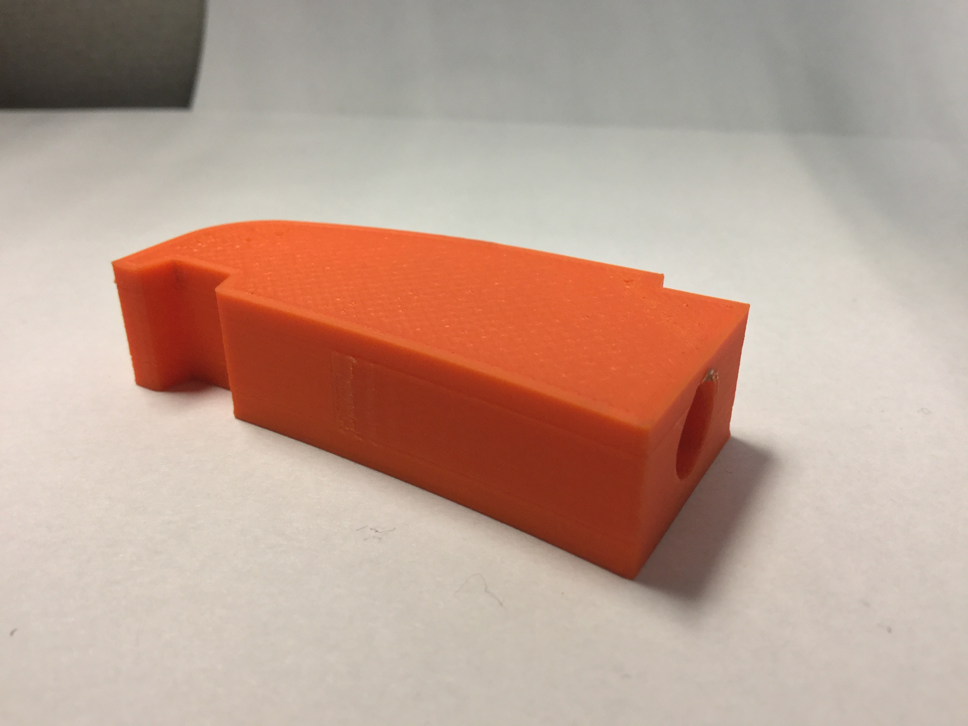

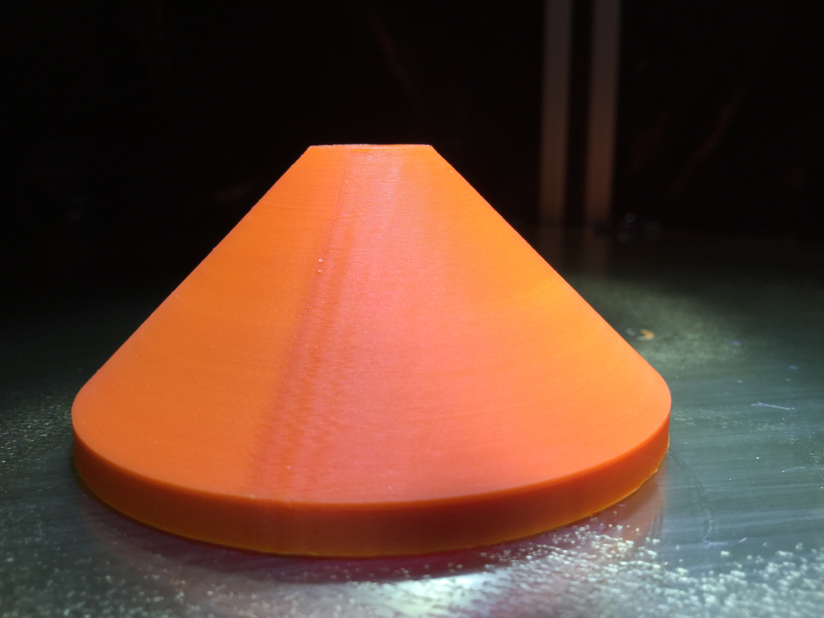

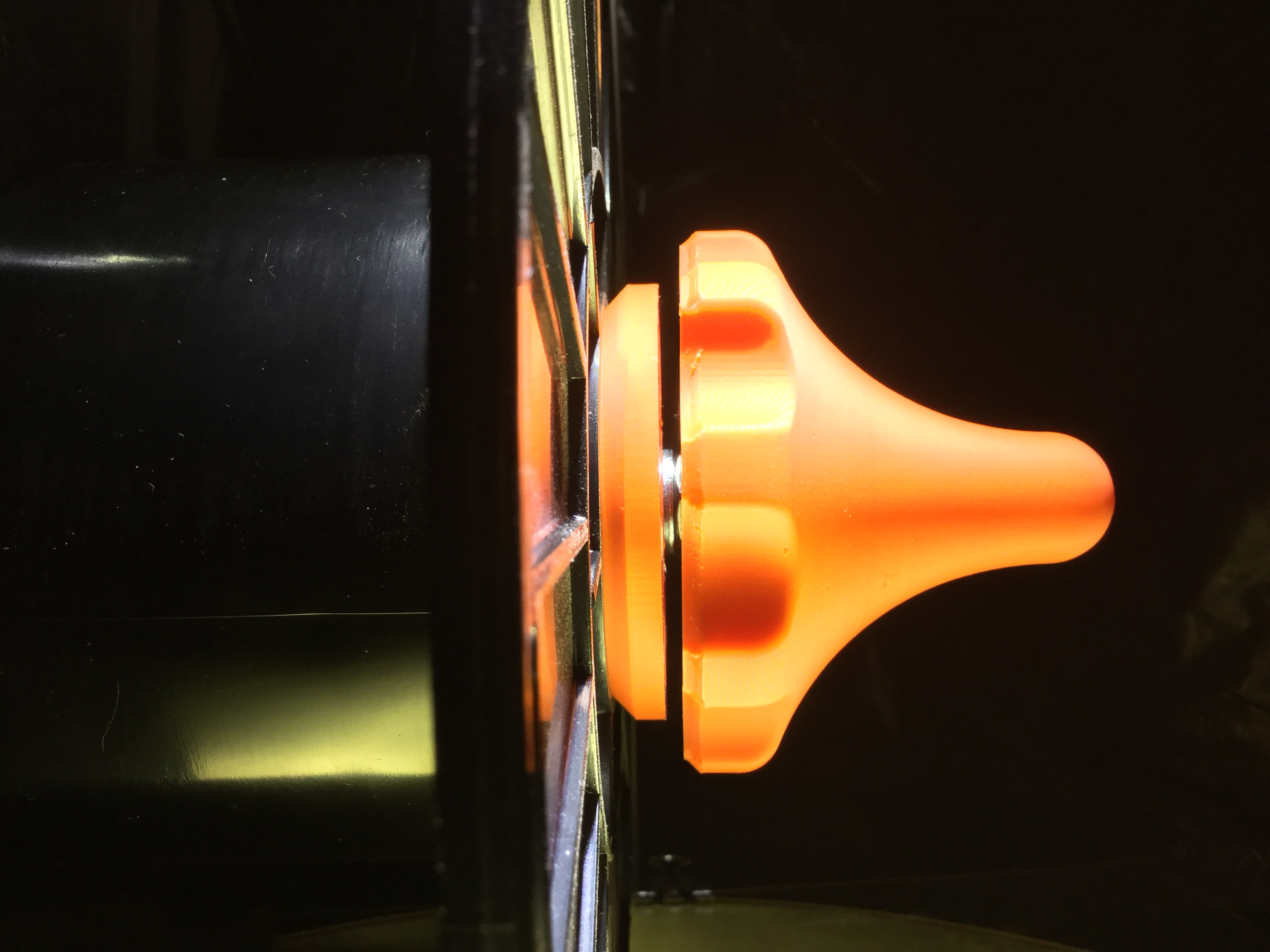

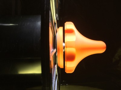

Got the Cones and Support Arm Mount printed. I adjusted my retract to 2.5mm and the cones came out very well, seam is very smooth.
The bearings fit great in the cones. My M8 rod I bought actually slides easily in the Support Arm piece so I will need to glue it, but I may reprint because it looks like I'm under Extruding a bit.
Washer between Bearing and Knob
