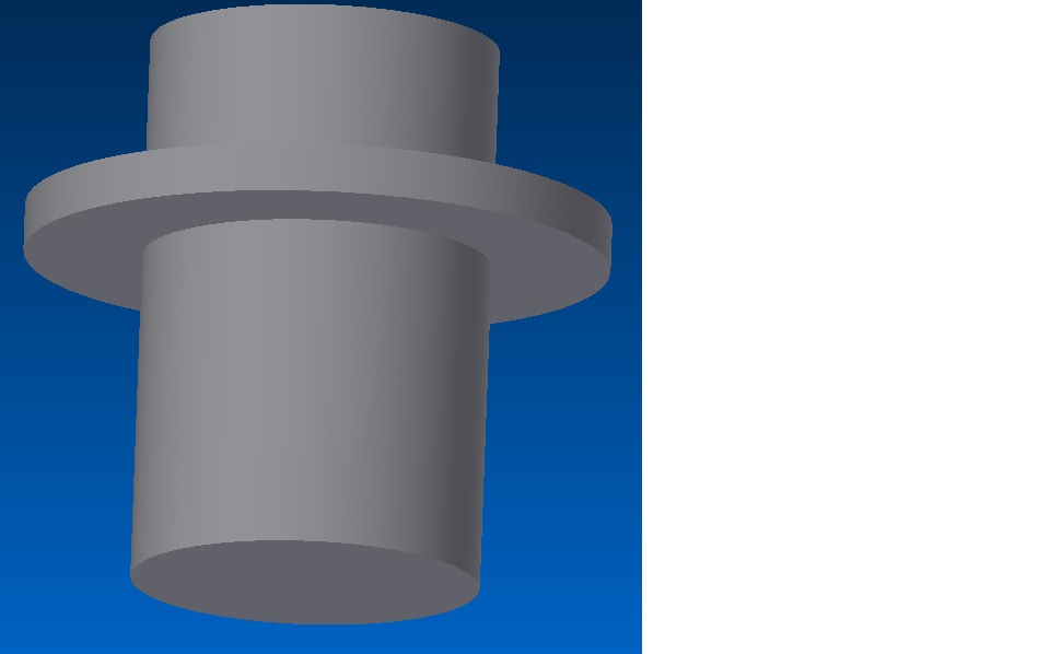

so I decided to make the upgrade from the stock head to an E3d head. I got everything set up and went to go print the first print and it printed the skirt beautifully. then printed the perimeter of the part perfectly and then just stopped extruding plastic. I am using ABS. the extruding motor is still turning and the head is still hot. I went ahead and pulled the guide tube for the filament as well as the filament out of the head and noticed a ring around the plastic filament that prevented the plastic filament from entering the hot zone of the head and effectively stopped flow out of the nozzle. any ideas as to why this is happening. im using the same thermistor and heater as my old head was so I know the temp it dead right. below I have an cad model of what is happening to the filament since I don't have a good enough camera to see the actual issue. any and all help would be great.

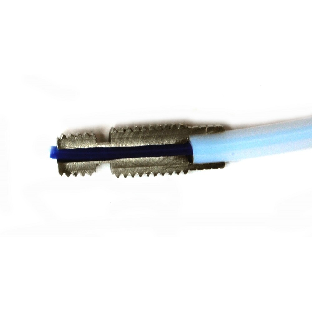

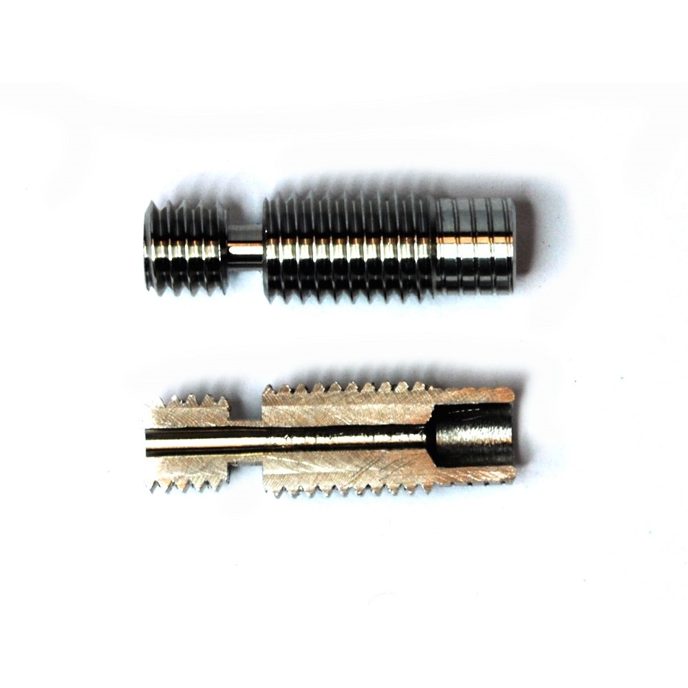

The biggest downfall of the e3d hotends is the connection between PFTE tube and the heatbreak. It has a ~112 degree "countersink"... so even if the PTFE tube is cut perfectly flush at a right-angle, and it sits as far down into the heat break as possible, there is a small lip in the transition. This can be seen in the photos from their own website:
Getting the bowden to reliably sit like this is hard, even, sometimes, as the heatbreak transition isn't so smooth, and the push-to-connect fitting doesn't always get a grab at the right spot. Check for play in the bowden connection, there should be NO up and down movement at all allowed. Literally zero, otherwise your bowden tube is floating freely and your retracts will have to overcome this, as well as many other problems.

I had the exact issue when i had the retracts set too long- i think the hot material gets pulled back, then squished into the gap discussed above.

I was having the same problem. Filing a chamfer on the end of the bowden tube worked wonders for me. I also inserted the bowden tube using a screwdriver underneath to ensure no play. Sometimes the heat break will also work loose due to where the strain relief is attached on your mount. On mine it rotated loose after 50 hours of printing.

Just a question, you did change the nozzle diameter in your slicer right? The stock nozzle is .5mm, the E3Ds typically come with a .4mm nozzle.
I posted on the Bowden fit just the other day here - search my posts. I use a pencil sharpener and then cut 1mm off the end with a sharp hobby knife. Takes 10 seconds and you get a much better fit. The other area where people have trouble setting up the E3D hotends is the nozzle to heatbreak. You have to start with a small gap between the nozzle base and heat block then snug the break up against the nozzle, then tighten at temperature. The instructions explain and show this well, follow them to the letter. If you have even a little gap between the nozzle and heat break it will fill with plastic and ultimately cause a jam.
