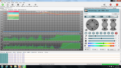

Just took my Rostock to the max and wanted to share. Printed about 3 meters of filament in 6 minutes with the E3D Volcano (32 mm/s with .6 mm layer heights.) Notice the heater output, bed output and fan speed all maxed out!

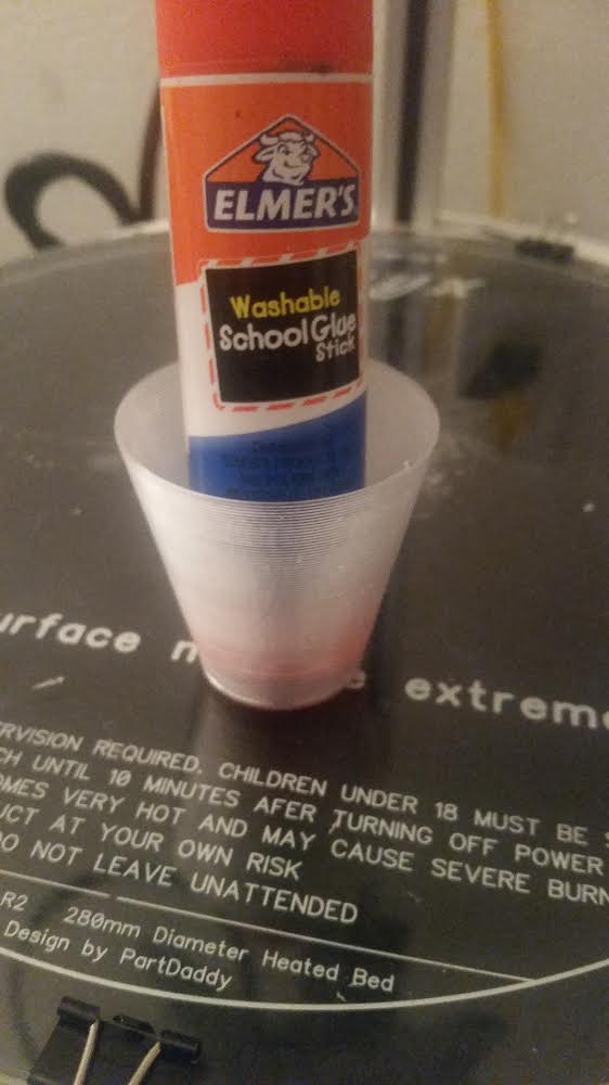

Seeing as I'm bragging about how fast I printed, figured I should show the quality was great too, just printed a small spiral vase with t-glase

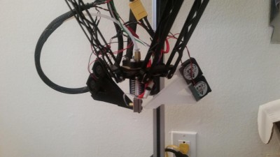

Added some fans to the stock design :D The traslucent fan shroud was also made with the Volcano nozzle in less than 30 minutes. I know the nozzle could be mounted above the effector but just not interested as I am not making anything over a foot tall and below should make the effector more stable. I'm thinking about switching the longer arms, ball joints and IM carriages unless anyone advises against?
