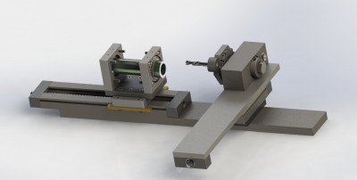

A few pictures, the first being a stripped and simplified machine base so you can get an idea of what I'm going for;
Next is a rough prototype of the sliding headstock and spindle;
And a printed version of the tool turret that will go on the cross slide. The real one will be 4 inches across instead of 3 inches.

				Good idea on the geneva mechanism, the angular load on the turret spindle would be pretty savage when you start loading her up.
Any reason you've gone for carriage feed under the head? Most designs, particularly for lightweight lathes, I've seen have the headstock and motor fixed as rigidly as possible to the X ways and the tool head does the moving. A little different when you get to two tonne machines.
Where's your live tooling???
Keep posting progress please, be great to see this little beast develop. And nice to see something other than the usual 3 or 4 axis mill being built. My 4th axis is a little weak but, without a 5th axis, I can't orient it correctly to do axial boring operations. So they have to be done manually in the lathe before transferring the part to the CNC mill for the "circumferential" work.

				The geneva mechanism never slips, and can be operated with a single stepper motor instead of a clamping mechanism (air, hydraulic, or solenoid) and a separate motor. Plus the repeatability is excellent.
I can machine the entire geneva plate from one side using cheap aluminum flat bar. The live tooling is holding me up a bit. The plan is to rotate the tool into position with a regular two-bearing live tool holder design so that a gear on the tool shaft meshes with a fixed position drive gear. In total, that big rectangular block from the first picture will probably have three spindles through it; one for the main geneva turret, one for the indexing stepper, and another for the live tool driving motor.
I might get more complex if I end up clutching the live tool with both a stepper motor for rigid tapping and a continuous spinning motor as well. I may just go for a servomotor if the price is right. It would be simple to have a separate motor directly driving each live tool, but that would be very space inefficient. I want to drive all of the tools with the same motor.
The turret will never rotate from axial loads like face drilling, or from center-line loads with radial tooling, like cross drilling or whatever. The only time it will rotate unintentionally is from radial torque loads, such as fixed turning tools. I have to make the turret indexing shaft rigid enough to not deflect much from these torques. Anything over 1/2 inch shaft with 1 inch overhang should be good, but I haven't done the analysis yet. Just a gut feeling.
The sliding headstock is for future compatibility with a guide bushing. This is how Swiss type lathes work, since a guide bushing lets you make ridiculously long length/diameter ratio parts without getting any extra deflection from cutting. Keep in mind that having the headstock on an axis that is bolted directly to the machine base and having a similar setup for the cross slide actually makes for a more rigid machine, since there is no compounding deflection from having axis on axis on axis on axis on axis, ect.
This design minimizes axis stacking.
The first picture doesn't show fixed gang tooling, or the subspindle, or a bunch of other stuff I mentioned I want. I'm trying to nail the initial machine construction since the more complex features rely on a solid foundation. All of this while I keep the parts simple enough to make with my own cheap ass hobbyist tools on a low budget!

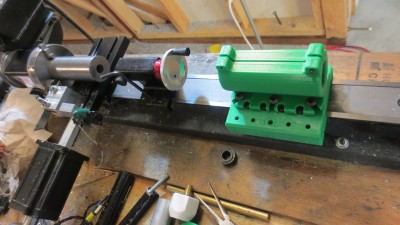

My lathe sucks. The tailstock is misaligned by about a millimeter with the headstock, which has been screwing me up for over a year now. I emailed their customer service and got a replacement tailstock, but it was just as misaligned as the original. So much for USA quality.
Anyway, I printed a tailstock slide and a tailstock mounting part from PLA. I can put different attachments on it, like live centers and drills and stuff. This one can be aligned concentric with the headstock. The purpose is so that I can machine the lathe spindle when I get to it eventually. You can see the big steel bar in the chuck. I can't turn the spindle without a tailstock, since the chuck has very weak gripping power. I need to turn the spindle so that the mating surfaces are within 0.001" of the bearing ID, then I'll press them in place and use thermal expansion to lock the spindle into the bearings. I don't have an arbor to press with so the spindle must be as close as possible to the bearing size, but it can't be any smaller.

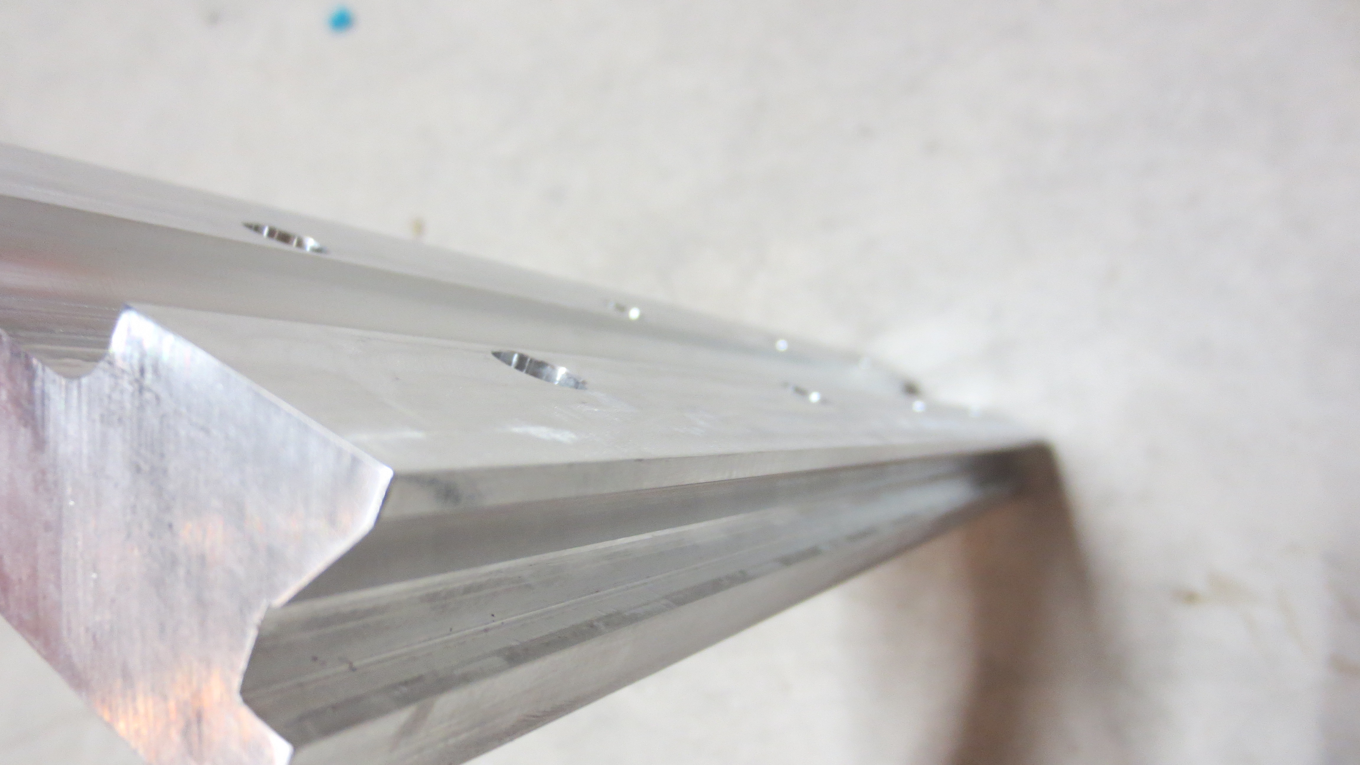

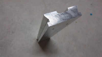

Anyway, I got a few pictures of the machine base. I made these parts before I had an edge finder so I was limited in my design.
I've already redesigned the dovetail guide. What you see in the pictures above was limited by part size and clamping capability, as well as a lack of indicating tools and cutting tools.
The base will mostly stay the same, but the dovetail slide will be made from a single 1x3x12 flat bar of aluminum. Everything needs to be accurate to within 0.001, so the entire slide will be milled without any re-clamping. It's more material removal and I can't make mistakes on it, so I need to get my CNC mill working reliably and error free before I start any cuts. It will probably be a few weeks away since I'm so busy and I need to fix and improve stuff before I can even start!
I plan on lining the linear slide surfaces will something that has very low friction and excellent wear resistance. 0.001 Kapton tape rips, so does PTFE tape. My next try will be UHMWPE tape that is nearly 0.03" thick! If that doesn't work I'll just make thin plates of a wear resistant plastic and somehow fasten them to the sliding surfaces. The idea is to keep low friction and make a linear slide that lasts forever and is still rigid and accurate.

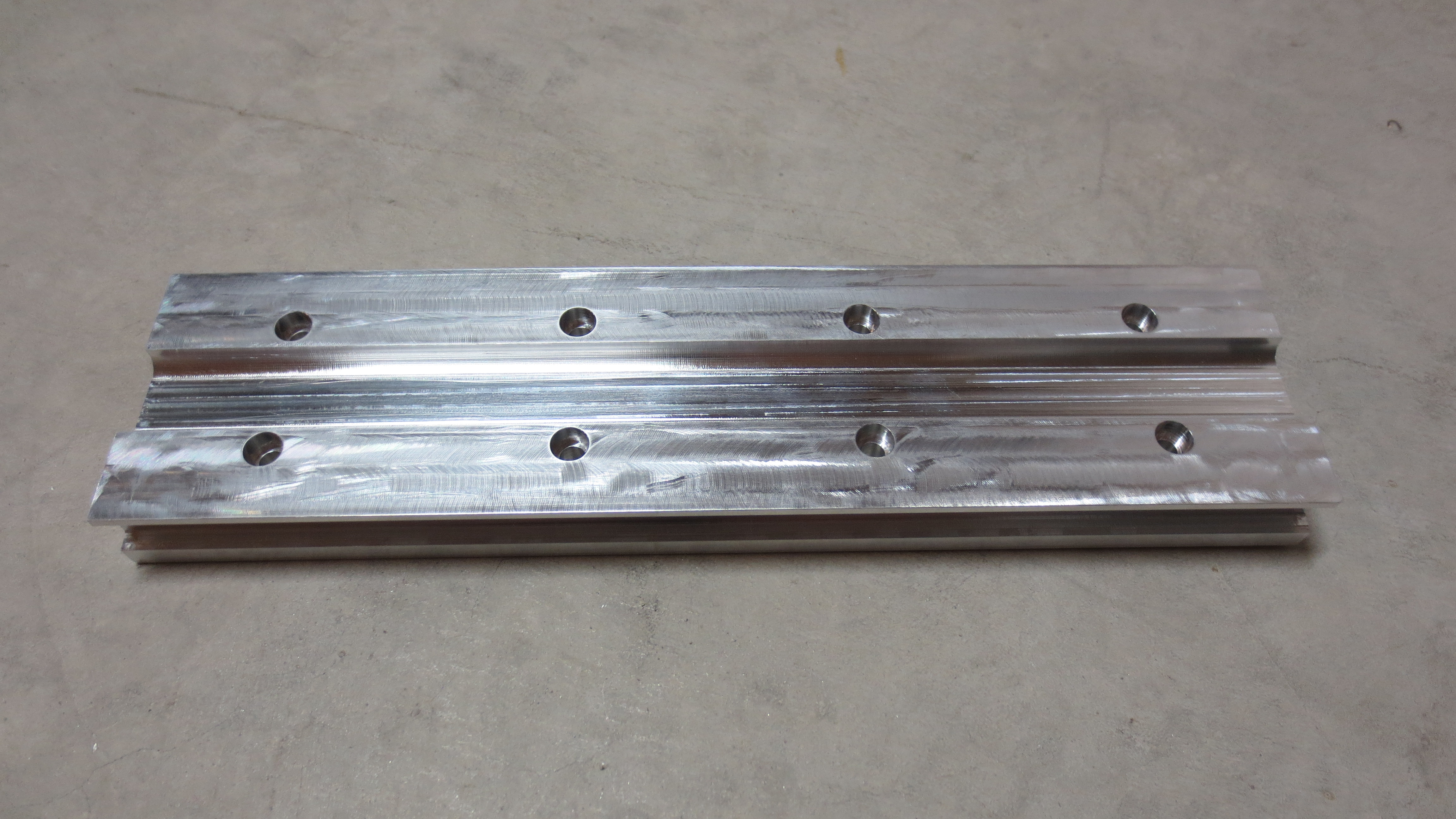

One of the largest and most precise pieces of the mill turn center is the Z axis linear ways, which the headstocks slide on. They have to be extremely accurate, smooth, flat, ect. They are milled in two setups from 1x3x12 aluminum flat bar. The first setup is just to face one side perfectly flat. The second setup is to place the flat side face down on parallels in the mill vise
, then to machine all of the holes and mating surfaces without re-fixturing. This guarantees parallelism within a few ten thousandths across the entire part. The 60 degree dovetails are perfectly aligned with the top sliding surfaces of the rail.
Unfortunately I messed up a bit on this piece. I made it a day before I bought an air compressor to clean stuff. When I flipped the part there must have been a tiny spec of metal between the parallel and the flat milled surface, which caused it to not sit flat before machining. As a result the whole part is only accurate to a couple of thousandths instead of ten thousandths. The top side mating surfaces are still parallel and stuff, but I'll have to re-flycut the bottom surface relative to the top to fix the problem. It is still a working part as of now, and it's still accurate to 2 parts per 12,000. I checked the corners with a micrometer to figure this out. The spec was under one of the corners between the face and the parallel. Metrology stuff here!

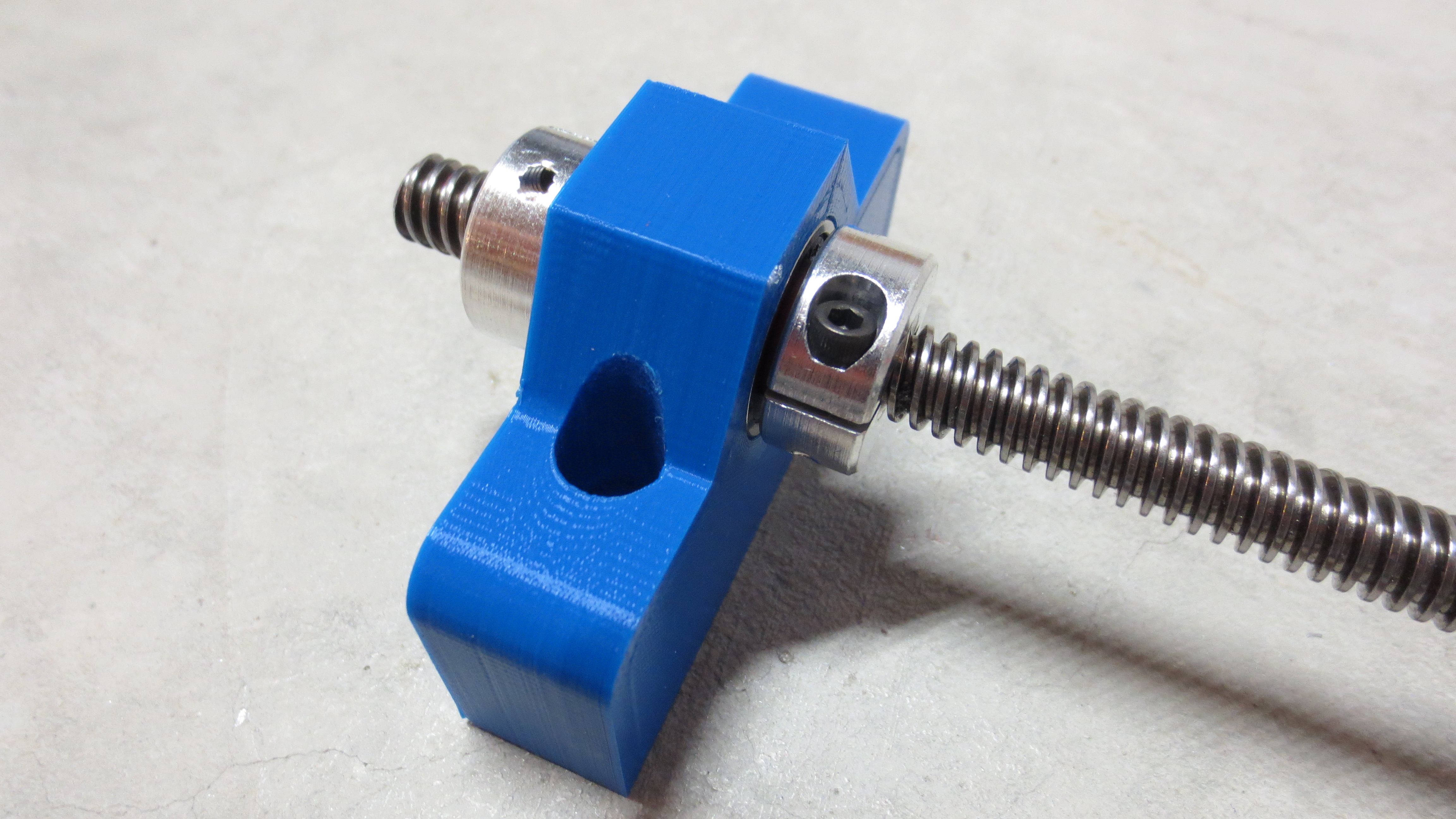

It's a 0.375" fast travel precision ACME leadscrew, passed through two radial ball bearings in a thrust block, locked in place by two 0.375 clamping shaft collars. Before locking, the assembly is preloaded for stiffness by tightening a nut onto one of the shaft collars. The ACME leadscrew has a pitch of 1/6 inch. So each revolution pushes the linear slide 0.166666 inches. With 200 steps per revolution and 16x microstepping, the machine will have a positioning resolution of 0.000052 inches, about half of a ten-thousandth of an inch, or just over one micron. When turning cylindrical parts, the diameter step size would be 1 ten thousandth of an inch. Well within my goals for precision!
The most important thing to the setup is the nut itself. It does not have any moving or adjustable parts. Backlash is zero. By printing the nut vertically with extremely close thread fits, and using a long nut length, backlash can be reduced to zero. I have tested this a bit with many nut designs, and right now I have a damn good one! The nut is around 4 inches long and has many thread faces in contact with the leadscrew at any time. Backlash is less than 10 microns (at worst). With grease and a bit of thermoplastic creep, the friction drops to near zero but no gaps develop in the nut. I'll see how well this design holds up to constant, high load usage. It can't run nearly as fast as ballscrews at any real load, but in slow axis travel it is excellent!
It's a good fit for my machine, since the slides will not travel more than about 7 inches and will only do so at low speeds and moderate loads. The cost per linear slide is in the range of 10 dollars, excluding electronics.
Also, I've been thinking about this quite a bit....Is there any reason at all to keep the screw ball bearings in a tight fitting bore on the thrust block? As long as they can't move
axially with the screw, they will work fine, right? I'm thinking about oversizing the thrust block bore so the bearings float radially for easier alignment. They would still clamp to the flat surfaces once preloaded, but it would make assembly a lot easier, and machining the blocks with be cheaper too.
NOTE: The thrust blocks here are just prototypes, the real ones will be machined from aluminum with larger flats for the bearing faces. They are bolted to the machine with two 1/4-20 socket head cap screws so they can take large thrust loads.

I know it goes against normal machine design. My leadscrews are 0.375 diameter and only a foot long. The nut itself is 4 inches long, and I might upgrade that to 6 inches to take up the entire length of the carriage when it's bolted to it. My earlier designs had back-to-back locking nuts to eliminate backlash. I realized that a very smooth, burnished, fast travel leadscrew sliding against printed thread flanks has almost no wear compared to other systems. The ridiculously long nut has so many threads in contact that there is no axial slop, and the load is distributed across a very large area. I think this will give the nut a very long service life. They have no backlash as of now, my main concern is if they will wear out quickly.
The thrust blocks, on the other hand......
Radial play in the bearings is [nearly] eliminated by preloading them. It makes them stiffer, too. I noticed that on my Taig mill, the leadscrews are 15 inches long but can rotate with no visible wobble on the other side of the table, which is like 16 inches away. The bearing faces are ground flat, and once they are preloaded against each other, they will hold in position. Allowing a radial clearance in the thrust block is simply for easier assembly and alignment, since it prevents binding from misalignment near the thrust block. I'll test it soon. If it doesn't work out I'll go back to the normal way of fitting the bearings into precise holes.
Since I'm using fast travel leadscrews and direct drive steppers, there will be a maximum force that the linear axes can generate. They will never spin the leadscrews over 600 RPM and the thrust force will probably be below 30 kilograms peak. Most cutting doesn't take that much force, as I've learned from my mini machine tools.
