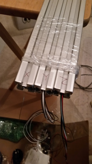

Another comment about the 4th Edition Assy. Guide -- I was confused about fishing the wires through the aluminum extrusion. It mentions preparing the 18 ga. wire, but no mention of when/where to use it. I figured out (from page 84) that it was meant for X axis tower.
But the docs say on page 71:
Now go ahead and pull the 22ga wire for the hot end down
the next tower extrusion and label it “X Axis”.
I think this is an error, and should be "18ga wire" instead of "22ga wire"

For what it's worth, this is a table I used to better understand the goals of wiring the towers...
Feel free to edit/use as you wish...
Tips/techniques I found helpful...
  • I kept the plastic wrap on the aluminum, but peeled back toward the ends to expose the cut ends to get access to the last 1" and the holes.
  • I put clear tape toward the flat side of the aluminum and labeled them X,Y,Z on both ends to keep track easier during wiring.
  • I used a stiff wire from my junk box to fish the wires through, instead of the included wire which seemed harder to fish with.
Tower Wiring Plan
  • X-axis -- 18ga (for hot end)
    Y-axis -- end stop wires (from Rambo Kit)
    Z-axis -- 22ga (4x wires) for extruder motor; 26ga (4x wires, 2 pairs) for PEEK fan, Layer fan.

EDIT: I uploaded a photo to show my setup for the wiring. I felt keeping the plastic on and the aluminum together made it easier to handle.

Scott, you'll need to take 14" of the 18ga hot end wire and use it on the Onyx. While you technically CAN use a stripping die to reduce the diameter of the 12ga wire, there's still not enough physical space above the RAMBo to permit it - even if it was safe - which it realistically is not. (chances for shorts between the two terminals)
Don't feel bad - this caught me too while I was building Walter for the new manual. I ended up having to re-shoot the video & a few of the photos.
Essentially what happened boiled down to a communications error. The RAMBo guys were asked about the compression terminals' max gauge. Thinking that SeeMeCNC was asking about the power connector, they replied "12". SeeMeCNC was either having a bad brain day or simply didn't realize that the top compression terminal block was different in more ways than just the color. That's how you ended up with the "extra" 12ga wire. I don't know how many kits got shipped in the narrow window between them changing over to the new power supply and me flipping a desk when I discovered the error. :)
Thanks for the tips & corrections. I'll make sure they're in the next update....which will be VERY soon.
It seems that they've run out of 18/4 wire (18ga, 4 cond.) and have now changed the hot end wiring to be 2 18ga (black & white) and one 26ga white (you cut in half). Now this is much more practical from an assembly standpoint, but now every bloody photo that shows those white & green wires is wrong and either needs to be re-shot, or requires bold-notice text that explains why they've got tiny white wires in their hand as opposed to the big honkin' white & green wires shown in the photo.
I write it off to "Continuous improvement can sometimes be a painful process." :D
