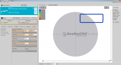

I cannot figure it out but my 3d view of the print has it at center but in the layer view and when I print it puts in like the layer view!
See attached:
MatterControl Layer View
This was after using the MatterControl AutoCal (which shouldnt effect it?)

So I did some extensive searching and found this. This sucks.... but my problem is fixed :)
IMBoring25 wrote:For the 1.2.X branch of Slic3r, they completely changed the way the bed is defined. It now defines a series of coordinates that draw line segments to build the bed periphery. The one it will generate for a 280mm diameter circle is as follows:
Code: Select all
bed_shape = 139.2331x14.634,136.9407x29.1076,133.1479x43.2624,127.8964x56.9431,121.2436x70,113.2624x82.2899,104.0403x93.6783,93.6783x104.0403,82.2899x113.2624,70x121.2436,56.9431x127.8964,43.2624x133.1479,29.1076x136.9407,14.634x139.2331,0x140,-14.634x139.2331,-29.1076x136.9407,-43.2624x133.1479,-56.9431x127.8964,-70x121.2436,-82.2899x113.2624,-93.6783x104.0403,-104.0403x93.6783,-113.2624x82.2899,-121.2436x70,-127.8964x56.9431,-133.1479x43.2624,-136.9407x29.1076,-139.2331x14.634,-140x0,-139.2331x-14.634,-136.9407x-29.1076,-133.1479x-43.2624,-127.8964x-56.9431,-121.2436x-70,-113.2624x-82.2899,-104.0403x-93.6783,-93.6783x-104.0403,-82.2899x-113.2624,-70x-121.2436,-56.9431x-127.8964,-43.2624x-133.1479,-29.1076x-136.9407,-14.634x-139.2331,0x-140,14.634x-139.2331,29.1076x-136.9407,43.2624x-133.1479,56.9431x-127.8964,70x-121.2436,82.2899x-113.2624,93.6783x-104.0403,104.0403x-93.6783,113.2624x-82.2899,121.2435x-70,127.8964x-56.9431,133.1479x-43.2624,136.9407x-29.1077,139.2331x-14.634,140x0
Unfortunately, it doesn't look like MatterControl will properly import a 1.2.X-formatted .ini file.
You could download a standalone copy of Slic3r, import your settings into it, correct the bed shape settings, and then use that copy of Slic3r to generate your gcode.

I just ran across the same problem. I don't know how to correct slic3r, however what I did was add the following to the gcode that was generated:
G92 X100 Y100
after the home command. I found that in mattercontrol if I set the bed center under options as 100,100 - that my print showed up in the center of the bed. However it appears this setting is only used to adjust the layer display, and has no affect on the gcode that is generated. Likewise, the G92 command does not seem to have any affect on the print displayed offset on the bed, but it prints properly.
