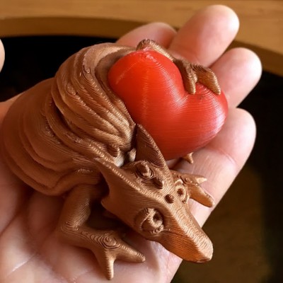

Ok, so I posted in another forum a photo of my first Cyclops print but here it is for an example:
This was sliced in KISS with no special magic. For models like this - 2 separate STL files each associated with a different "extruder" - KISS worked fantastically. No messy ooze, etc. It just worked. But, I'd like to be able to print perimeters and shells in one color (clear for instance) and the infill in a second color. KISS can't do that but S3D in theory can. I started by trying to duplicate the dragon and heart. It took about 6 attempts to finally sort it out and I'm getting relatively decent results (but to be honest, not as good as the KISS results). But now trying to separate the shells and perimeters from the infill things are going horribly wrong! I'm using an ooze shield (although I tried the tower and both the shield and tower too) but S3D is not priming (i.e. not using the ooze shield or priming tower) when switching from the clear perimeter to the red infill I'm using. It's an odd thing, it just continues to print but actually starts driving the second extruder. I've searched and scratched my head on this one. I think Polygonhell fought this too and posted on the S3D forum back in July - and no one replied. So I thought I'd try here, at least folks here are friendly!

Hey that looks pretty good. Why bother with the other slicer, this is as good as can be hoped for. (i have a low threshold to be impressed)

Haha I agree, it looks good, but as Mr. Hackney pointed out, he would like the infill to be the second material, which kisslicer can't do I guess.

Exactly bot, I am trying to push the design envelope with multi color printing. I am working on a technique I call "kaleidoscope" that encapsulates a decorative color infill inside a transparent shell. I'm almost there. KISS doesn't allow selection of the extruder for perimeters & shells vs infill. S3D does. What I'd really like is to be able to specify the extruder for shells, perimeters and infill separately.
