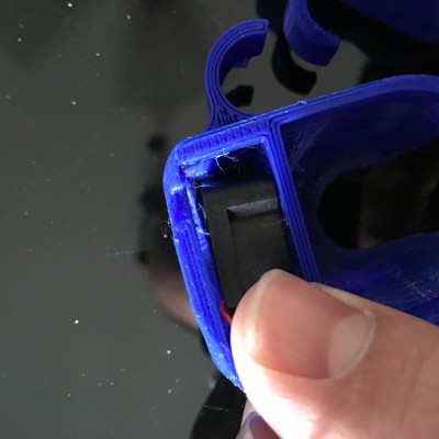

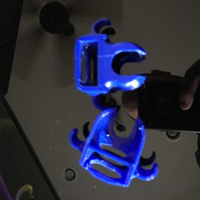

So, after a grueling couple of rainy days, I finished assembly of the Rostock Max V2. Went through calibration and printed the first fan shroud. The slot where you put the fan is about an eigth of an inch too wide. In fact, the whole part seems too big. I went through the calibration again and verified my eeprom settings from the manual. Printed again, same result.

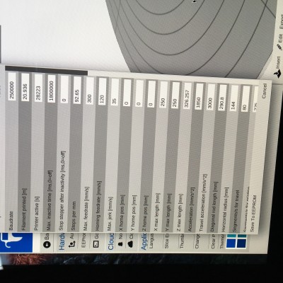

I had searched and have already double checked the diagonal length setting. I'll attach a shot of my eeprom settings.

Try setting that steps per MM value to 80. You've managed to confuse axis steps per MM with Extruder steps per MM.

Xenocrates wrote:Try setting that steps per MM value to 80. You've managed to confuse axis steps per MM with Extruder steps per MM.
Man, I wish I had posted on here sooner rather than spend 2 days trying to figure what I did wrong.
I just saw "steps" and I was excited.. Anyway, changed it back to 80, changed the correct field, saved it, running a test print, I'll let you know how it goes.
