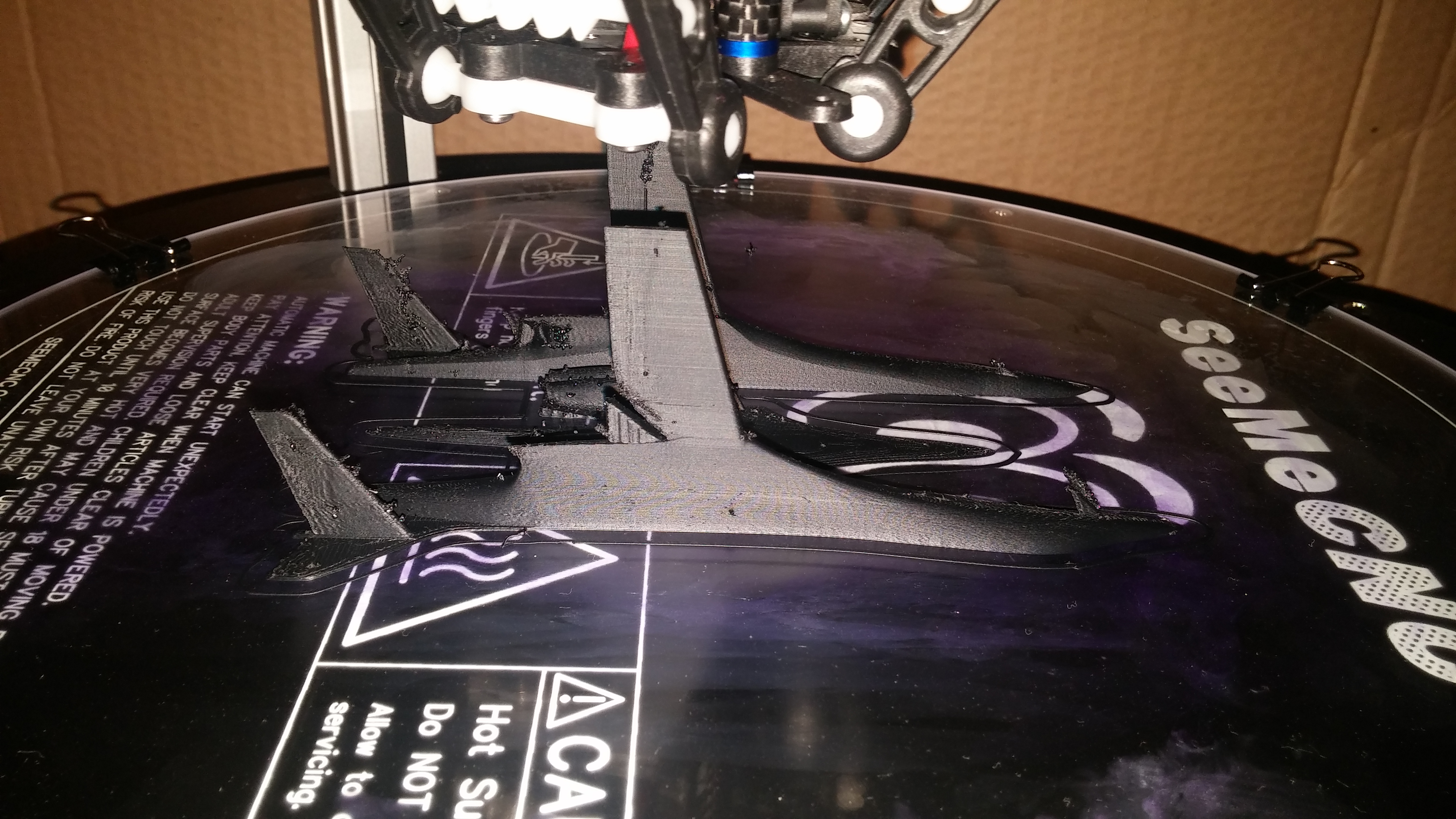

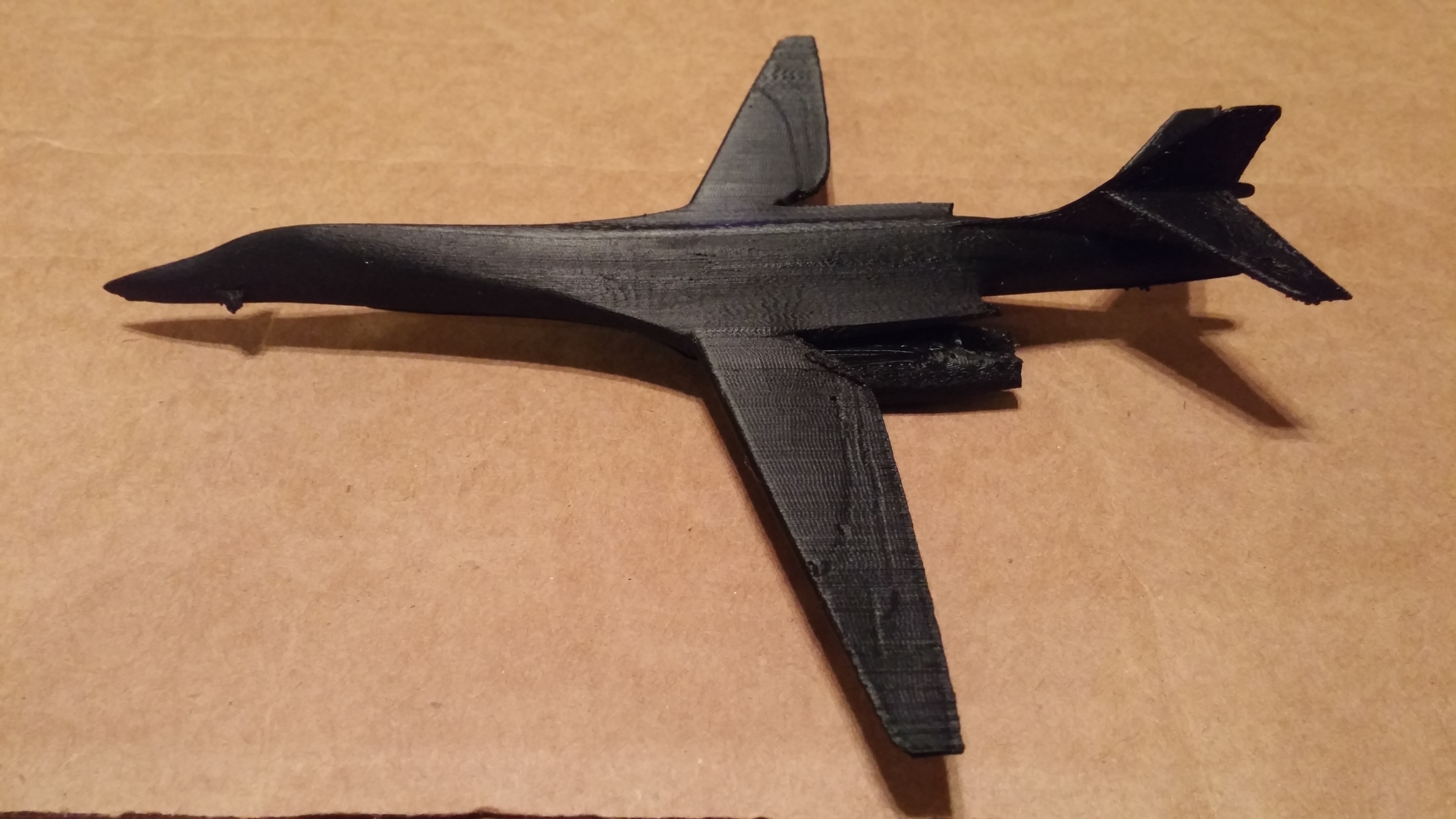

I've had a few successful prints, found .97 a good extrusion multiplier @ 235C for my E3Dv6 with my black ABS and the standard quality setting in matter control. I cut up a B-1 stl to make it printable and wanted to use fine settings as a test run, but I am having issues with retraction on travels... Getting more than a few clinging peices. Any suggestions for improved results? Thanks!

Counterintuitively, Try slowing your retract down some, and see if it helps.

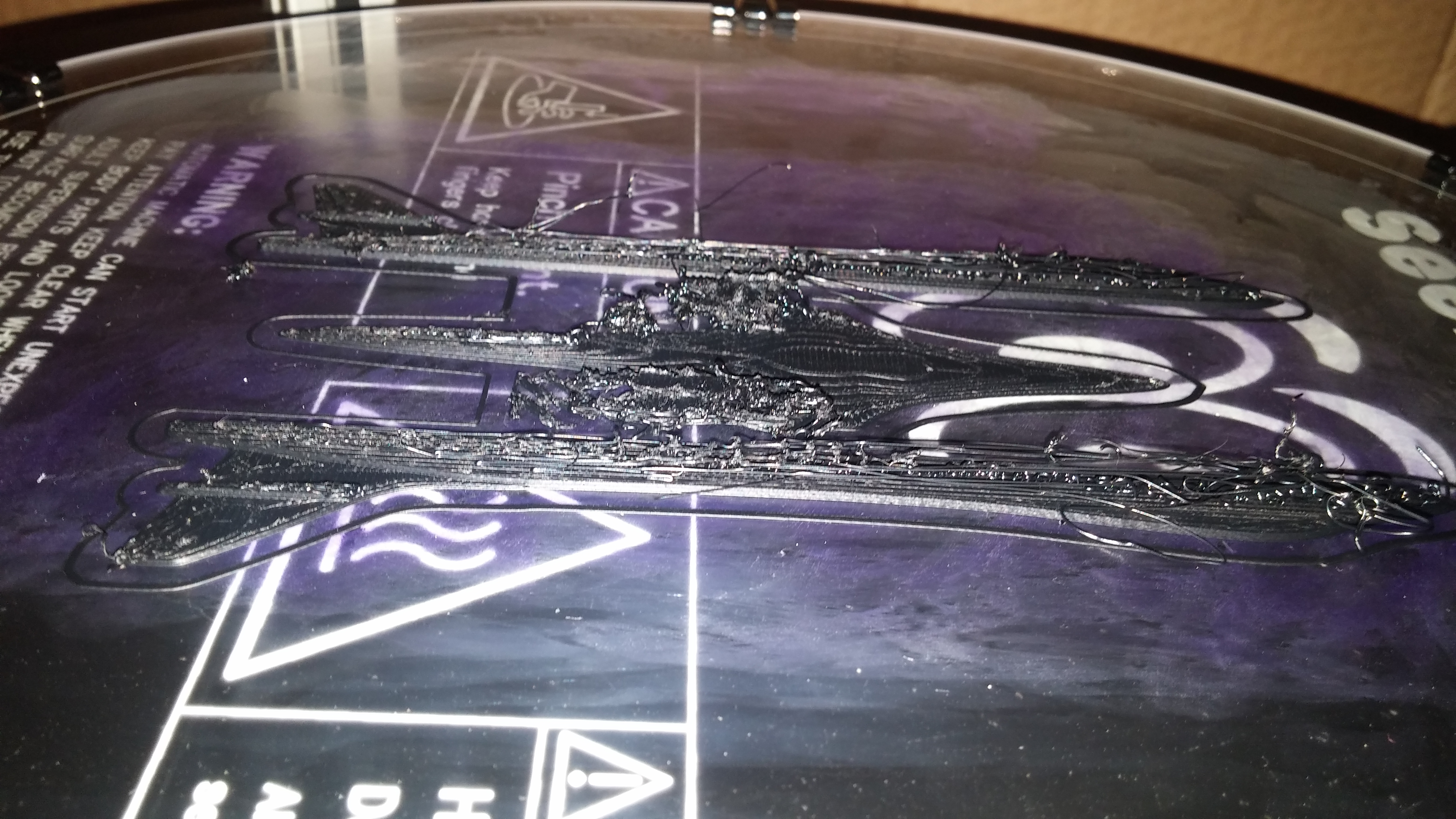

Re: Help with retraction
Hmm, 50mm/s gave me a wiry mess this morning, I'll have to try the towers idea.

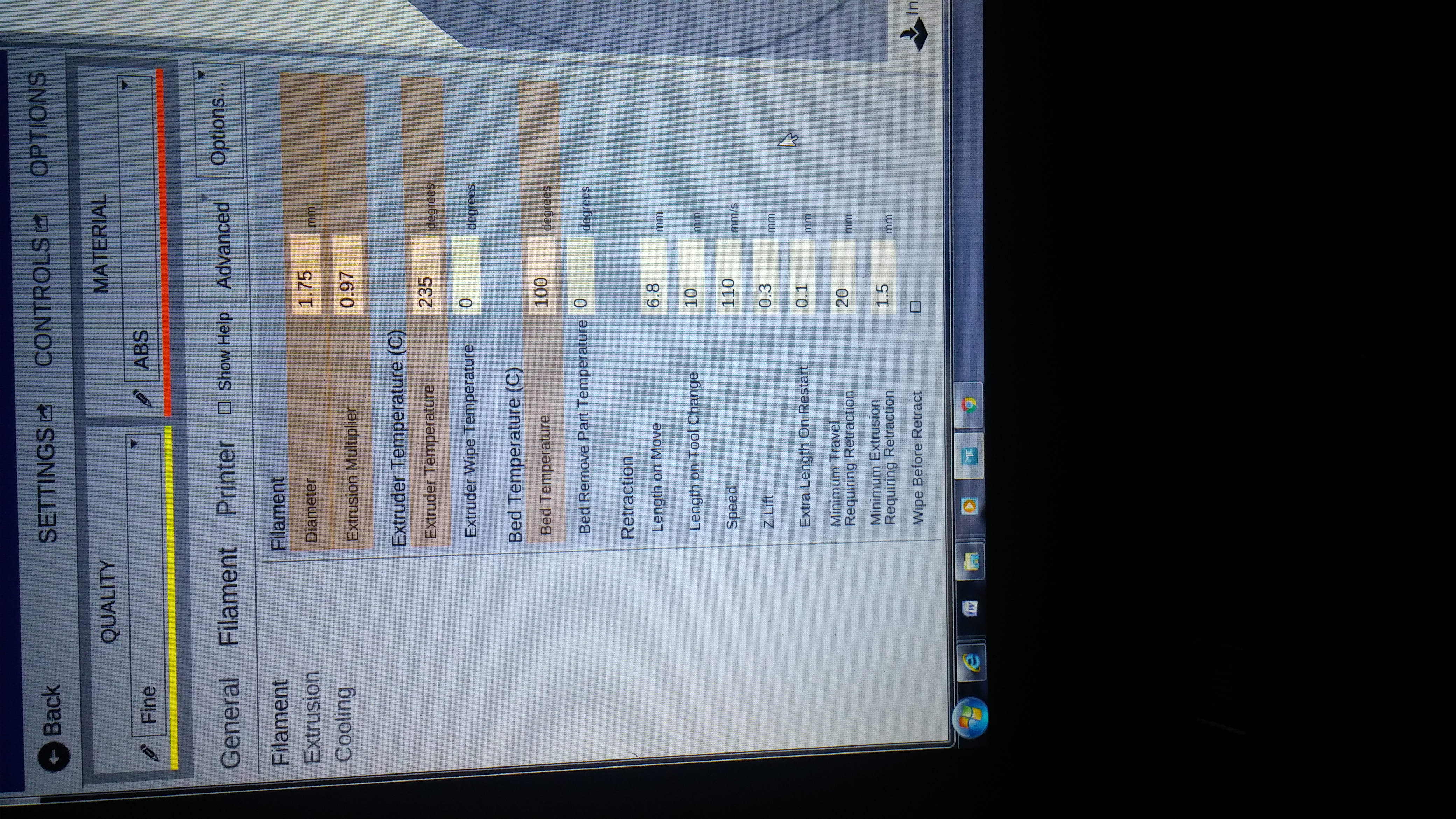

looking around here I'm seeing that 300mm/s as the default travel speed for non print moves is too fast, so I halved it to 150 with 80 mm/s retraction speed for now and am printing this calibration pyramid https://www.youmagine.com/designs/hollo ... on-pyramid I'll see how that turns out and adjust from there.

Btw, the first one turned out ok after a bit of cleaning, but I will keep trying to make it better.

I printed this pyramid three times at different retraction settings before I realised that the travel distance wasn't generating retractions. What distance do y'all typically use for min travel for retract?
I was wrong again, the travel distance was not the only factor, the min extrusion prior to retraction was also too high. Right now I am trying it again at 25mm/s retraction with 3mm min travel and .1mm min extrusion requiring retraction.

when you say 1.5mm @ 20 mm/s are you referring to the "length on move" setting in mattercontrol of 1.5 mm? the default is 6.8mm. I tried reducing this number to 2mm and it is not pretty. I have yet to find a sweet spot after half a dozen calibration pyramids. can you list the settings that typically work for you with ABS as a starting point?Polygonhell wrote:There is little advantage over about 30mm/s. Really high speeds tend to result in lost steps either on the retract or the return, which leads to uneven flow for a short time after the retraction.
No I mean set the retraction to 1.5mm, the recommendation for the SeeMe hotend can be as much as 10mm, but E3D hotends don't like a lot of retration.

So my next test:
1.5mm retraction
at 25mm/s
with default 0.3 Z lift
3mm minimum travel requiring retraction
??mm minimum extrusion requiring retraction (I put .1 to ensure a retract on every move)
do you use "wipe before retract"?

I'm having pretty good luck with ABS with 3mm @ 180mm/s, .2 Z lift, 0 and 0 on next 2 items, retract checked, no wipe. I've read that the higher retraction rate tends to minimize strings. I tried a 40mm/s rate and got stringing between parts, 180 seemed to fix it. Using Hatchbox white if that matters. I'm only on my 3rd week, so it's all new to me. Only problem I'm having is OD of parts is about .24 mm large in X and Y, I "think" I'm calibrated.
