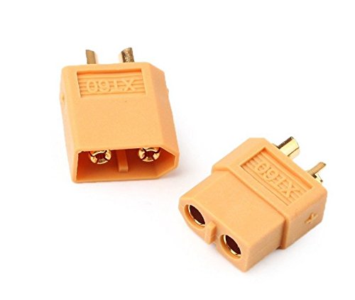

i used these from amazon for the heater resistors
LHI 10 Pairs XT-60 XT60 Male Female Bullet Connectors Plugs For RC Lipo Battery

That looks production ready... When does shipment start?
Re: Another E3Dv6 joins the ranks!
Those connectors look great, thank you. Solid, cheap, available, perfect.

I used some of the above XT60 connectors for the hotend. That is the only one that really needs something bigger than the small JSTs.

I did use the XT-60 for the hotend and they are very good, a bit bulky though.

I'm still thinking I like the XT60, or its little brother the XT30 connectors for the resistor, both of which are massively overrated for this application (If I'm not insane minimum 2.5amps, safety factor of x2 for 5? making the XT30 6-12 times more than necessary). Good Idea or should I find something more crimpy while I'm at it?
