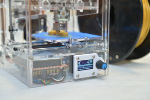

Extended :
•Arduino Mega 2560 + RAMPS + 4 x A4988 (full GPIO, SPI, COMM, I2C and replace parts individually)
•1 x E3D Custom Hotend ( Fit for Tinyboy )
•12 x LM4UU Bearing for X,Y,Z (Smoother movement)
•1 x 3mm Washer for Z-Axis (More Stable)
•2 x 2GT 16 tooth Gear for X, Y (Easy Setting from Marlin)
•2 x GT2 3mm Belt for X, Y (Less friction)
•12 x Belt Bearing for X, Y (Smoother movement)
•1 x 12V Power Switch (on/off from the machine)
•3 x 35 Stepper 0.9 degree per step for X,Y,Z (Stable Movement)
•1 x Aluminum bed with sand blasted (flat bed against heat)
•4 x Bed Leveling using spring (Easy adjust)
•2 x Hole for Carrying Belt (Portable)
•1 x 4mm Thickness Acrylic Case (Stable Framework)
•1 x Acrylic Spool Holder (Perfect match)
•1 x TinyOLED v1.2 1.3" OLED Display /w Tinyboy Splash Logo (Display Info with User Control)
•1 x TF Card Module (TinyOLED - Offline Printing)
•1 x Bluetooth support (TinyOLED - optional)
•1 x Wifi support (TinyOLED - optional)

The maximum size of printed object is 8 x 8 x 8cm , which is relatively small than many other 3D printer. However, it is already large enough for making things like figure and toy.
The gain from the trade off is the cost down of material and maintenance. Take out components for making large printed object , the design become simple and lean. The core material is acrylic sheet and connected by metal screw. Therefore , the cost of material and building can be minimized.
Easy to build / Learning by making
The process of making has the opportunity to transform education by inviting students to be something other than consumers of education. They can be maker of anything , moving from being directed to self-directed through the process.
Tinyboy is designed for easy to build. The assemble from kit can be done by just using a screw driver. We wish student can make their own machine. Then they become a pioneer whose may make another one for other people. So that the use of 3D printer can be spread out to more student.
The case of TinyBoy uses acrylic plane as the main material. Individual parts can be made by using cutter laser. Therefore, the manufacturing process is easy once you have a laser cutter. In fact , the price of an A5 laser cutter can be as cheap as USD $400. That make the cost of small amount production be reasonably low.
Specification
Size: 15cm(W) x 15cm(D) x 22cm(H) (excl. filament holder)
Printed size : 8cm x 8cm x 8cm
1.75mm filament / 0.4mm hotend

I don't know why they'd think an ad for something like this on this forum would get too much traction. Most of the people here already own one or more larger printers, and could easily make something like the V3D, the Tantilus, or Kossels if they needed additional printers. It's dirt cheap, but then, you deal with a support team (if they have one) without a guarantee they know english, they're using what seems like undersized components for any sort of speed, and it appears that it has no bed heating provisions, nor does it seem like they would use an actual E3D hotend, as that would eat almost 20% of the printer cost, if not more. They also don't mention including a 12V PSU for it, as it looks to take an external brick.

this actually looks quite easy to build:)

I must confess, the idea of a micro-printer I could sit on a desk at the office is very _very_ appealing.
