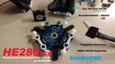

Here's a picture of things. The probing is executed by G69-towers, G68-horz radius, and G30-z height. There's a couple more pieces of information needed. You can explore our github Eris Repetier repository if you just can't wait. :)
The HE280pcb rev_5c
The HE280pcb rev_5c

PartDaddy wrote: Here's a picture of things. The probing is executed by G69-towers, G68-horz radius, and G30-z height. There's a couple more pieces of information needed. You can explore our github Eris Repetier repository if you just can't wait. :)
Does the probing just calibrate the towers and Z height, or does it use one of the mapping techniques that accounts for non flat build surfaces and the virtual curvature of delta printers?
PartDaddy wrote:RMAX HE280 Accelerometer Probe beginnings_PartDaddy.jpg
I like the look and compactness. Is there a specification for the connector terminals you are using? Part number, pinout, etc? I'd like to find out if there are compatible connectors available and rewire my hoot-ends so I can have compatibility.
Thanks for the update!

I'm using an 8 pin mouser 1778890. These are really nice. The tiny blade of the SeeMe Screwdriver (or small jewelers screwdriver) releases the wire.
The HE280 hotend is designed go up to 280C. We will limit the firmware temp for the Eris to 245 or 250C (you can hack temps in the Arduino program). Yes, the PTFE runs to the heater block, not just the heat break, but through the heat break up to the heater block. There's a difference... it's called 'doesn't jam'. Advanced users will decide to crank up the temps, but the beginner shouldn't do this.
The mini RAMBo has a heated bed FET. Under the glass build plate of the Eris, there is a well for a 4 pin ATX connector for a heated bed. The standard Eris is non-heated and does not have a connector installed. Not trying to be clever, it is noteworthy and real, that the bed is passively heated. If you want me to call this fact something else just say. If it makes more sense, I'll change the wording. Bed the build surface temp is elevated because of the enclosure electronics. There isn't a thermal problem with the 60mm cooling fan, it just doesn't blow directly on the bed.
Just 'cause there isn't a heated bed in the standard model doesn't mean it can't do it. The HE280 will run all the filaments we sell. But like I mentioned, the Eris and maybe RMAX firmware download will throttle back the upper limit. Again, it's easy to hack for those who want to crank it up.
Probe calibrates towers (level), horz radius (tramming flat), and z height. Your build surface should be flat to begin with. Mapping doesn't make sense to me. It's neat to watch though. I've seen a finger "mapped". Lol.
