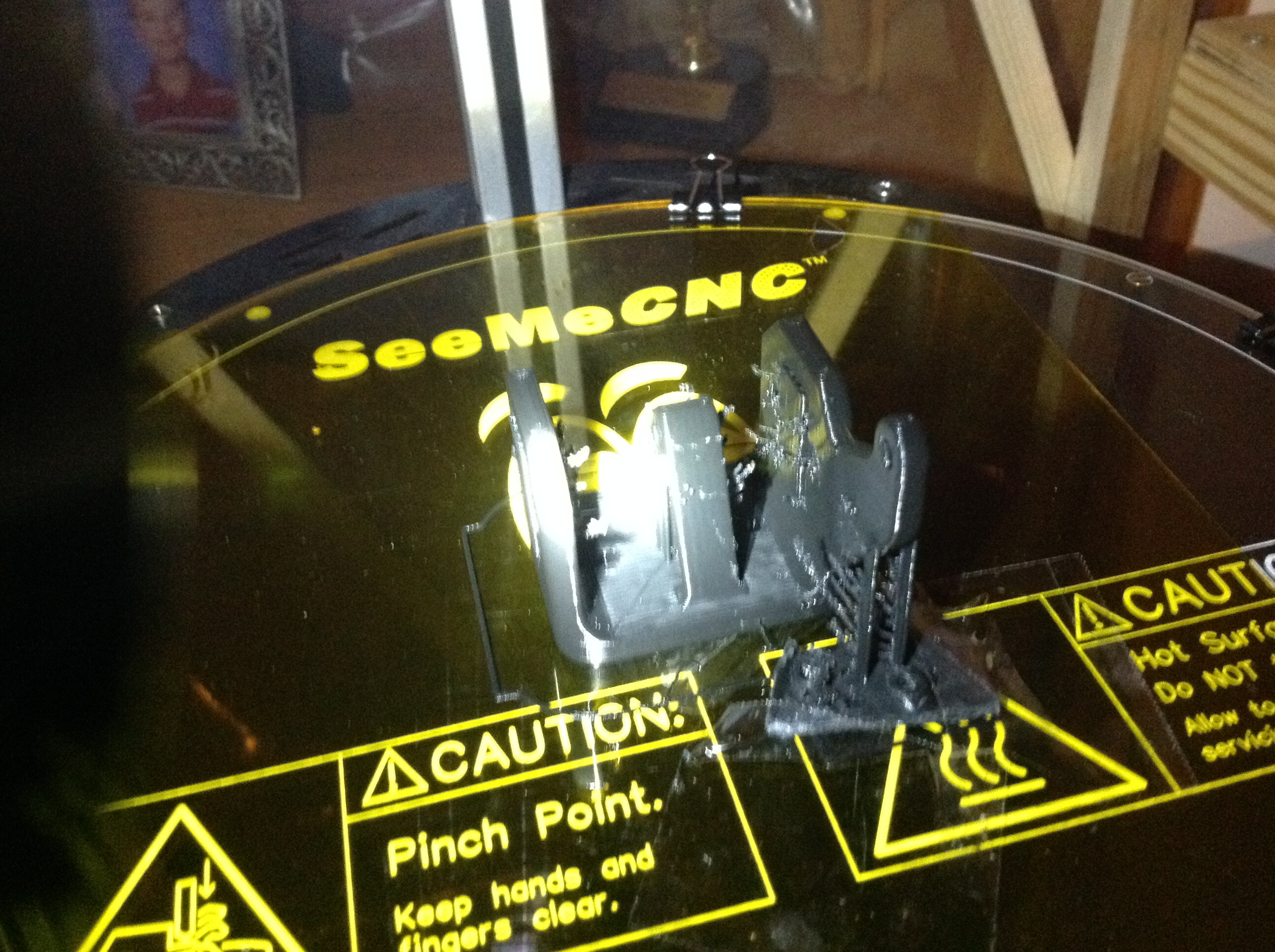

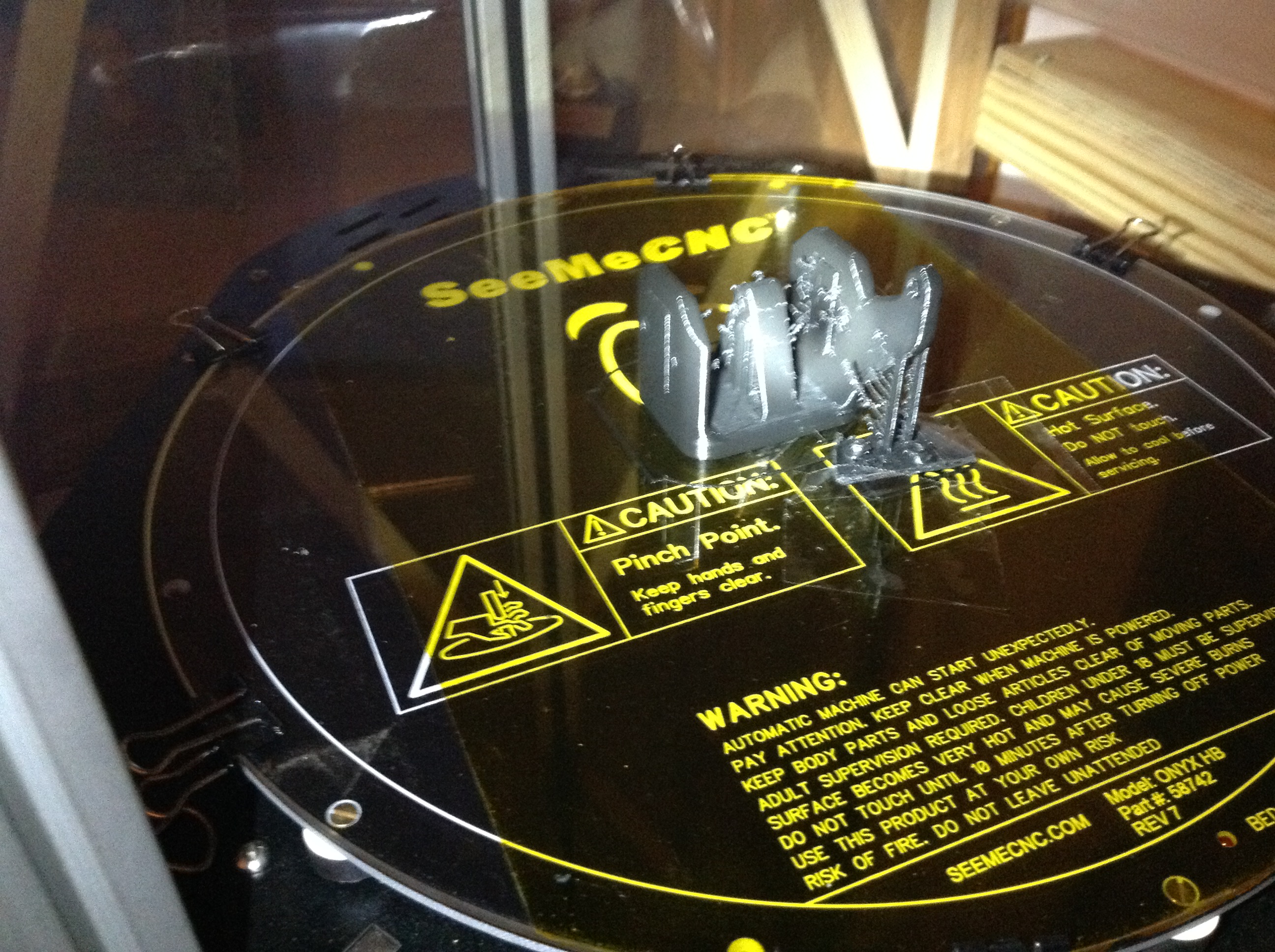

So this was born out of desperation when a support tower broke free near the beginning of a print. Not wanting to start all over I looked around and found a scrap that was approximately the same height and taped it to the bed. The print(other than the artifacts) came out great.
V2 max with the HE280 hotend
Re: "Saving" a print
Penged wrote:...broke free near the beginning of a print.
That's the easiest time to start a job over :)
Print looks good, I'm glad it turned out. It looks like you could tweak your temp and retraction a little bit to get rid of those stalagmites.

I think it was the THIRD time I started that one over so my pride took over. Its Makergeeks black PLA. printing at 200 with no fan and a 50 degree bed. What would you suggest as far as tweaking?

Nice save!
You should definitely try printing with a fan - read mhackney's great post on them here: http://forum.seemecnc.com/viewtopic.php?f=37&t=1584
What retraction amount are you using currently?
Here's a great calibration object for testing your retraction: http://www.thingiverse.com/thing:15087
Start with 1mm and work your way up until you find the sweet spot. Mine is 4.7mm retraction at 30mm/s. I run an e3dv6 lite hot end, so YMMV.
