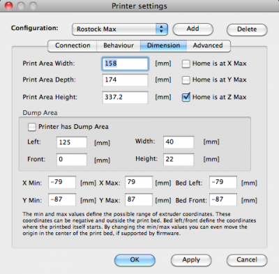

Hi,
I have a similar question here. I calibrated the z axis per the newly updated info on the Reprap wiki page and it worked great. I now connect to the machine in Repetier, send G28, jog down to 0.1 in Z and I'm right at a piece a paper width above the stickralon plate on the heated bed.
But X and Y are not saying zero even though the platform is centered. They are saying -79 and -87 (corresponding to my bed left/front positions). When I jog +79 in X from the center I get to the edge of the plate on the heated bed - actually a little short of the edge to allow for where the clips touch the plate. Similar for jogging +87 from center in Y.
The Reprap wiki says this:
4. Also while in the Printer Shape tab, we need to change Home X and Home Y to 0 instead of Min or Max, and Home Z to Max.
Not sure where to set home to zero. Firmware has 0 for X & Y home position and 337.2 for Z:

My Printer Settings | Dimensions tab is attached. This is Repetier Host for Macintosh version 0.51 (47).
Repetier: Printer Settings, Dimension tab

Sending G28 moves the carriages as you describe, and Z shows the Max position of 337.2 for me. But X shows -125 and Y shows -125 even though the platform is centered.
I can try the home button as you suggest though. Thanks.

Ahh, barnett, in repetier, open config-printer settings and in printer shape tab, set x home positiin and y to 0

I suspect the Mac version is different from the Windows version.
I'm not finding a Config menu but I do have a Printer Settings in the Printer menu (also accessible from an icon along the top).
In Printer Settings I don't have "Printer Shape" but I do have "Dimension". A screenshot of that tab is in my post from yesterday. It's not clear how to set home position to zero there.

FYI: here's the reply from Repadmin to my inquiry at Repetier.com.
Indeed the Mac Host has not the needed setting. The windows host has already a setting 0 for this. Will add this for the next release if I don’t forget it For now you have to ignore the wrong resulting preview. The print will not be effected from this.
