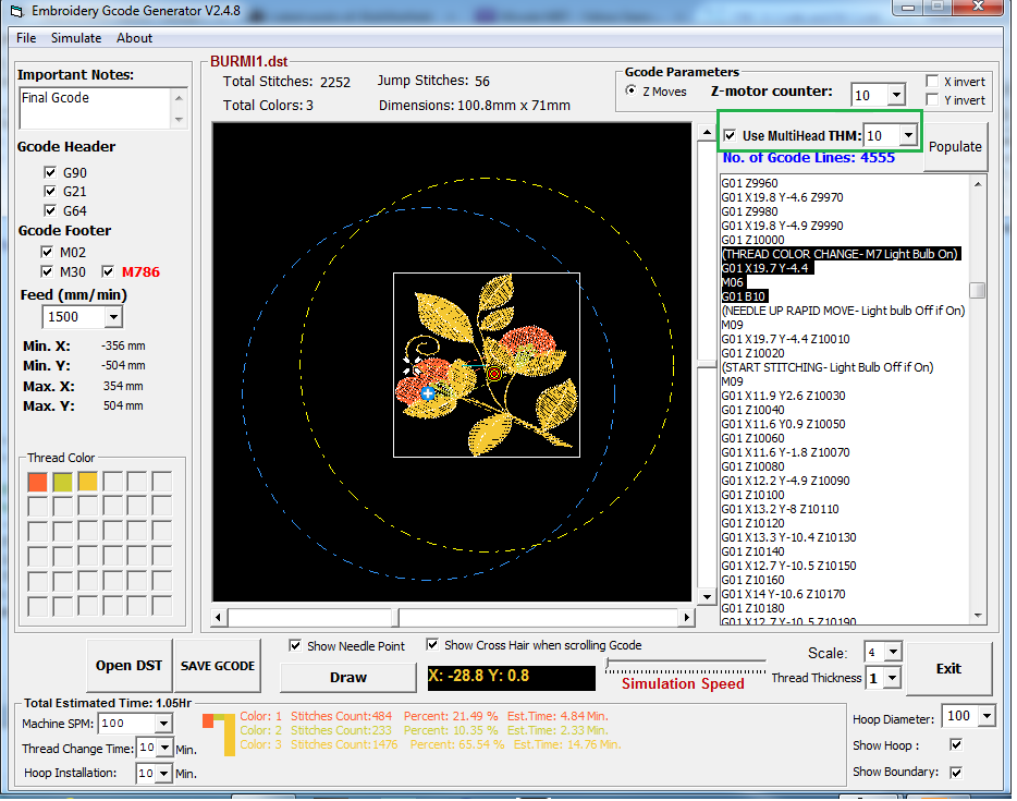

From that day, After a long long time i was able to make a software that can drive my CNC Embroidery Machine with all types of stitches that industrial machines can do. Basically, my intent was to convert low-cost manual sewing machine into embroidery machine that can compete with industrial machines. For this I have to write a software that can convert the DST file into machine readable file.. The DST file is a TAJIMA file format and it is complex binary coded...It was hard for me make a software that can read the file and simulate the design and make the Gcode..Previous experience in visual basic Programming made it possible to write a customised program...
Following is the software that i have written in Visual BAsic Language.. With my this software machine will able to do Straight stitch, Cross-stitch, Zig-zag stitch, Satin stitch, Tatami stitch,chain stitch, Motif-run stitch, triple run stitch, Contour stitch, Perpendicular coil stitch and all types of Alphabets and Pictures...

Here is the Software related video:
https://www.youtube.com/watch?v=5IKwKiq_b7w

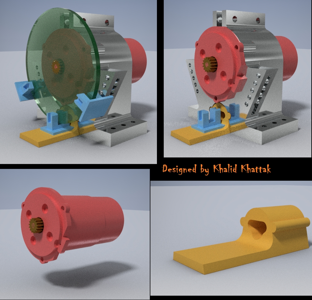

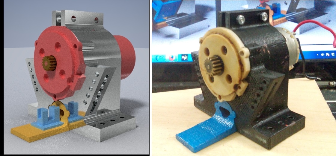

The screenshot of the software is attached. Its world first Gcode generator that can be used with any machine control software. Presently i am designing parts for my machine. The idea is to use NEMA17 motors for X-Y axes and a DC servo for rotation of the wheel. One of my internet friend tested the software and here is the link of the video.
https://youtu.be/e9tHP9UnSo8

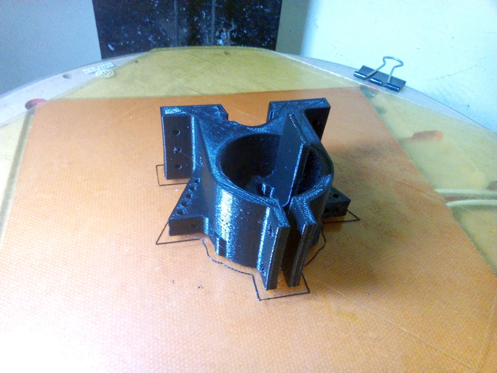

3D printed Parts for my DIY embroidery mchine

Re: 3D printed Parts for my DIY embroidery mchine
Printed parts still on PEI bed surface.

The software is free of cost and can be downloaded.

My intentions are to make the controller cheap... I will use RAMPS1.4 with Marlin firmware , two NEMA17 steppers for X-Y axis...One low cost DC motor converted to Servo Motor for wheel rotation. Only SD card shall be used for controlling the machine...
