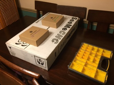

Right, I've received my RMv2 kit, a day ahead of schedule at that. Popped the box open to make sure everything is in one piece, and it is. Very cleverly and efficiently packaged into minimal space with ample protection. Well done to whomever is in charge of boxing.
Box arrived unmolested
My planned build weekend is Feb 4th, 5th, 6th, and 7th. I know it's a cliche but I aim to video the whole thing and knock up a time lapse if I can.
I'm not terribly concerned about building the kit, in a former life I earned my crust doing prototyping and manufacturing small-run industrial automation robotics. The calibration and actual printing itself are another matter entirely, one I have only the haziest notions about, so expect a lot of comical stumbling once I get to that point.
