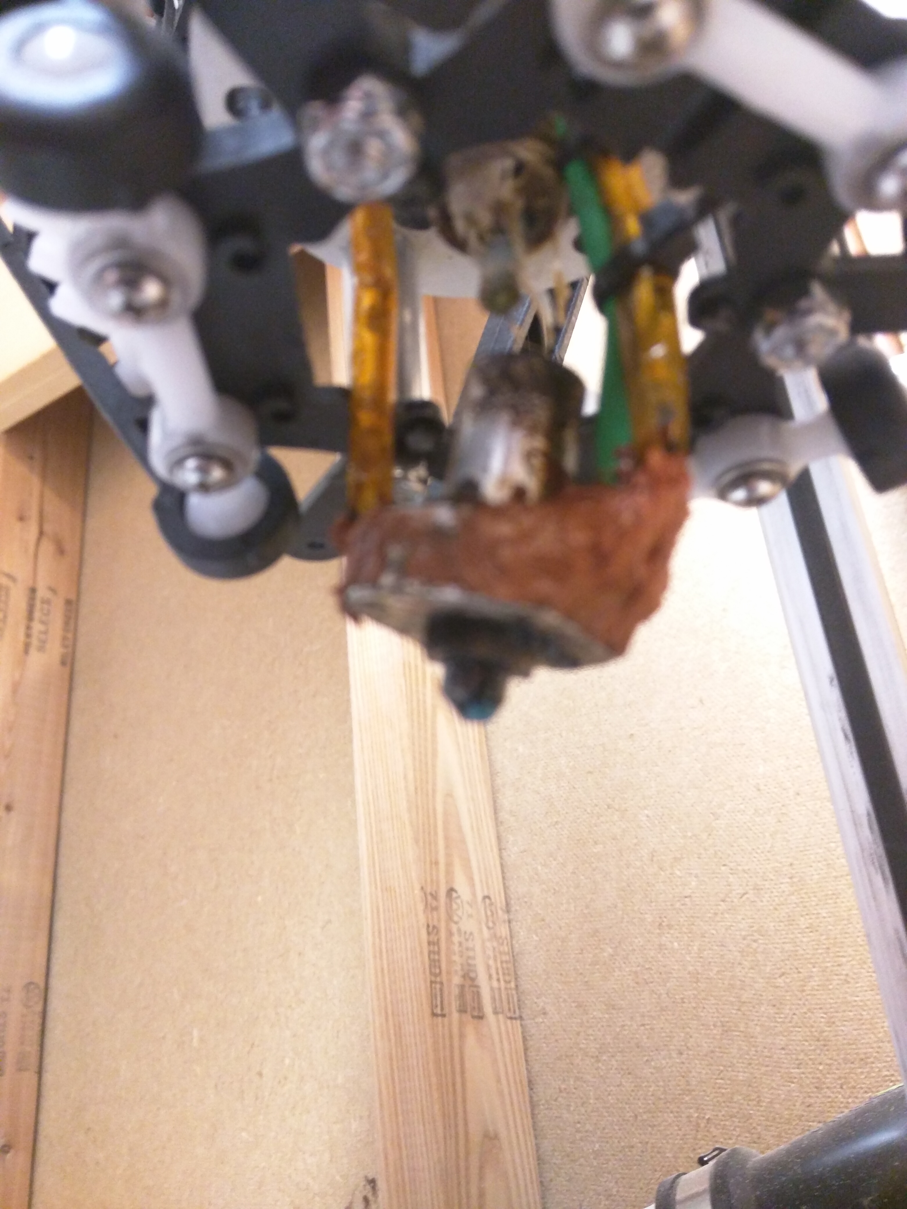

Thank you for all the replies. When I switched to the stock head I added a xt60 connector for easy swapping. I kept my pairs correct but I hooked them up to the wrong set on my 18-4 extruder wire pairs. I was hooked into extruder 1 instead of extruder 0. I didn't even check before because I haven't touched a screw on the RAMBo in almost 2 years. Again thank you all for the help. Should I post the pictures of the melted PEEK?

Re: Extruder temp keeps climbing
Post by komptonkyle »
Now that is what I call melted Peek!
Suitable for framing!
