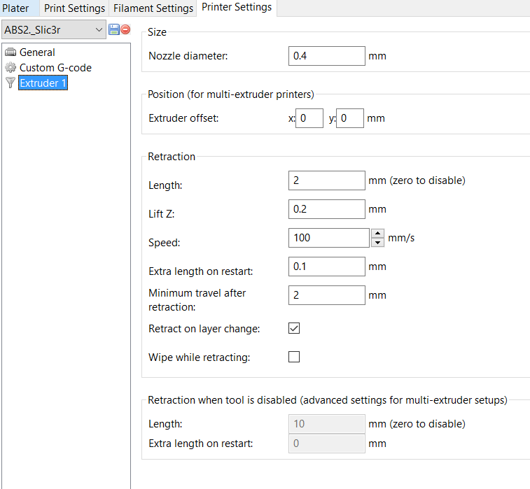

i am still having really bad stringing as can be seen in the photo below. Any idea what settings to tweak to help with that?

by IMBoring25
I too found first layer extrusion width to make a big difference in adhesion.
For the stringing, your retraction is very fast for an E3D. I know it's counter-intuitive, but few I've seen retract an E3D much faster than 30 mm/s. I'm actually using 10 on mine.

I will try to turn down the retraction speed and see what that does.
