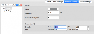

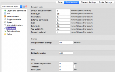

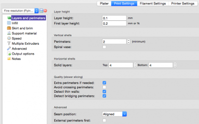

It's not perfect, but should be enough to get started.
Here are my settings. Note that it helps to have a very weak fan wafting a gentle breeze across the surface, when dealing with such small objects.

Have a careful look at your printer while printing. Chances are that your prints are curling up and touching the nozzle as you print, which means more heat transfer to the plastic below. Try reducing your layer fan speed or increasing bed temperature if you can.
