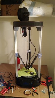

Thought I'd finally post an update:
Here's my completed printer, "Weaver":
Rostock Max complete
I've been printing for the last week and a half, which mean it took me two months to complete the kit - that's a reflection on me and my free time, not the kit itself. Very happy to have it working now, though!

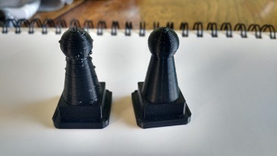

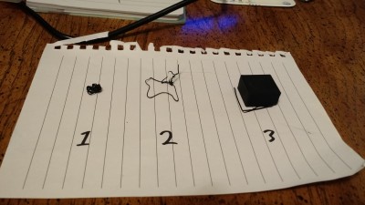

Couple highlights:
First Three Prints
First Three Prints
Computer problems
Computer problems

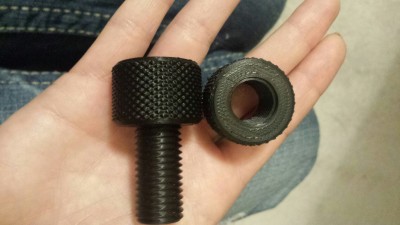

Nut and Bolt
Nut and Bolt

Posted: Wed Apr 06, 2016 11:54 pm
by Eaglezsoar
That nut and bolt you printed looks fantastic!
You must have done an excellent job in calibrating your printer!
