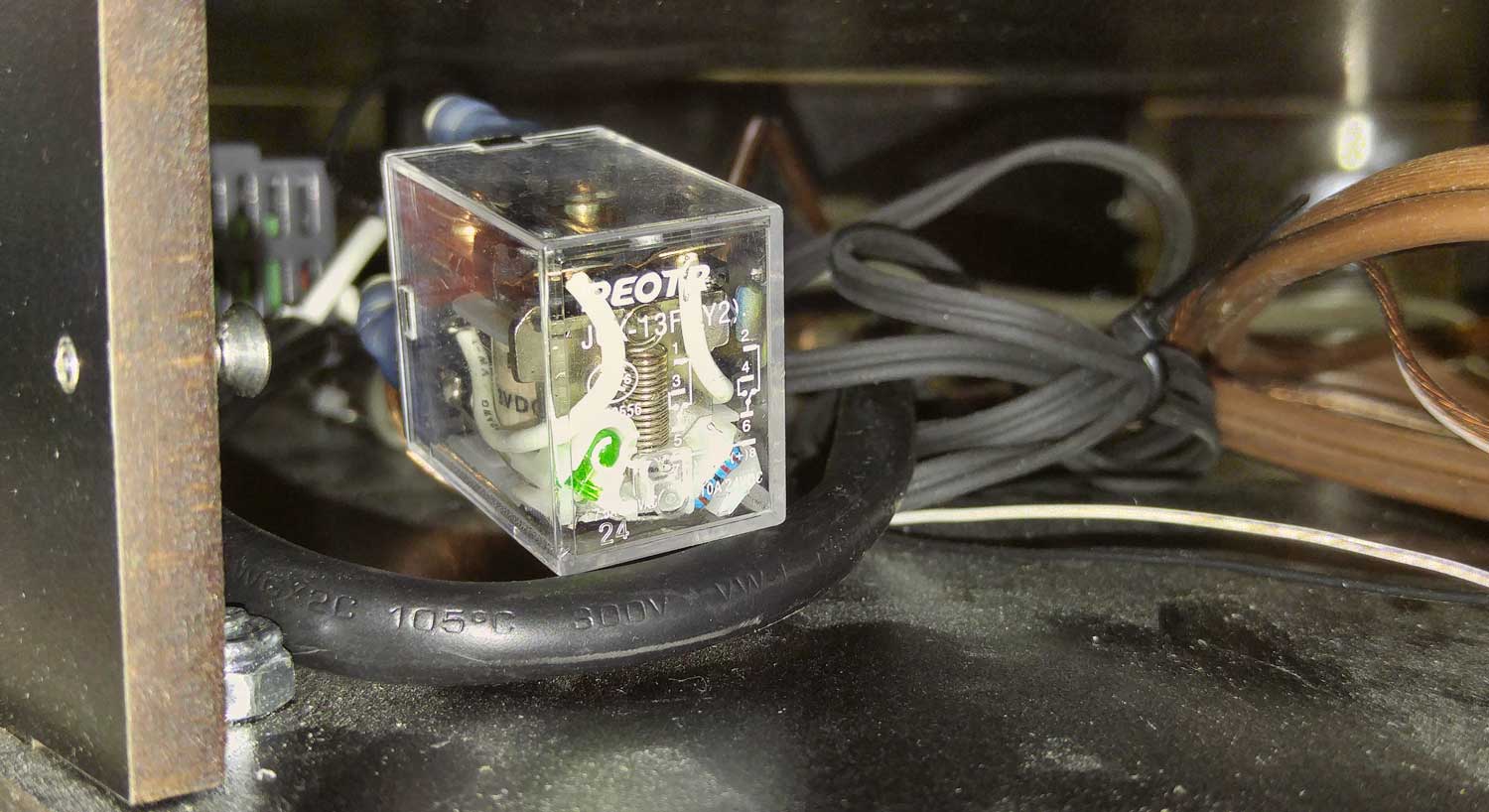

More specifically to my modded Rostock MAX with heated chamber, I would like to find a way to automatically turn off my chamber heat lamp when the print job is done.
Heated chamber thread: http://forum.seemecnc.com/viewtopic.php?f=35&t=9706
5) Is there a circuit I can connect a relay to on the Rambo that is continuously powered during print jobs that shuts off at the end of a print job?
There are many heater and servo circuits that are intermittently powered, but I assume an additional logic board would be needed to switch off power at end of print job using these as inputs.
Considered using the PEEK fan circuit, but my heated chamber/lamp can keep the print head hot enough that the PEEK fan stays powered after the print job is over, so that would not work reliably.
Any suggestions and/or experience folks have would be greatly appreciated.

I'm currently working on making the Rambo control a chamber heater with a relay. Done right, and it will turn off at the end of the print just like the hotend or bed (As the printer will think it's a hotend)
5) I believe the PSU on pin, if it's enabled, would do it, and somewhere there's a suicide pin, which is always on while the printer is (if enabled), that I think is broken out somewhere (may also be the firmware side name for the PSU on pin). If you hooked the heater to your printer through one of the PWM EXT pins, you should be able to control the relay for it just like a heater. There being 4 thermistor ports on the board, and 2 extruder outputs, there's a spare one there for you to use to read the chamber temperature, even with dual extrusion and a heated bed. I will be testing how well it works over the weekend (if I have time), at which point I will attempt to document how to do it. You could also raise the temperature threshold on the PEEK fan a bit, so it's above the temp your printer can maintain.

Completed item #5 noted in the original post.
Upgraded to an E3D Cyclops print head, and followed installation advice to connect cooling block fan directly to system 12V power.
> This meant the PEEK fan circuit was now available for other uses.
> So I set PEEK fan circuit to shut off (when the print head is cooling down) to 100C and connected this to a relay.
> Relay is rated to be switched by 3 to 15VDC power and switch circuits up to 240V.
> This relay now reliably and automatically shuts off the enclosure heat lamp about 5 minutes after the print head heat is switched off.
The PEEK fan circuit comes on, and stays on continuously, as long as the print head heater is activated. Temperature setting for PEEK fan circuit only comes into play after print head is no longer powered and is cooling down. Had to increase this well above its original setting of 53C as the enclosure heat lamp would frequently keep the print head above this temperature. Setting it to 100C as noted above assures that the enclosure heat lamp will shut down.
