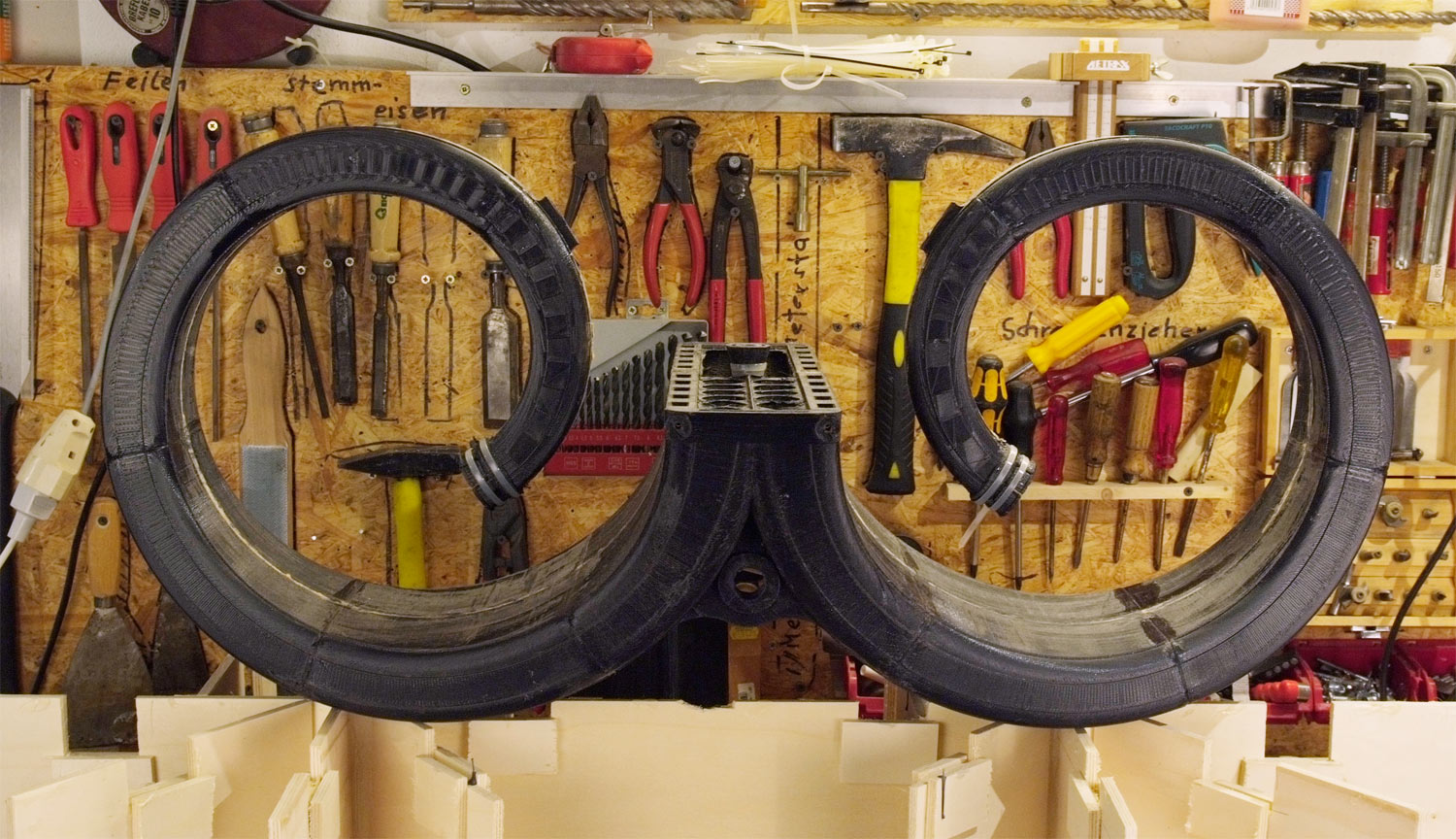

Dual Snailhorn, one part of a much bigger horn.
This part is created with 12 printed segements. Sandwich hull filled with sand to absorb resonance and vibrations.
This part weights completely 25kg. PLA only 10kg, printtime ca.600h.
Stay tuned

What drivers are you using?
What method did you use to calculate and design the horns?

Jimustanguitar wrote:That's awesome!
Hi
Its a Atlas sound driver, the one the police used to install on their cars.
But its haviely modified, to get a linear frequency range from 80hz to 6khz.
Simulation for the Horn were done with AJHorn http://www.aj-systems.de/indexe.htm
Construction were done with Rhino
https://www.rhino3d.com/

Hi
You`ve described it well. But I never have heard that this is a kind of black art :twisted: May as it be, it`s indeed a very delicate technique, with many traps where you will make mistakes and misconstructions.
I have a friend who is very experienced, we developed this horn, it`s quite complicated, because it is a combination of all advantages of all past horn techniques. The demand was not to make any compromises.
The very first measurments are quite promising, a nearly flat frequency response from 200hz to 5khz thats over 4 octaves, and that is a teriffic result and that with a angle of 70°deg horiz. to 40° deg vertic. The horn it self is developed to support a frequency range from 200hz to 10khz, unfortunately there is no driver that can support such a range :cry:
In the pictures below you can see the snailhorn put together with the test flare, this flare will also been printed after the final measurments.
It will be combined in centre with a biradial horntweeter and a large bass array behind,which is a equal method for the bass range.
