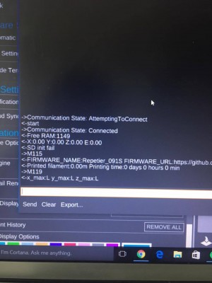

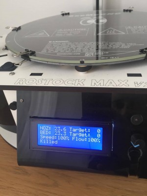

I'm nearly towards the end of my build, few more steps to go..but I'm having issues in MatterControl and within the movement controls. When I select the home button so the x,y,z arms return to their home position it works once maybe twice. Then if I leave it and press the home button nothing happens. I have to disconnect and re-connect for it to move again. That's not my only issue.. I cannot seem to move the arms individually. For example if I press the 'x-' button in movement controls nothing happens. Same with all the other axis..nothing happens. Please could someone direct me to the issue im really eager to start printing now.

Ok, when this happens issue an M119 command. This will tell the status of the endstops. I suspect you'll discover that at least 1 is still closed.

So I have issued an m119 command. Can anyone tell if this is normal behavior from the Rostock? How is the printer supposed to respond when you press the x, y, z values in movement controls?
Re: Calibration Problem!
M119 reads the state of the endstop switches. If the switch is depressed, it will show 1, if not, 0. Yours are showing 0 so no switches are triggered. Try this - hold one of the switches closed and issue M119 - you will see that switch show a 1 (and build experience with M119!).

Thanks for you're help so far however I keep discovering more problems in my calibration process
I will list these out and post a video
- Their is still limited communication with the printer and matter control. What I mean by that is I'm able to adjust the temperature of the bed and extruder fine however I'm still having the same issues with moving the individual axis through Movement Controls.
- Tower Cal script sends arms to home position instead of performing the script, as a result cannot continue calibration.
- Sometimes MatterControl terminal does not perform commands typed in (eg. G0 Z200 F3500) with no effect. I have to disconnect - reconnect the printer several times then try to input the command, However the command: G0 Z200 F3500 has no effect.
What could be causing these problems?

Try slowing the communication speed down in firmware and in MC. You might be sending requests too fast and they are dropping. What do you have it set at now? Trying lowering it a level or 2.
