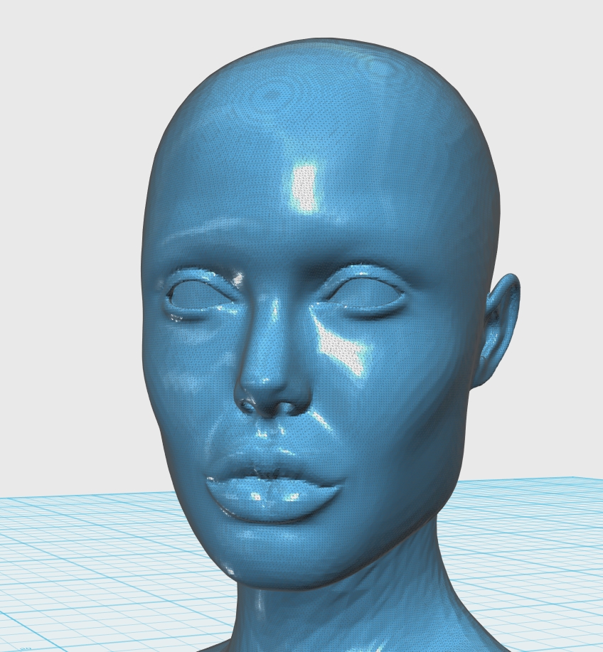

Needs a different face...geneb wrote:I for one, welcome our new plastic overlords!
