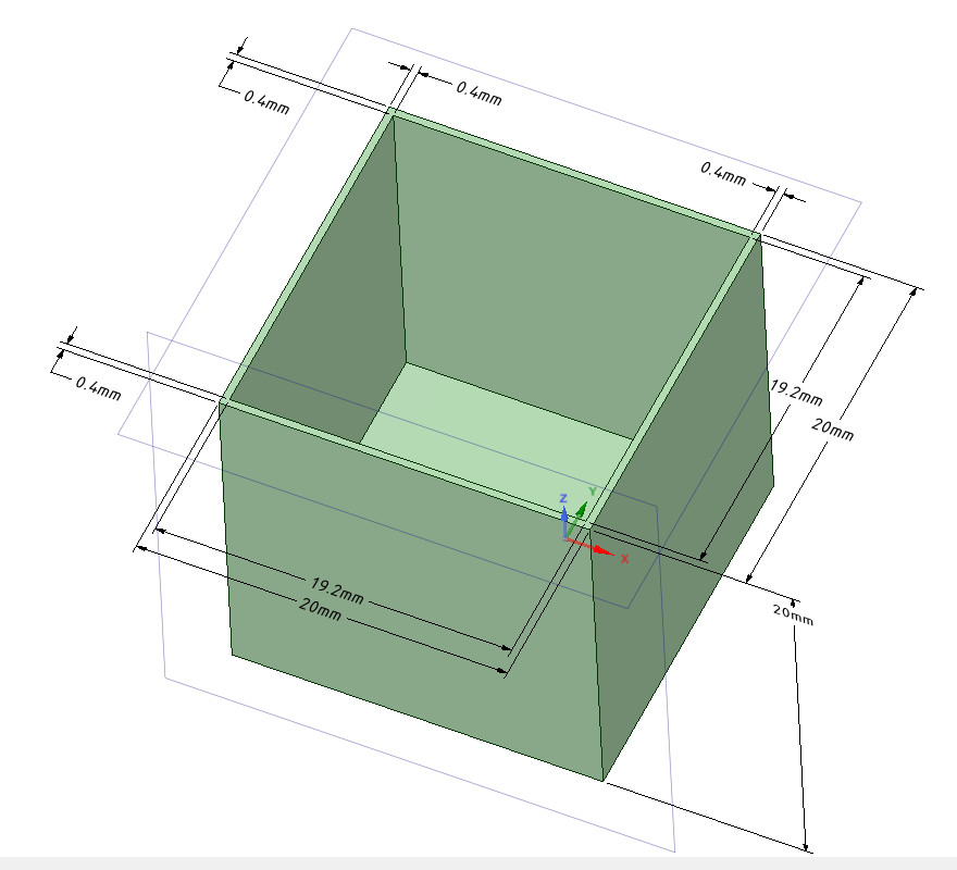

Have you tried to print it hollow with no top to see if the banding is still present?
Here is a test print I use and the measurements. I mainly use it to calibrate the extrusion rate on a .4mm nozzle.
20mm Cube 04mm nozzle test.stl
(1.45 KiB) Downloaded 435 times

If you want to do a single wall test print, your much better off using a solid cube model and configuring the single wall and lack of top in the slicer.
The problem with hollow models like that is slicers don't always handle thin walls like that appropriately.
A single wall print would be nice to see.

Interesting, I've always just created a .4mm thick wall to match the nozzle and printed it as to verify the extrusion multiplier with calipers. That way you know exactly what thickness the wall "should" be and not leave it up to the slicer.

KAS wrote:Interesting, I've always just created a .4mm thick wall to match the nozzle and printed it as to verify the extrusion multiplier with calipers. That way you know exactly what thickness the wall "should" be and not leave it up to the slicer.
Buy you should specify the extrusion width in the Slicer, and with one perimeter, you should get exactly that width, if you specify it in the model and it doesn't match the specified extrusion width, the width you get will be a crap shoot. Some Slicers try to reduce flow to match the model, others will just extrude a single wall at the extrusion width specified, or in some cases, not even extrude the perimeter.

This was reprinted with KISSLICER using mhackney's profiles and KAS's hollow 20mm cube with .4mm walls. Looking at it straight on (or most angles) you can't see it at all. Only looking at very specific angles and lighting does it kinda come up, as you can see.
