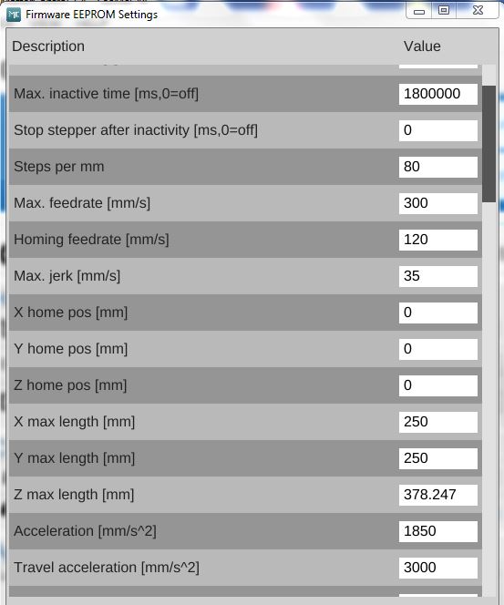

Your problem is classic binding. Your carriage is stalling. There are multiple reasons for this and I'd check in this order
1) jogging speed and acceleration too high. Lower these by 50% and test. What are your speeds and accelerations?
2) mechanical binding - X carriage not adjusted properly
3) stepper current too high
4) stepper current too low

Specifically you are talking about max feedrate and travel acceleration correct?mhackney wrote: 1) jogging speed and acceleration too high. Lower these by 50% and test. What are your speeds and accelerations?
Re: New Rostock Max V2 hot end crashing into x axis tower
Yes.
ok, lowered max feedrate to 150 and travel acceleration to 1500.  No problems on the initial travel to Z=0 like before.  Is it safe to leave these settings this way or is it going to be a limitation in the future?

If it were me I would find what was causing the initial problem. Slowing The speeds down is just masking the underlying problem. Sure, it's nice that that it is working at the moment but it would drive me nuts not knowing the why. It does look like a mechanical/binding problem.
							Orion to Cartesian     http://forum.seemecnc.com/viewtopic.php?f=59&t=7808" onclick="window.open(this.href);return false;
I agree with Holy1. There is no harm in going slow but try to find the root cause so you can increase your travel speed. Acceleration speed is not much of an issue. Do this:
start to increase travel speed but leave acceleration at the lower value. Do it in steps and creep up on the 300 mm/s in 25 mm/s increments. How high can you go?
