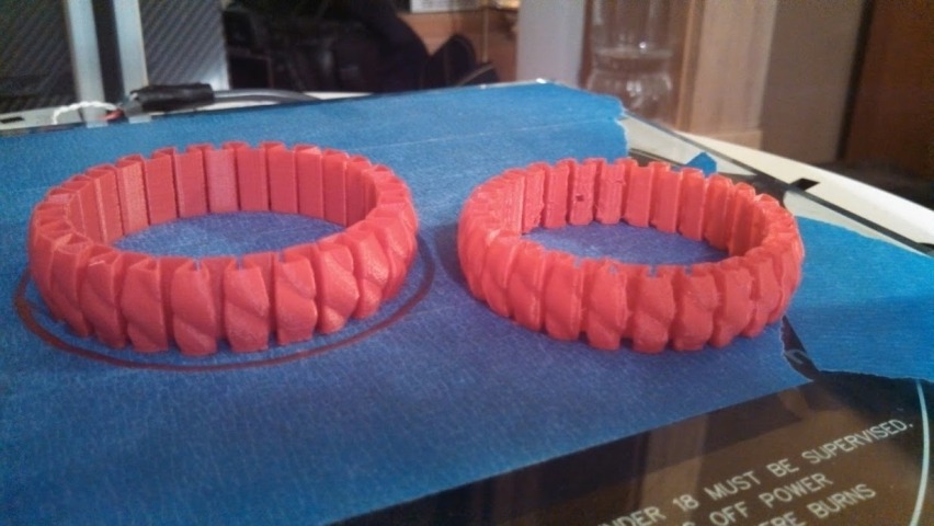

ok, I'm done printing that file and it looks great... Here are the 2 of them next to each other... The one on the right I sliced with Slic3r and the one on the left is from you... I'm clearly doing something wrong... Although, I'm fairly sure this wasn't done with Slic3r...
Tony

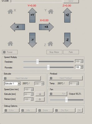

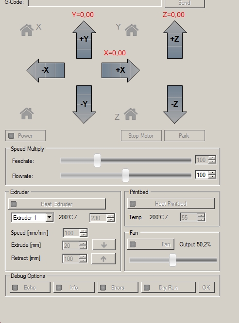

Hi g. Sorry, I didn't catch your question until now.geneb wrote:Poul, have you printed the calibration cube yet?
Thanks for your help with your documents.
Yes, I have done the calibration tube. It was thinner on the middle than in top and bottom. I had a lot of threads hanging between the towers.
And since then I have used many hours trying to figure out how to print simple things like a solid cube.
I have problem with the extruder feeding. The skirt loops 2 times before the filament comes out of the extruder. Then it will not attached to my blue painters tape. It is like the amount of filament coming out is too small.
I am absolutely shure that the extruder has a good grib on the filament.
And the solid layers are just small pieces of thread with a drop on the end.
I have tried to adjust the 2 sliders for Feedrate and Flowrate. It seems like the Flowrate should be 110 to 120 when the Flowrate is 50%. But the settings are not documented very well. And the Flowrate seems not to follow the speedrate.
Anybody knows these settings in detail?
/Poul
Re: Rostock max making objects....
I assume this is in Skeinforge?kometen wrote: I have tried to adjust the 2 sliders for Feedrate and Flowrate. It seems like the Flowrate should be 110 to 120 when the Flowrate is 50%. But the settings are not documented very well. And the Flowrate seems not to follow the speedrate.
/Poul
Basically all you care about is the ratio between them, for your purposes they should be set to the same value.
i.e. If you set Feedrate to 50 Flowrate should also be 50, this is the same as an extrusion multiplier of 1 in every other slicer.
The fact they are separate values dates back to when slicers used to be based on the measurement of output filament.

Hi,
No the sliders are in Repetier) Pls see attached screendump.
/Poul
