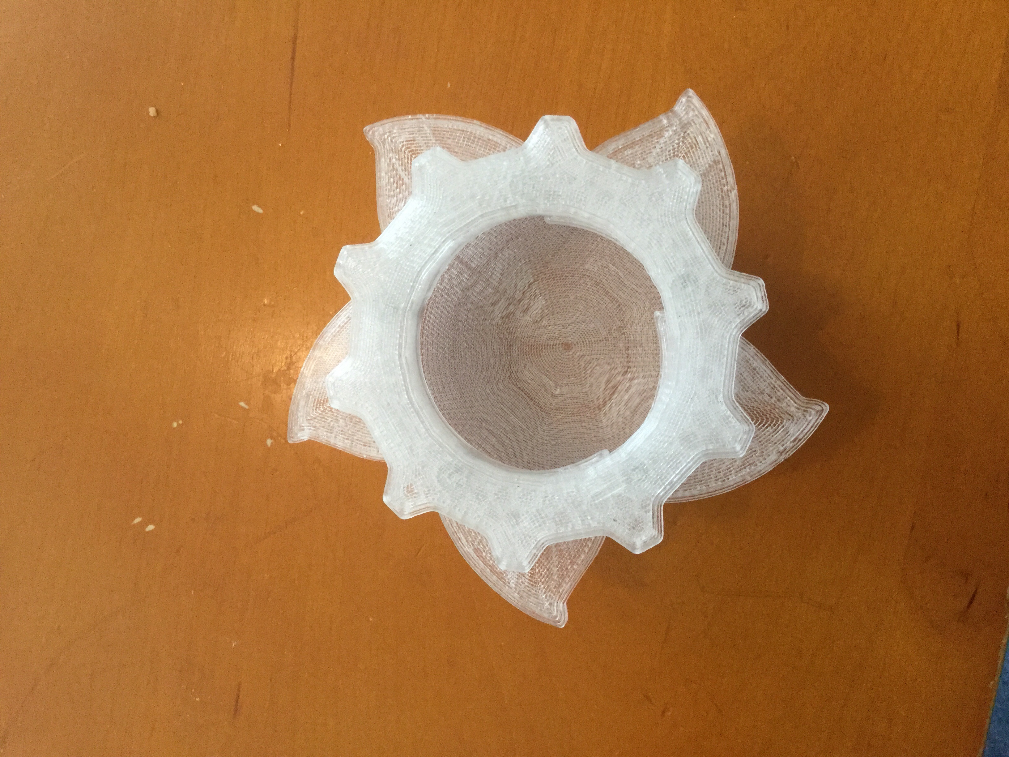

I bought a spool of Taulman n-vent... VERY Pleased. Here are the specifics...
Printing Environment and Pertinent Settings
- Rostock max, v2
- Tricklaser carbon fiber arms
- E3Dv6 (0.4mm nozzle) @ 260 C with no cooling fan blowing on the printed material
- Nozzle height adjustments done according to manufacturer's instructions using 24# copier paper
- Bed @ 50 C with one layer of Elmer's Disappearing Purple glue stick on the print area
- Control program: Repetier Host 1.6.1
- No raft
- Taulman n-vent, 1.75mm
- Retraction Distance: 9.0mm
- Retraction Speed: 65mm/sec
- Z-lift (during moves): 0.6mm
- Retract on layer change set to “On”
- Layer Height: 0.2 mm
- minimum move distance to initiate a retract: 1mm
I have previously printed only ABS.
* After every print, I heat the nozzle to 260 C and brush 4 sides with a fine steel wire brush. Since I began this cleaning procedure, I have had Zero problems with material buildup, “glopping” on the nozzle and subsequent deposition in unwanted places on my print (I had experienced the glopping prior to instituting this cleaning regimen).
Sticks extremely well to the bed- absolutely no warping or delamination, with the Disappearing Purple gluestick.
I am very pleased with n-vent. It's not ABS and it needs to be treated differently. From my perspective though, the advantages far outweigh the short cleaning required after each print.
- no glopping
- no warping
- no delamination
- very strong layer-to-layer adhesion
- hot end nozzle should be cleaned, according to Eastman's product info, as stated above. I clean after each print- takes 2 minutes.

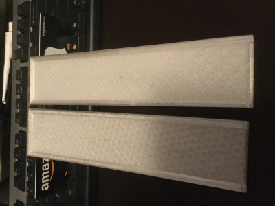

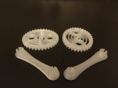

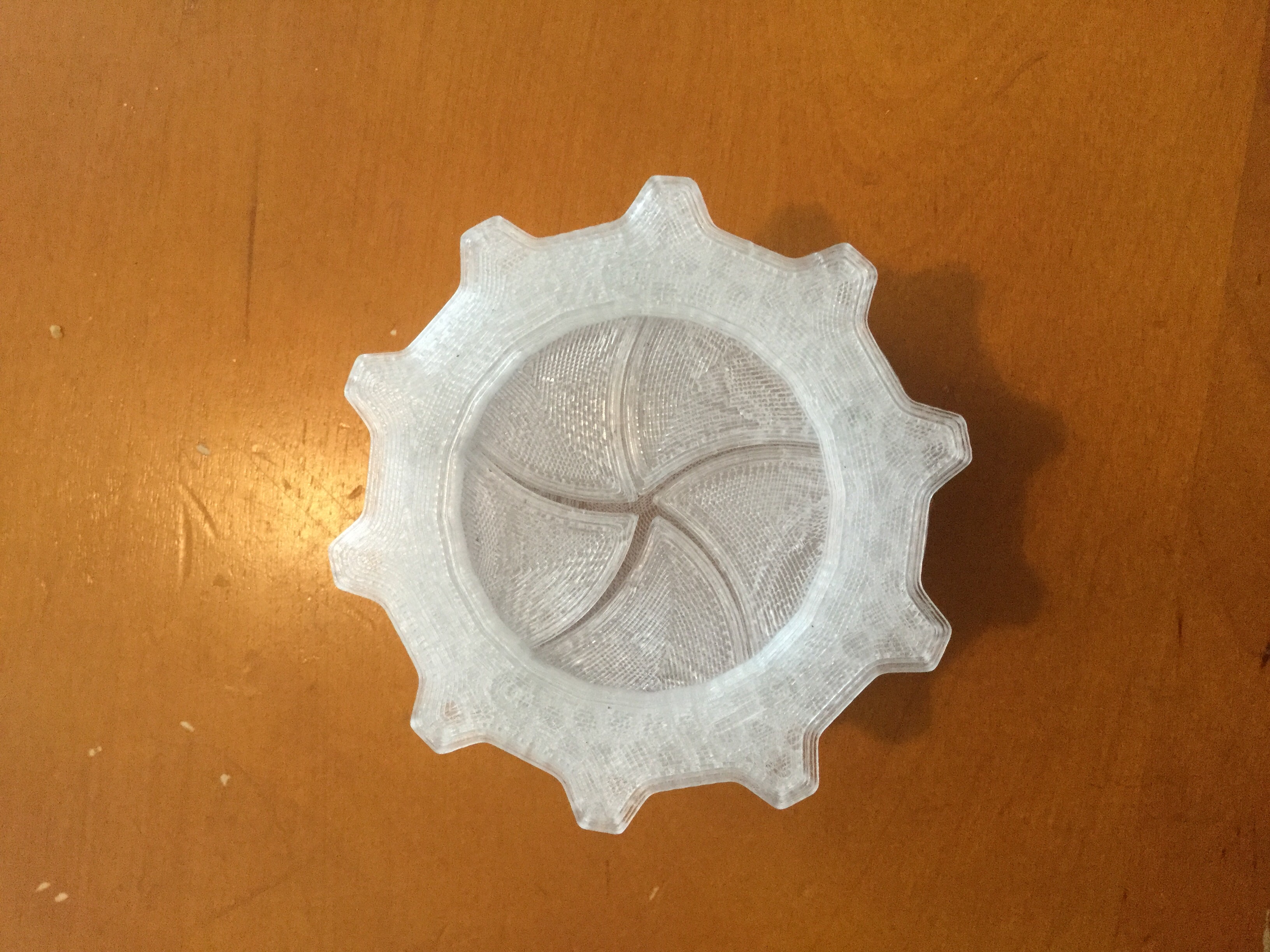

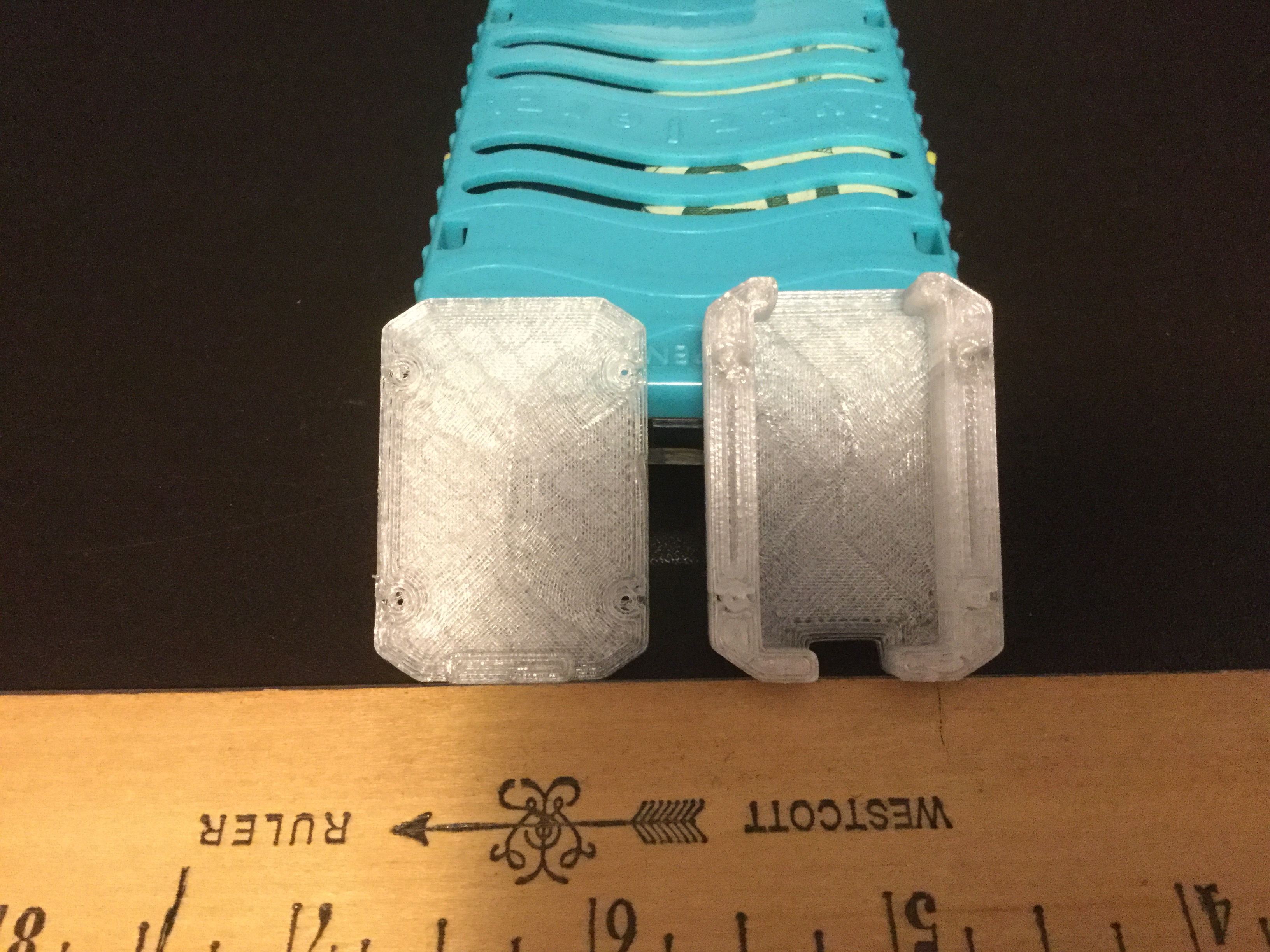

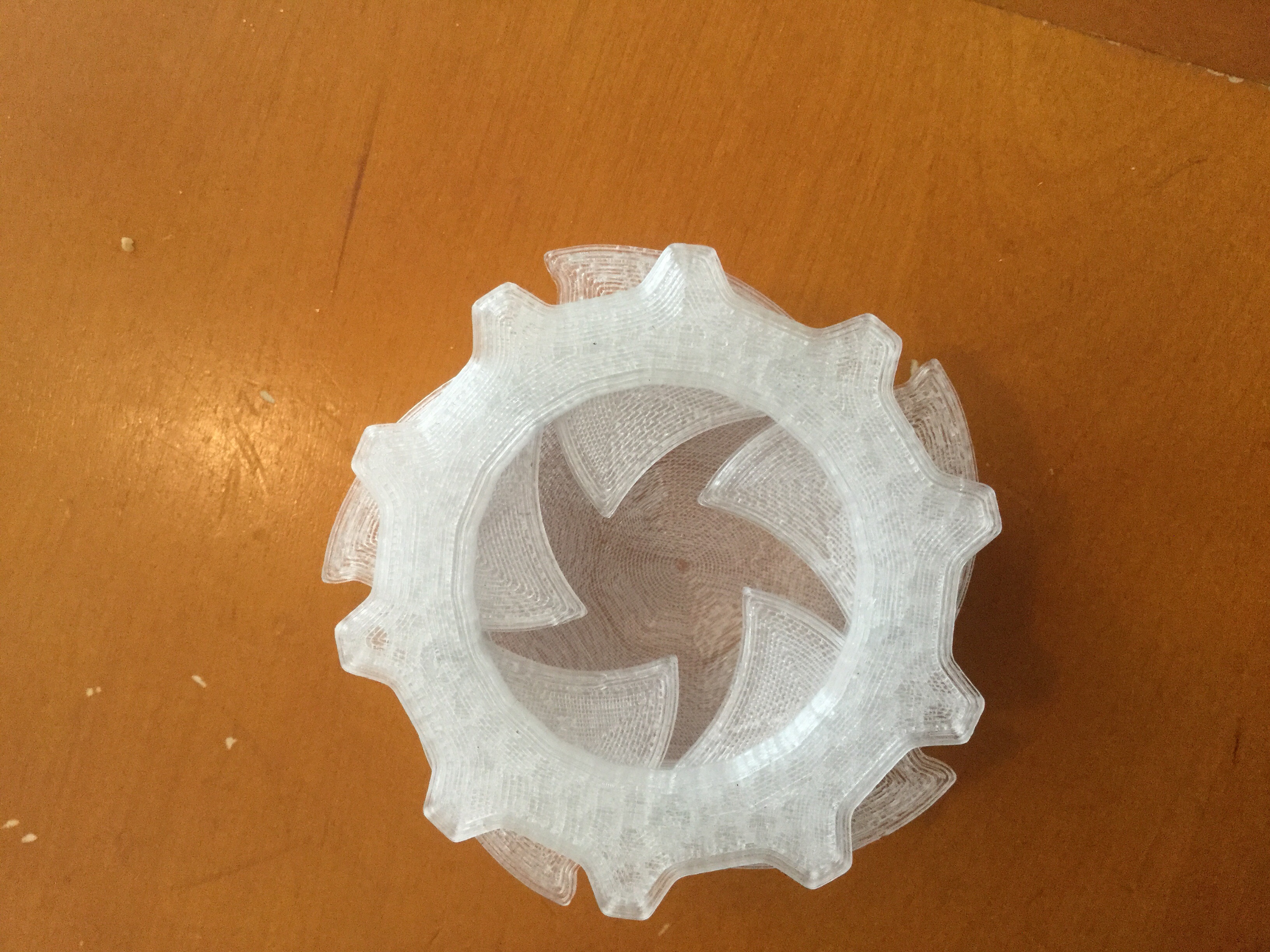

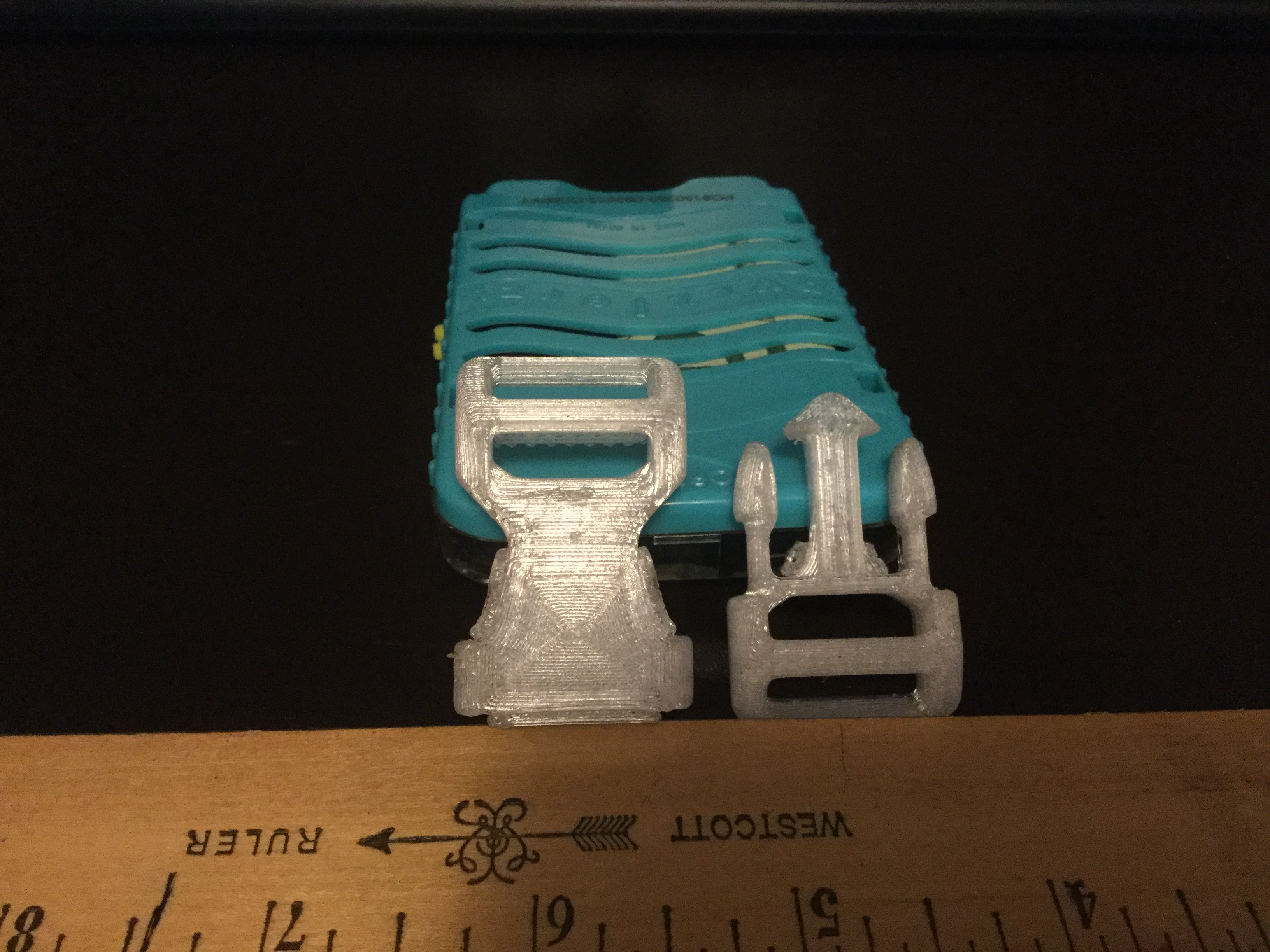

Pictures of a sample print?
Photos Added Per request: Taulman n-vent (Eastman Amphora)
Added a few photos of most recent prints.

Amazing material and very accurate prints as it seems. Can you show the iris box 'assembled' ? Did you design it or is this public available ?
Thanks for your reply - *John*
Re: Taulman n-vent (Eastman Amphora)... Reply to Johncoffee
First, sorry it has taken so long to reply. Can't provide a photo because my 2 YO granddaughter has sqiurreled it away somewhere.
It is a design from Thingiverse: http://www.thingiverse.com/thing:140048
It went together very well with little or no sanding.
