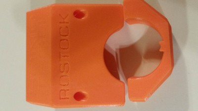

Well guys.... I dropped the all metal part:) I went ahead and bought a Bondtech. Thanks for helping me out. Is it silly buying parts for my printer makes me giddy? What do I need to mount it to my Rostock Max V2? I would like to have what I need when it shows up.

The Bondtech site has STL's to mount it to a Max, so you can print them yourself (I presume you did not buy the mount along with it, since you're asking). You probably will want heat set inserts as well, since the mount is designed for them. I believe many hobby and hardware shops should have them. You could also print out the basic fixture, and attach it inside the top deck, feeding through the little hole there, if you have a chamber. (I haven't got one of my own yet, because I'm a poor college student, but I've been planning out how to mount one when I get it)

I actually printed the mount and it came out great. I am going to Fastenal today to see if they have the brass inserts. I did find them at Mastercar. I am listing part numbers for others.....

Re: Options for Upgrading my Ezstruder?
Thanks for posting this information and I like the way the mount came out.
