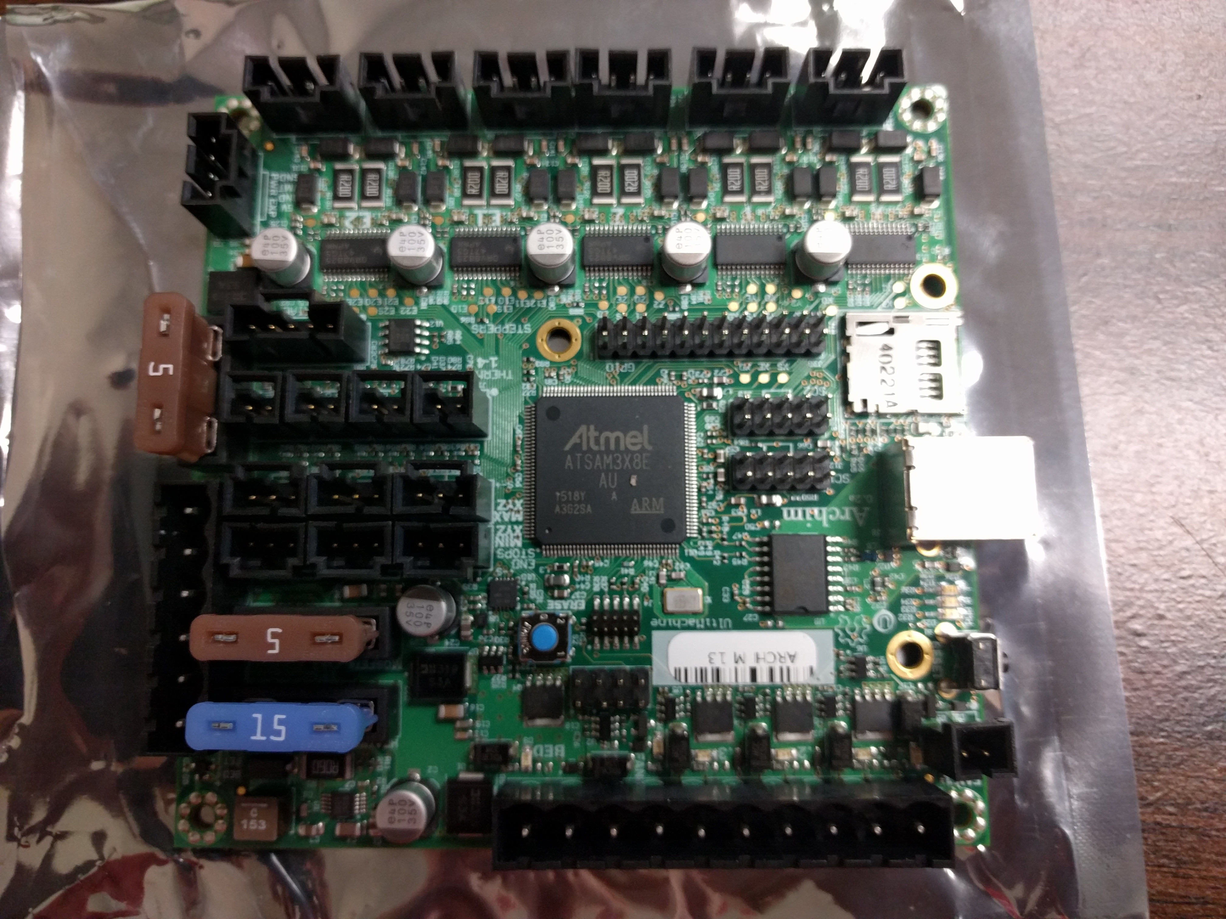

Re: Why isn't horizontal radius calibrated this way?
It's likely this...
Basically a RAMBo with an ARM chip...
Looks like Johnny's design work. Same connectors as the other Rambo's, etc. Very nice. Ethernet and SD are interesting. I like the automotive fuse holders, too. Looks like different silicon for the stepper drivers...
Which board is that, actually?
*edit* Now I can see that it says Ultimachine on it... Are you testing the new Rambo?
Yes, we got one for testing. I don't know what the name is. I've seen "Archim" - which is printed on the board - but it's unclear what the actual name will be.
- Posts: 446
- Location: Orange County, CA
Also, there isn't ethernet on this unit, and the drivers are DRV8825
