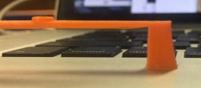

So, it's late and I'm kinda tired of working this out, so I thought I'd ask here for some help.
I've attached some pictures, but they don't show it very well since I couldn't get a good shot of it.
Basically, after a few layers the print evens out and stops shifting slightly to the X.
The easiest to see is in the bridge test:
thingiverse link
![IMG_0472.jpg (46.29 KiB) Viewed 9856 times one cube from retraction test](./download/file.php?id=14419&t=1&sid=3c8e96082c86a91c4349ca8e8c6ba5ef)
- one cube from retraction test
The towers angle in on all sides equally, yet it looks like it is straight up on one side.

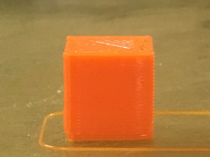

I lowered the bed temp to 35 and did a retraction cube test (couldn't find a single cube on my laptop for some reason).
![IMG_0473.jpg (85.98 KiB) Viewed 9856 times bridge test](./download/file.php?id=14420&t=1&sid=3c8e96082c86a91c4349ca8e8c6ba5ef)
- bridge test
This cube shows a wave in going back and forth actually.
(preview is swapping the images in preview, hopefully they are correct for real)
I've used many slicers and firmware versions, but it's been like this for a month now.
Rostock Max V2 w/ E3d V6
Hot end: 200-210
Bed: 35-65
Speed: 50-100mm/s
All give about the same results. So, I think it's missing steps or something. I've taken apart the machine a few times to try to check on the geared pullies on the motors and such, but it's not changed anything.

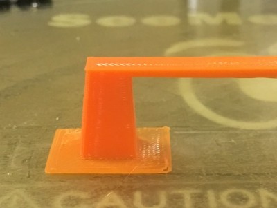

Heh, as I write this, I printed out a bridge test at 150% size and it's not nearly as bad looking. But it's really just the first 3 layers that shift in every print.
![IMG_0477.jpg (46.98 KiB) Viewed 9856 times 150% scaled bridge](./download/file.php?id=14421&t=1&sid=3c8e96082c86a91c4349ca8e8c6ba5ef)
- 150% scaled bridge
Anyway, if you've every had to deal with this, I'd love some tips.
