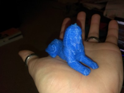

HA! I'm with you Gene, seems a bit funky to me! Just for the sake of furthering the topic though, I have managed to find 300-foot spools of Craftsman brand .065 in (1.651 mm) trimmer line at Sears for about 4 bucks and some change. At that rate, it's more expensive for a whole kilometer of the stuff, comparable to the size of a 1kg spool of our highly-prized filaments, but not by much.
http://www.sears.com/craftsman-065inch- ... 185604000P
It's twice as expensive online, but I remember walking out of the store, getting a chuckle out of the fact the the spool cost $4.20 :roll:
Here's something I printed with it, stock SeeMeCNC nozzle at about 235C if I recall.
It's a Sphinx!
It's a Sphinx!
