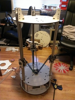

Got most of the mechanical assembly done. Now need to get started on the wiring.
Mechanical done
Mechanical done

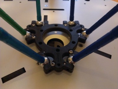

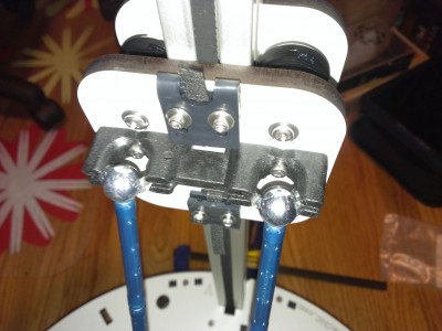

Like others here I'm working on a BerryBot-style magnetic ball joint system. I'm using GeoMag construction toys It's kind of a cludge now but once the printer is calibrated the first real print will be replacement carriages and print head platform with divots for precise ball placement. Working on a model now.
Carriage balls
Carriage balls
Platform balls
Platform balls
The rods aren't done yet, the ones in the pictures are the GeoMag toy rods that came with the set. Testing range of motion looks promising, and this is with shorter rods than stock so motion is a little greater than what it will be with correct length rods

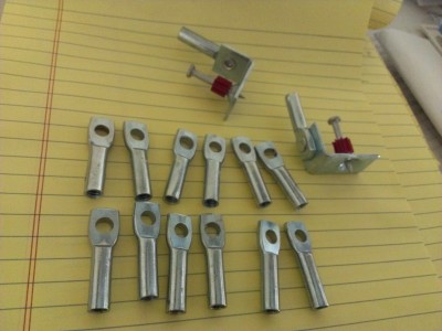

I'm also working on a tensioning sytem. I'm using these things I found at work.
Drilled out fasteners
I had to drill out the steel rivet to get what I want. I'll try them out when I get home and I'll post more pictures

by Flateric
LOL, good to see someone else trying for this too. The 15mm bearings fit perfect don't they?
Geomag, That's the name I could not think of.
I'm starting to think that having the bearings on the top edge of the build plateform in cup will produce a better end result because this allows for better range of movements.
I also encountered an odd overshoot behavior when trying to use the geomag ends. I'm curious how yours turn out.
I'm not sure of what your referring to when you say tensioning system. Or what the fasteners are for you show?

Flateric wrote:LOL, good to see someone else trying for this too. The 15mm bearings fit perfect don't they?
The GeoMag spheres are actually only 12.7mm in diameter, 0.5inches. I have them mounted to the outer extremes of the slot. They're currently held in place with hot glue for ease of removal later on. I read about your experiments with the magnetic toys, and was wondering if your prints did any better on slow speeds?
The fastener bits are for a belt tensioning system. Sorry for the vagueness.

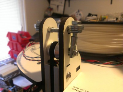

Here's what I'm trying out for tensioning.
Tensioner
Tensioner
I know it's not ideal as it requires quite long lengths of 6-32 screws. I'm thinking about drilling out the bearing spacers to something more substantial like 10-32.

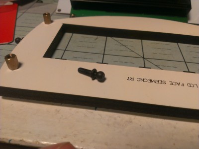

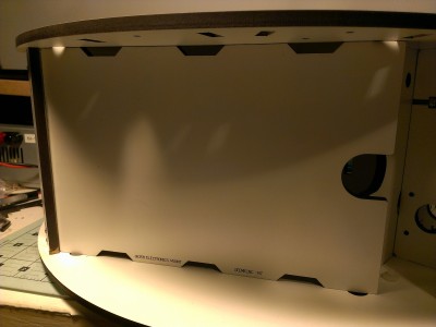

So i was finishing up the build and got to the electronics. I decided to mount the LCD somewhat unconventionally since i couldnt figure out how to install the angled mounts and the faceplate.
I found some RC car parts and some brass PC board standoffs from my PC building days.
Standoffs and ball stud
The ball studs were installed into holes that were drilled into the side of the faceplate. Mating ball sockets were installed in the door. And a big shiny knob from RatShack was installed on the clicky shaft.
Radioshack knob
Radioshack knob
Lcd mounted
Lcd mounted

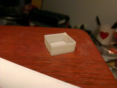

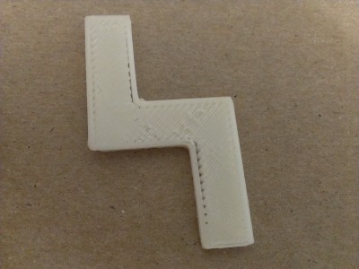

Finally, it was time to level out the axes and try a print:
First print
First print
As you can see the infill doesn't quite touch the perimeter. Not sure what it is because the infill looks like it's the perimeter that's getting too wide. Infill looks to be where it's supposed to be. I have to double check my extrusion settings. I'm still fumbling through the software right now but that part was sliced with kisslicer with mhackney's settings. Printed with abs at 235c. Seemed to need that much heat to get decent flow. I'll cross check the temps with my thermocouple. I was a little worried about burning th house down when i first fired up the rostock but so far so good!

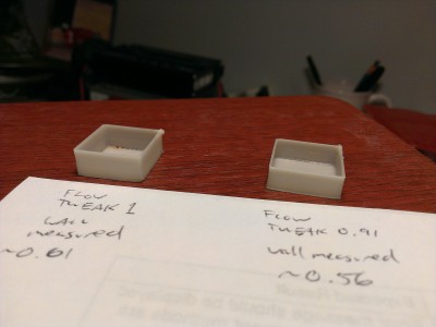

Printed out a hollow single wall cube next.
2nd print, single wall
Turned out pretry good. Wall thickness measured a little thick at 0.61mm so I adjusted the flow tweak in Kisslicer. Also the 20mm sides measured a little shy at 19.6mm so i also adjusted the arm length in firmware.
Third print, adjusted extrusion width
Third print measured a little better
