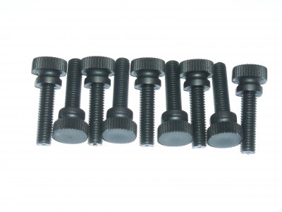

2) The image for the "(9) 10-32 x 3/4" Knurled Nylon Thumb Screws" is wrong. Here's one I took:

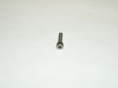

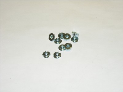

4) There are two items in HP1 that aren't in the Visual BOM at all:
a) (10) 4-40 Blind T-nut (zinc plate); for belt clamping and RAMBo mounting
b) (1) 10-32 x 5/8" stainless steel socket head screw, to tap holes for 10-32 nylon thumb screws
