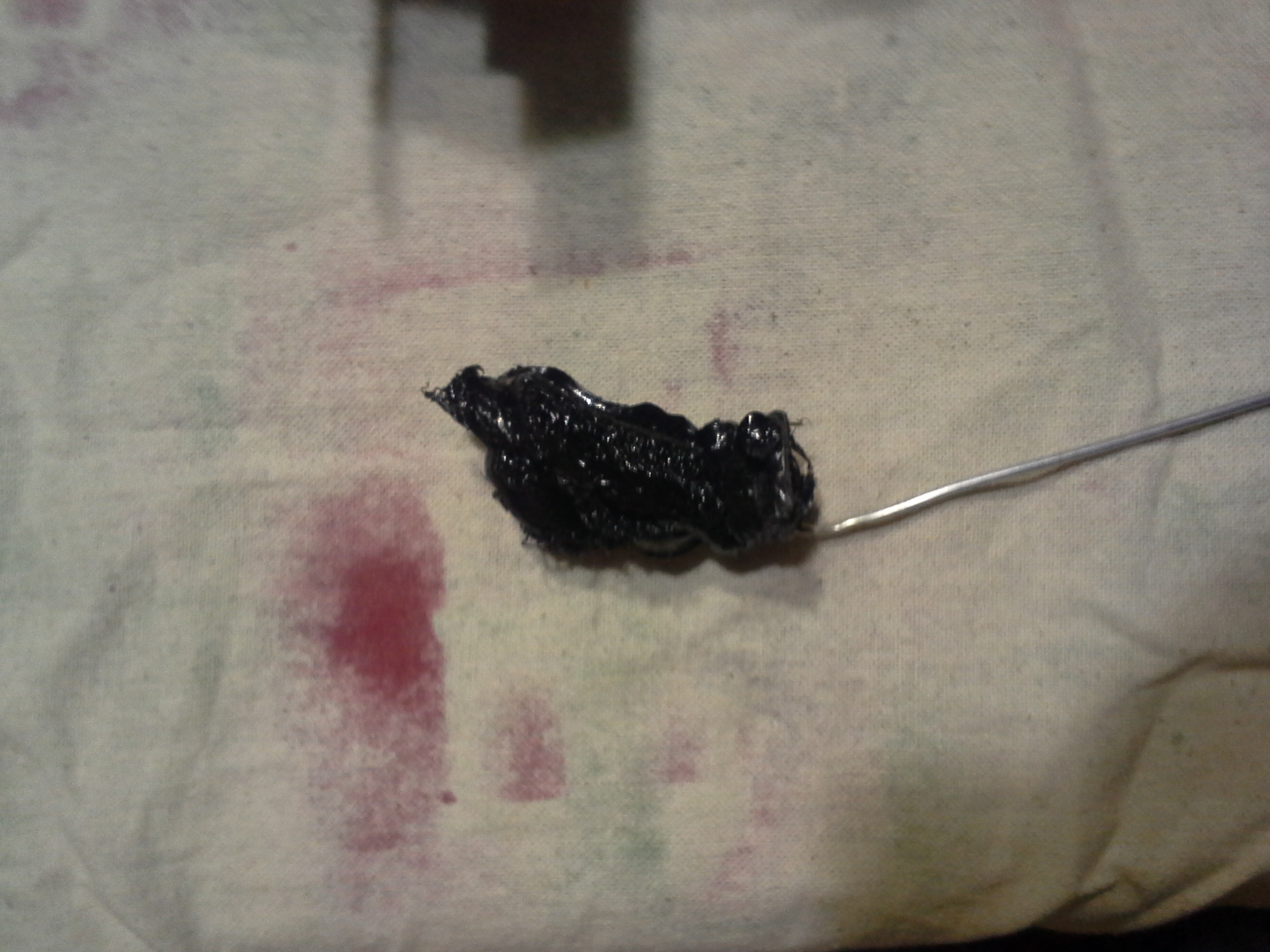

So, I was on the fence about the V2, but today settled the question. Unfortunately, that happened because my Berd-Air dropped down into the part (Second time it's happened, but I changed the mount and added superglue between those events), causing it to come up and fail while I was in class. Not a problem so much with the Berd air, but more of with mounting it. That caused it to get stuck in a large clump of ABS.
I though, No problem, I'll just cut that down some and soak it in acetone. Well, I didn't do too great there, because I managed to nick the edge of the tubing inside the hunk (Didn't even notice it).
I just wish I had gotten the V2 at MRRF, since I was just there, and could have avoided the downtime on the Berd-Air.
I definitely am going to epoxy a trio of little lugs onto it to hold it in place (Positive retention on both sides for two positions, Volcano and V6) when I get the next one set up, and I'm not questioning my getting a new one in the slightest. It is a lovely bit of kit, and I love the idea.

That surely is one big clump of ABS surrounding your berdair pipe.

one of the ways to release super glue is to heat it do you think that might have been a pert of the problem?I was not happy with my own installation of the BerdAirI had clipped it into the stock layer fan shroud to hold it but it was snagging filament threads so I have removed it for now until I design or "borrow" a better way of attaching it.
