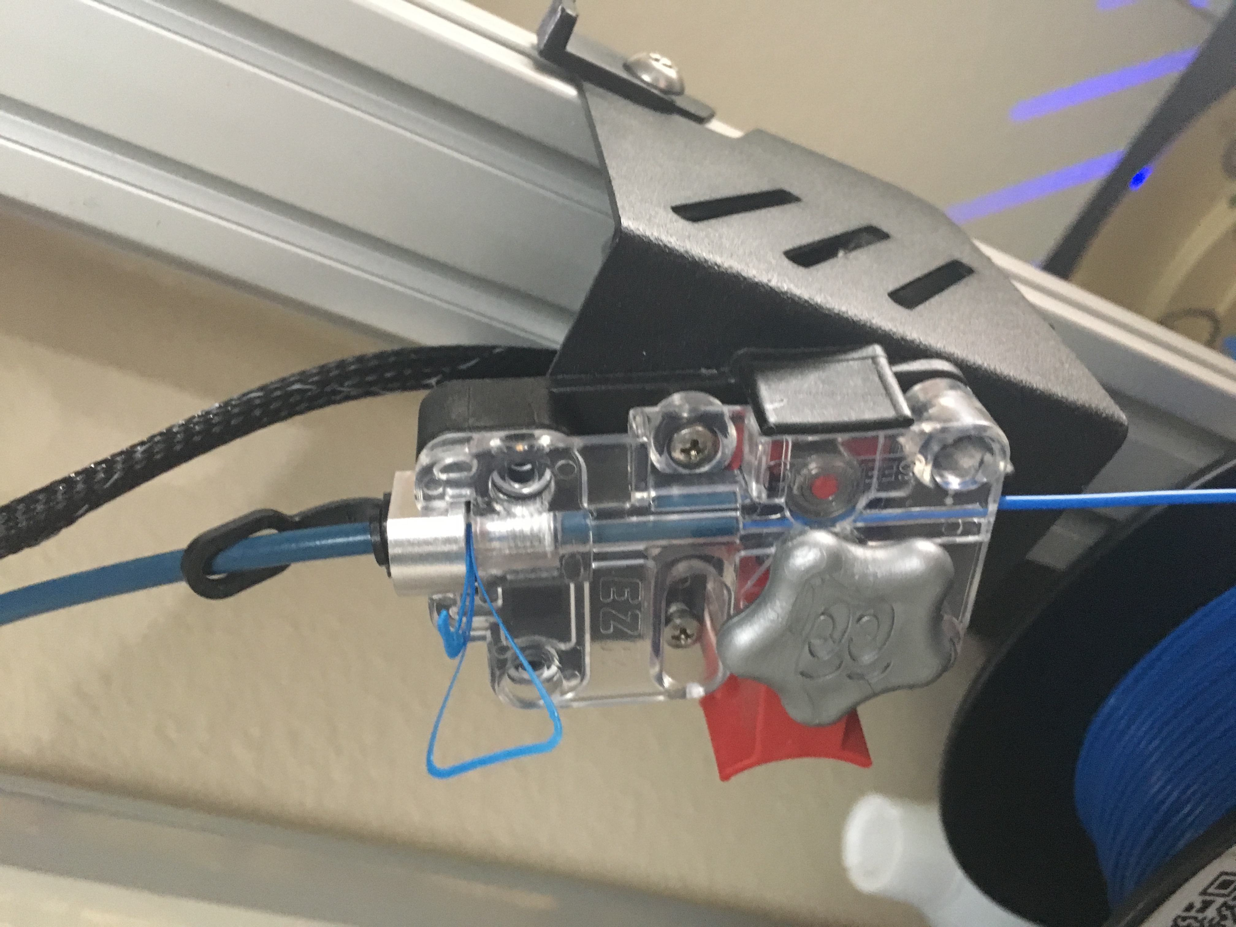

I bet the root cause is the bowden tube not being fully seated in the extruder. If it's moving as much as you say, it's robbing part or all of the travel of the retract.
Also check to make sure the bowden isn't moving at the hot end-end.

Bowden is firmly inside the extruder and hotend as much as possible. I spent a good deal of time trying to verify the bowden was seated all the way in the hot end--to the best of my ability, it is/was. It was kinked a bit at the start, but not any more.

After swapping out the eztruder end piece and clamping it, the thermistor, and swapping out the short ptfe tube in the hot end that was kinked, I didn't have any strings on the cubes. Still strings on the cylinders though... I'll look into getting a low heat heat gun (cheap travel hair drier maybe?) for when I do get strings.
If you look at my previous picture of the eztruder, you'll notice there are no screws in the top part. Does anyone else have those? I believe those need to be filled and tight to avoid that metal end piece room to move. Gene, thanks for sending a new one, it is tighter than the old one, so not a waste.

Currently have the machine offline again. Was able to squeeze out some prints for the the FB group Eiffel Tower project though.
The parts had some pretty bad ringing in them, so I plucked the belts and they were so loose I could barely hear a low rubbery sound when I should have heard a twang of some sort.
Thought I'd adjust them afterwards. Good idea because I basically put the printer out of commission because I just don't have time to clear space to turn it apart again to find out how I should have done it instead of how I tried.
The bottom pulleys looked like the ideal place to adjust tension to me--just loosen and push down a little till the belts twang the same, then retighten. Nope, there is some hidden peg that keeps them loosely in place below the rails. No ability to move it down. I ended up unbolting it to see if I could pull the sucker off and lost the t-nut inside the tower. Patience with this machine really is trying sometimes.
It's easy to tension the belt, simply lower the belt pulley just below the linear rail; loosen both bolts and press down, then tighten. The bolts are held into place with T-Nuts that can sometimes get wedged in place and thus have to be pressed free. Assure that the little post in the middle of the belt is centered and not causing friction. I would not super-super-tighten the belt. The only objective is to assure that the belt is adequately keyed into the gear.
Even if the free side of the belt osselates a bit (during a fast move like a home) I find that the belt remains firmly seated in the timing pulley. It would take a goodly amount of force to make the belt skip out of the pulley. I actually tested the holding power of the belts in the gears...
As to the Artemis, I am not seeing much to maintain, change, or tune.
The only changes I have made so far; capricorn tubing and a geared extruder (titan). Both those changes were made, not by necessity but, only because I had the items in stock. There is other hardware things I would like to try; I am starting to maintain my Rostock Max V2 first. I put in a new heater cartridge and rewired the hot end, the belts are getting a bit long in the tooth. These machines can run for 100's-1000's hours..
The only hardware-maintenance I have done is to clean the rails with a qtip, clean the ball joints, remove dirt which accumulated on the grease, and then lightly re-grease. I am nearing the endpoint of slicer tuning. I am getting good PLA prints, and as of today good PETG prints. PETG is beyond my expectation.

There's nothing keeping the belt turn-around from being pushed down. The only thing keeping it in place are the 1/4-20 screws and the backing t-nuts.

My eyes were playing with me then. There is a hole under the pulley and when I tried pushing the fully loosened injection molded piece down, it would just pivot over the hole--I guess I'm just not as strong as I thought I was. I'll need a tensioning bolt or something.

Chances are pretty high you'll just break something if you force it. You should be able to tension the belt well enough by hand strength alone.

Got the pulley back on--was a lot easier than I initially feared now that I looked at the printer in proper light. I concede I was much too hasty before on dissing the belt tensioning. Though, I am a bit frustrated with not getting much out of this machine--the most expensive machine I've every bought for myself--so please excuse me some impatience as it's been >4 months since I got the machine.
I did a small print and it was "OK", bed still doesn't calibrate great so the first layer sometimes screws up bad if there is any retraction/zhop in it. The nozzle just picks up all the adjacent filament that has already been laid down and carries it around til I cancel it. Cleaning the outside of the nozzle didn't seem to help, its just so darn attractive to filament that has already been stuck to the bed.
I figured, there was a new firmware update for dc42 with the multi-tap from SeeMeCnC, that I'd install that. Seemed to go without a hitch yet when I did my first print (multi-tap set to 4 got a really nice consistent calibration value), the machine let out a crazy whine and printed way up in the air.
I threw my hands up and got the latest Artemis FSR SD folder from git to downgrade and bah, I can't downgrade from 1.21 as easily as I hoped. I'll figure it out, there are FAQs and such on this problem, but I'm outa time for fiddling with this guy for the weekend. I hope someday soon I can "waste electricity" and have prints going while at work like I use to with my V2.
