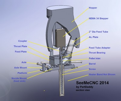

I put files on our SeeMeCNC Github for the PartDaddy.
Here's the pellet extruder I designed. Oly & I went round & round with details on the hot end.
PartDaddys SMPE
PartDaddys SMPE
Some spacers might be missing. We didn't draw any because it was just easier to make them on the fly. I gotta say, this whole project was a lot of fun and not possible without everybody at SeeMeCNC pitching in. JJ did a lot of work on mounting limit switches, arms, and for CAD he took my sketched work and turned it into something, which I took and mashed into the design of the final machine. Guanu did the electronics and helped dial-in the final setup. And everyone else had something to do with building this thing. Look for occasional posts on facebook or twitter.

Cost. I bought less than $6000 in stuff. And probably another $6000 in machining, assembly, setup, and wouldn't sell one for less than $50,000 USD. I do not plan on producing these at this time. If you're handy in the machine shop, down the files and start making one! I design in Solidworks, and those files will also be on Github.
Most parts are made out of aluminum. Standard inch size t-slot. The screw for the pellet extruder is steel. I typically use standard hardware, like 1/4-20 and 3/8-16 sizes. I like stainless nylon lock nuts with stainless hardware, unless I want extra strength from an alloy fastener. In which case, I'll choose a zinc plated steel fastener. The clearance hole sizes will give you the size of bolts I used. Depending on the project, I don't spend time putting in bolts. Other standard hardware, like pulleys and bearings are not in my files. They're standard items, like L series timing belt, 608 bearings, and the rubber feet.
Electronics wise: The RAMBo board is the heart of the control. There is not a more reliable control board on the market. We broke out the step, direction, and enable pins to large stepper amplifiers. You can find 4 axis NEMA 34 stepper kits on eBay, just search. You can buy them complete with power supply. I'm using a 72VDC supply to power all four NEMA 34 steppers. Of course, 120VAC circuit have fuse protection. The linear output force I'm getting is about 80 pounds. The capacitive sensor on the hopper switches a solid state relay to turn on a small vacuum to load pellets. And the 700 W of 120VAC heater bands are also switched by a solid state relay.
I chose a Microsoft Surface Pro2 tablet computer. It works great. Just put it in airplane mode before running the machine. (Or is might update in the middle of your print. Kinda like your buddy playing a bad joke on you.)

Posted: Mon Oct 13, 2014 11:17 am
by PartDaddy
@Generic Default
1. My objective is to print a large part in about the same time you print a little part. The sacrifice is resolution. So my 1.5mm layer thickness gets the print done quickly (for it's size). Repeatability is pretty good. The platform moves up and down diagonally 5 feet and can hit the same z height within +/-.005". Rigidity is not real good, but that isn't a huge problem. I'll post more print pics. In the mean time, look up our twitter and facebook for pics.
2. Acceleration isn't too bad. Yep, it's slower. Takes an inch or two to get to full speed. I print PLA 30 to 35 mm/sec. Rapid is 200mm/s. It can go faster, but rigidity is low. So I opt for better accuracy. The whole hot end assembly, arms, etc. weighs about 90 pounds. I have free weights for counter balancing this. For off-center moves, inverting another set of arms upward with another hot end mass would make the nozzle almost weightless during those off-center moves. Right now, the 80 pounds of the steppers carrys the weight when the end-effector moves off-center. So acceleration has to take into account the forces involved during a rapid move off-center.
3. Arms = TSlot extrusion because we have a lot of it. They work great and are plenty rigid to do the job well. Carbon fiber would be my preference.
4. PLA is all I care to print with. It doesn't really shrink. Now, some filament manufacturers probably put a petroleum base colorant in their filaments. It's cheaper. The problem is that the petroleum base colorant shrinks, which = warping. My extruder design can extrude high temp. I've had it sit at 280C for a while. Doesn't matter. There's isn't teflon or linear. Just a smooth steel bore. HDPE and PP extrude well. A change might be needed to the screw and hot end to make it work right. We machined deeper grooves for the pellets for PLA because it's sticky and needed more input to feed better. While petroleum based plastics seemed to feed easier because they don't seem to act as sticky as PLA when melting. Haven't tried it, but a thermoplastic urethane elastomer (ninja flex like stuff) would probably extrude well. Nylon too. Your problem will be shrink, and will prevent you from using it. Like Taulman filaments, these exotic materials need to be a co-polymer blend to work. Just my opinion here. Shrink is a problem on this scale of printing. Even glass filled nylon shrinks too much, about 0.007 inch / inch. With glass filled nylon you'll shrink almost 3/16" over a 24" cross section. PLA is the magic stuff that allows it to work. If PLA didn't exist, I wouldn't have even bothered to make this machine.
