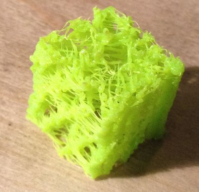

First Full Print
Re: JT's H-1 build log and mods
Posted: Tue May 08, 2012 10:59 pm
by JTCUSTOMS
Wow! I didnt know these things can make astro turf!
Posted: Wed May 09, 2012 10:55 am
by ALeander
It certainly isn't the solid cube I was looking for.
The dimensions were just about right though.
