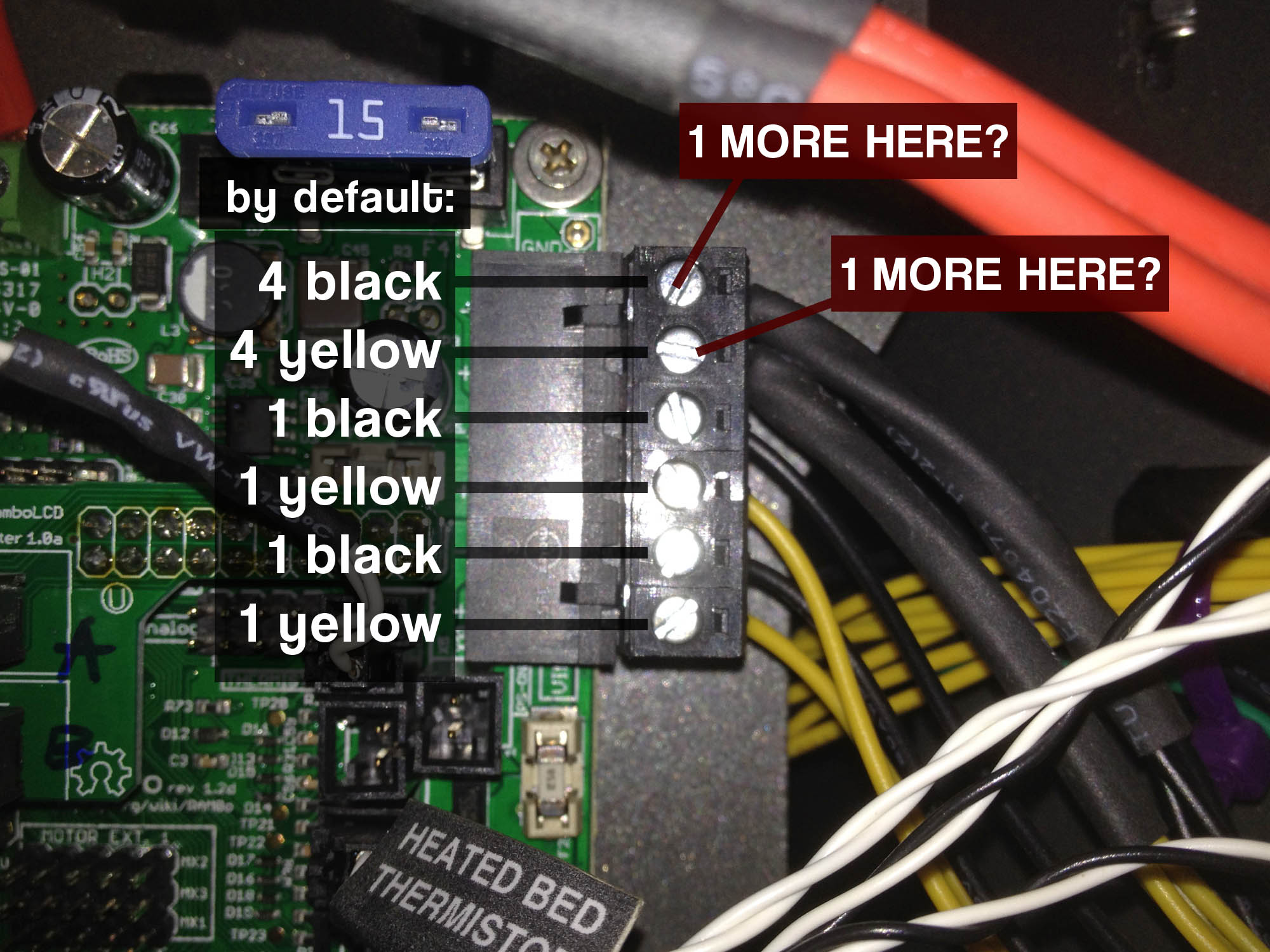

ZionPhil wrote:It's an issue of current. Solder an extra wire onto the wire going into the Rambo and the one going to the bed. Recommended by John Oly. I have done 3 wires from Rambo to Bed. Went from only being able to get up to 85 degrees to being able to get to 125 degrees and heating up much faster.
Also don't use a pot holder...you a pot LID! A glass pot lid with the approximately circumference of the actually bed works beautifully.
First of all, excuse my english :D

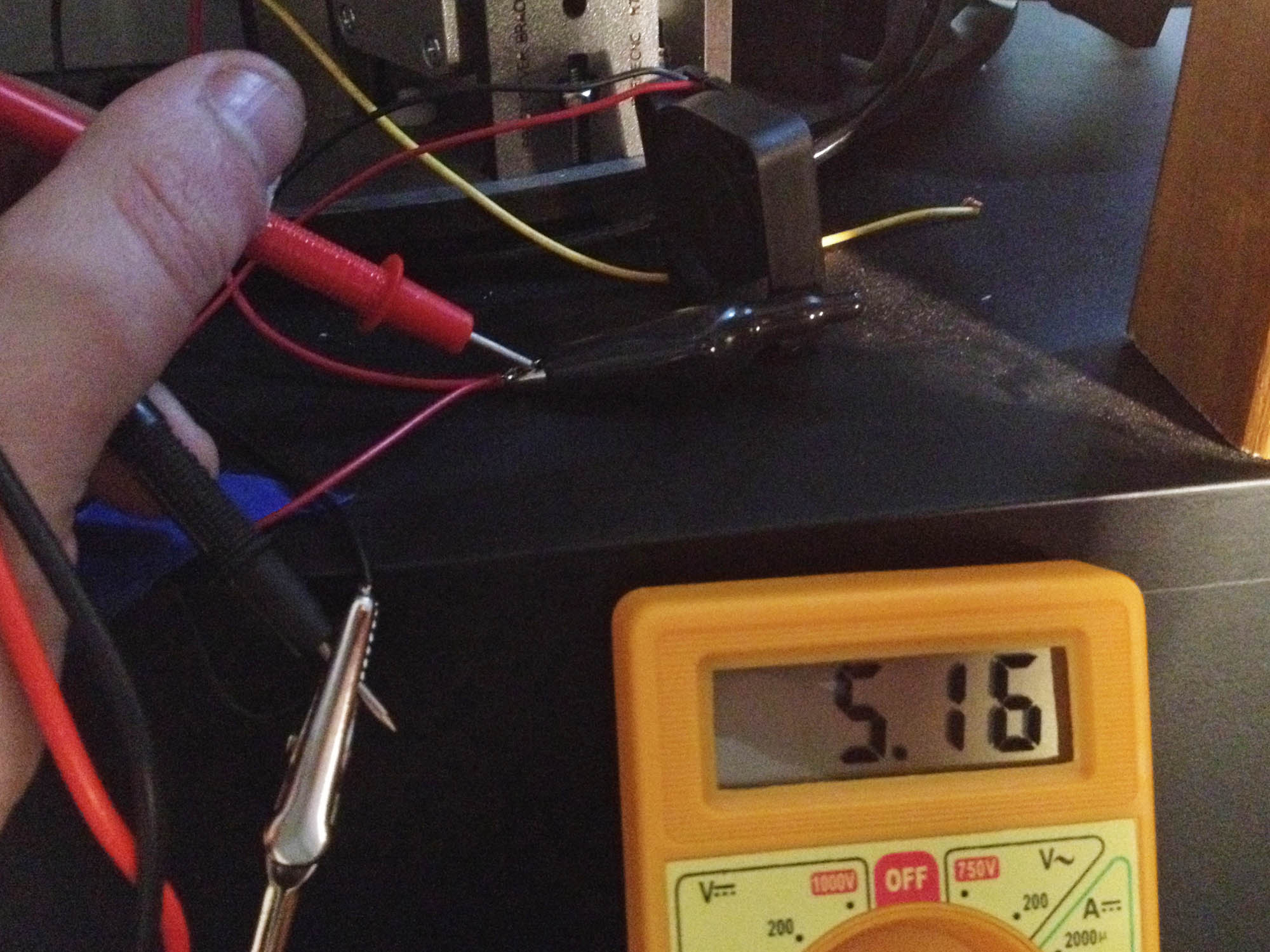

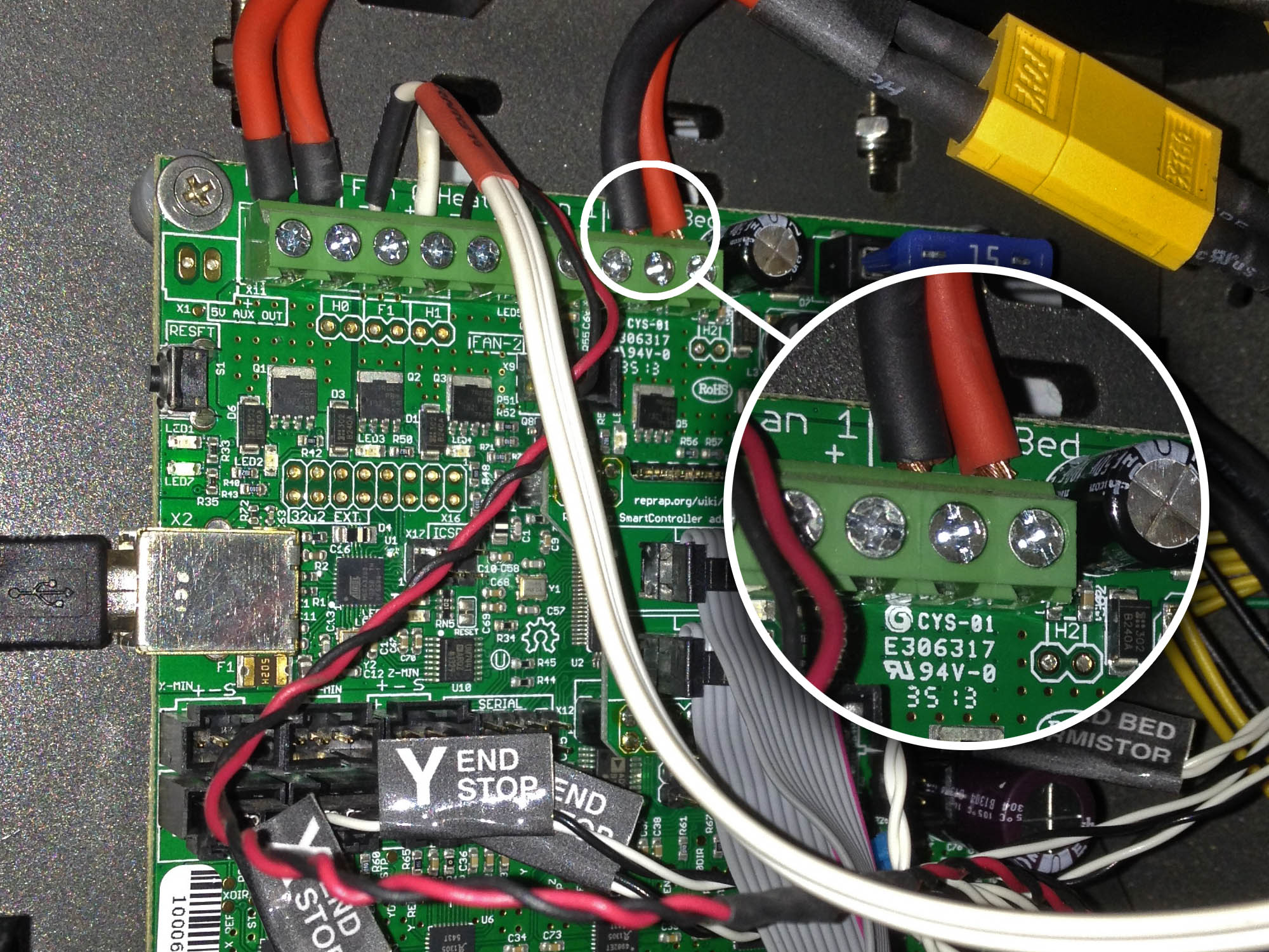

Im having troubles with my bed also. But I've Rev2.
It takes 20 min to get to 90Âșc and can't reach 110 even after an hour.
So I tested the output current from Rambo to the Bed:
It should say 12v right? So the solution is to add 1 more black and yellow wire?
The wire from Rambo to the bed is a 2,5mm silicone wire, so I think theres no need there to add another.
Thanks, Martin

Martin,
Looks like you are testing directly from the Rambo output with no load being applied. In this case the voltage should reflect very little if any drop due to conductor size. My opinion which is sometimes correct, is that the voltage should be floating high to match the output potential of the power supply. Is the power supply voltage generally low? Or said another way what is the voltage when measured at the Rambo Heated Bed inputs, the place where propose to place the additional two wires? What are the two measured voltages when the Hot End and all other external devices are switched off.
By the way I really like your wiring, connectors and labeling.

Hi thanks for your reply. Lets see if I got it right.
So what you say its that I should meassure the voltage directly from the plate?
Hot end and peek fan OFF:
Bed: 9.76 volts
Hot end and peek fan ON.
Bed: 9.56 volts.
Thanks.
Martin

I think that your measured voltage shows a serious voltage loss and is reducing the wattage available to the bed. I also have a Rev.2 bed and performing the same voltage test from a cold start, which is the worst case, the measured voltage is 11.55VDC. As the bed heats the resistance increases and the voltage will rise but the heating rate will also slow.
Timing my bed without the copper heat spreader plate, it has taken 4+ minutes to reach 75C and 6+ minutes to reach 90C. At 85C the voltage across the terminals had risen to 11.62VDC. Replacing the heat spreader will cause the bed to heat slower due to the greatly increased thermal mass but it still takes about 9-10 minutes.
The wire you are using, 2.5mm, is between a #14 and a #12AWG so I do not think that this should be an issue (I use a #14AWG) but I think that the 2.5VDC+ voltage loss is. Suggest that you follow the voltage back to the supply and try to isolate where the drop occurs. If it goes all the way back to the supply, it may just be overtaxed.
There have also been discussions regarding some brands of power supplies than have difficulty in supplying full a 12VDC output unless the +5VDC rail has some load applied to it. I have no first hand experience but this has been discussed by people whose opinion I respect. An easy way to check this would be to hookup a PC disk drive to one of the spare output cables and apply that load across the +5VDC rail, measure the voltage and see if it helps.
nitewatchman

Hello again :D
I've connected a fan to the 5VDC output, and it seems to be working good:
When Hotend, bed and peek fan are on, the voltage increases a little bit.
Then I tested the bed here, with everything turned on:
result: 9.8 (an average really, it changes from 9,7 to 9,9 overtime)
Will this help?? I don't want to buy another PSU
My knowledge of electronics is very low, so I'm scared to burn something up by doing this. If someone can confirm this wiring change it would be really appreciated.

The output pins will read less than 12V even with the best PSU in the world, the MOSFET circuit is not 100% efficient and depending on EEPROM settings, you might be measuring a none cconstant output.
The place to measure for PSU droop is on the input pins to the RAMBO, with the Hotend and bed heating, it will probably drop some but you should be within spitting distance of 12V.

Adding the wires from the Power Supply where you so in your photo is correct to increase the ampacity of the Heated Bed circuit.
Your proposed wiring change can certainly do no harm. Adding the extra wires at the location you show will increase the wire cross section in the supply circuit to the bed and lower the total resistance therefore lowering the voltage loss. If you already have three or four 12VDC wires connected there however, the resistance is likely already pretty low and you may not see much change. But it is worth a shot.
As long as you match colors and polarity you should be fine and there is no down side. Just be sure to check the selected wires to be sure that the voltage is correct and that the color and sign (+/-)of the measured voltage of the wire you are adding matches the original wires.
