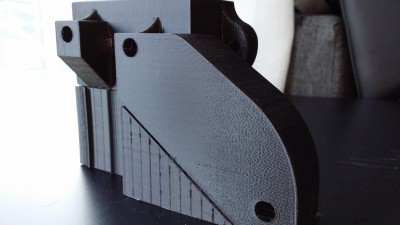

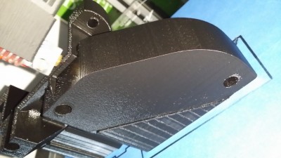

I tried the speed/temperature method on a print last night. In Cura, it was set for 30mm/s speed, 60% infill, 0.1 layer height with supports and would take 24hours. Once it got the bottom layer (20mm/s) down, I ramped up the speed using the LCD to 185% (55.5mm/s), and adjusted the temp to 230C and was using black PLA. With the stock hot end, I can run this black at about 190-195C, so 230C was putting it up there. The print ended up taking about 13hrs.
This ended up not only working for the entire duration of the print with no starving of filament observed anywhere, but it also never plugged due to retracts (another problem I've had), and it produced some of the smoothest walls I have seen on my prints to date.

I think the temperature could have come down as there was some decent blobbing on a portion of the backside of the supports, but it was just on the supports, so who cares. I thought the supports were going to be murder to remove due to the high temp of the PLA, but it snapped off nice and easy. Very surprised.
I'm very much liking the news regarding the drilling of the nozzle by mhackney. It would be nice to hear that it might allow printing at regular settings. While printing this time at high speeds was awesome and may work great on prints with a large layer surface area, small prints would stay too hot and sag without some serious cooling.

Well so far so good today. As I ramped the speed up to >50 mm/s I did have to bump the temp up to 190°C but that is typical with other hot ends. I am still guardedly optimistic about this insight. I'm looking forward to hearing from E3D-systems and printing many, many more parts successfully.
That is a great looking and large party Tinyhead. It is good feedback to see that ramping the temp up to an extreme setting also worked for you too. I do still think that the nozzle might not have as good heat transfer as other hot ends since 1) the tip is not tightened against the heater block, a gap is prescribed to allow tightening the nozzle to the heat break, 2) the back end of the nozzle is tightened against less thermally conducting SS heat break and 3) the primary heat transfer path is through the threaded section and there is not that much surface area/threads to conduct the heat. I think this combined with the long bore result in two parameters that play against each other.
